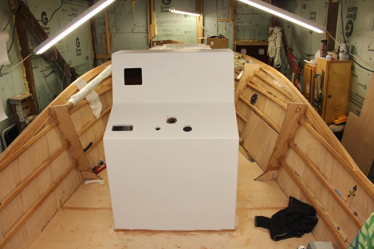

  7. Fishman, Graham had a console drawn on my plans. I scaled the measurements off the plans, added a front seat and sloped the dash. Pretty good fit. I ordered my leaning post from Birdsall marine. They have many designs and I ordered one to fit my boat. They also made me a custom T Top which folds to fit in my barn. I sent them a drawing of my console, they built a mock up of it and built the T Top to fit it. Shipping was expensive as I live far from the coast. It had to be shipped upright as it is welded and sized to the console. I consider the T Top a necessity. I also got a wrap around wind screen that encloses the console. Some call them a phone booth. Wind and weather protection. The console will be the same color as the hull. They also made me matching cushions for the forward seat and leaning post. Very nice and expensive. You can get cheaper T Tops which are shipped in a box and you assemble them and can be adjusted to fit most consoles. Check out Stryker T Tops, also Jamestown distributors carries some that can be shipped. Can't remember the names of them. Some are aluminum and some stainless steel.
  8. A little progress. The console is 5/8 thick. I ran low on the 1/2 ply, so laminated a layer of 3/8 and 1/4. Nice and beefy. I have hatches for the console, but left the front seat back unglued for access to wire and run cables. I believe i'll glue the lower half after wiring is complete and just screw on the top of the seat back on so I can really get in the console later for any work. After I install the hatches, i'll see how easy access is to everything. If it is all accessible thru the hatches i'll glue up the upper section of the seat back. Trying to get ready for engine install. Coming in next week or two.

  11. Initial console construction.
