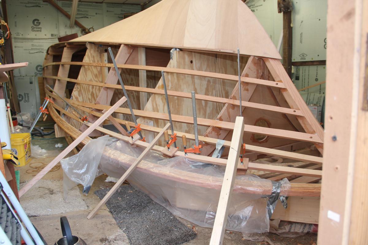

  15. Thanks fellows. It aint perfect, but its mine and I'm learning. Its not without its problems. I had my intermediate sheer stringer crack after it had been on the boat for a month. Perhaps I banged it with something. Anyhow I found it and opened it up as much as I dared and worked some epoxy into it. Then added some cabosil to the epoxy and worked it in good. Clamped it up, and its good to go. I broke the last stringer trying to install it, even after I had steamed it. Made another and it went right in. The first stringer just below the sheer clamp on both sides doesn't quite have enough twist to it at the stem and back about 10 inches or so. I struggled to fasten them just right and they won. I'll epoxy a strip of thin wood on these two spots and then plane them to size. I had problems with the station 2 frame and couldn't make it work. I moved it back, shaved some off and generally messed with it. I finally removed it and pitched it. My Doug Fir was like steel leaf springs and this was a problem spot for my inexperience. Hope it looks ok when I turn her over. This section of the sheer and bow is so important for the looks of the boat. My plans call for a 3" by 1" laminated sheer clamp with a fourth layer (1" x 1") running from the bow to about station 5. Making the clamp 1 x 4. I ended my outer 1x1 lamination about 3 inches before station 5. Sprung a batten to make the fair transition and carefully cut off the excess. It didn't look right. I glued it back on, glued on some additional length and moved my transition point to 20 1/2 inches aft of station 5 after playing with a batten trying to find the fair line. I'll cut off the excess today and report how that looks. It is difficult to see how things will look right side up when they are upside down. I'm fairing now and taking my time, trying to fix little problem areas to make it right. Hightech, you are catching up. Yea, next yr at this time. I hope your right.

  22. A couple more Two more laminations on the port side and three to starboard. The outer two laminations will be 1/2" thick as they will now take the bend. I ended up with 10 laminations per side. A couple days and my sheer clamps will be finished.
