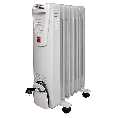

PAR Posted February 24, 2018 Posted February 24, 2018 $20 WalMart . . . 1,500 watts and can heat a single car garage to 75 degrees in freezing weather, assuming some modest insulation or a reasonably tight space (air leaks). I have several of these and can get 130 - 140 degrees under and insulated tarp (tarp with blankets tossed on top), which will post cure epoxy very quickly. At 1,500 watts, you'll need separate electrical circuits (for each one), if running them full blast for a while or it'll just pop breakers if on the same branch circuit. Quote
Action Tiger Posted February 24, 2018 Author Posted February 24, 2018 Yar. Butcept my garop is about 30’ square, uninsulated, and drafty as all get out. Oh, and the electrical plug thing. Yeah, not so much. And, did I mention drafty? There must be 4,000 vents in the soffits. But it’s all mine! Well. Except for the shelves I built lining two walls to store all the that need storing. Besides, this is California. It’ll be overnights of 50 next week. Hehe. Peace, Robert Quote
PAR Posted February 25, 2018 Posted February 25, 2018 In 50 degree weather these little puppies will easily bring interior temperatures into the 80's, even with lots of drafts. Before I sealed and insulated the barn (now air conditioned!) I found that clear thin plastic painter'as drop cloth stuff worked very well at sealing up areas within the barn, so the heaters could really get some heat on. A 1,500 watt heater will run on an extension cord, though it's amp draw will rise a little if much over 50' long. I've run them on a 12 gauge 100' cord with no issues. Quote
