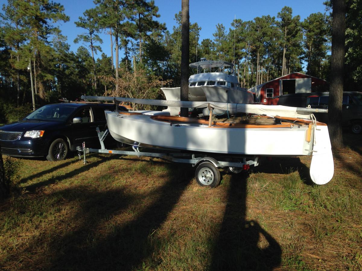

Don Silsbe Posted February 15, 2016 Author Posted February 15, 2016 The mainmast step is way forward, so I think I'm good there. It is the aft support that has me wondering. OH! I just found a photo of Alan's CS17 on its trailer. Is this what y'all are doing? See what I mean about the after (lower) section of the mast? Is this the usual means of support? Quote
Chick Ludwig Posted February 15, 2016 Posted February 15, 2016 That's about it. I've also seen an aft support that slips into the rudder gudgeons---with rudder removed, Vern... Quote
Don Silsbe Posted February 15, 2016 Author Posted February 15, 2016 I thought about that, but I wondered about over stressing those fittings. Just thinking out loud... Quote

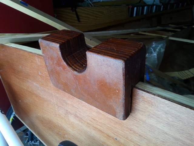

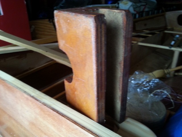

meester Posted February 15, 2016 Posted February 15, 2016 Another idea to kick around. A friend gave this to me a long time ago. It sits on the transom, and you then bungee the mast down, hooking the bungee on a gudgeon. Bob Quote
Don Silsbe Posted February 15, 2016 Author Posted February 15, 2016 I did something like this for a temporary support, Bob. Maybe the final solution is to support it mainly from the two mast steps, but to also have a stabilizer at the transom. That could be something like you show, and maybe stabilized by indexing off the top gudgeon. Are there other ways? Am I worrying about nothing? Quote
