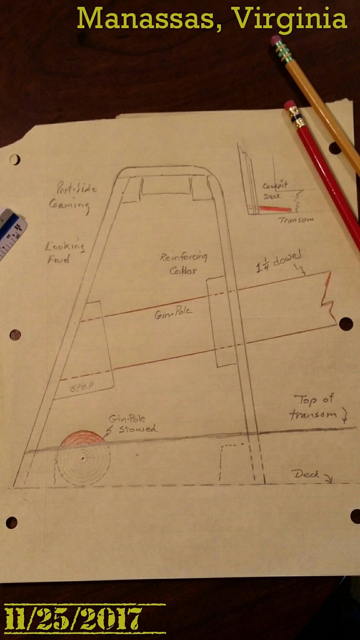

Hete's a sketch of my concept for the "deployable" Gin-Pole.  I think it's a feasible concept that would greatly air reboarding.  At the top-right I've shown a plan view illustrating how I would tilt the pole a bit aft.  However, I need to better understand the ergonomics before final details are settled.  Maybe a person would get more useful purchase with the pole tilted forward?  I have a hand-grip above my bathtub just above the tub's top edge.  It's almost useless because at that level (it's too hard to push-up) -- however, if it was higher (i.e., at arms length), I'd have much better leverage to pull-up my entire weight.

Graham, actually, I hadn't thought of that. That's why you are the Master! I'll give that some thought. I may need braces fro near the top of the "poles" down forward to the top of the coaming to resist the bending force when the sail/sprit is forward when on a run. Doggone---I LIKE the idea. Get's the sheet away from Mr. Zuki, too!
