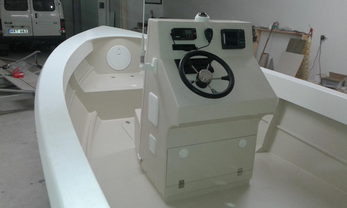

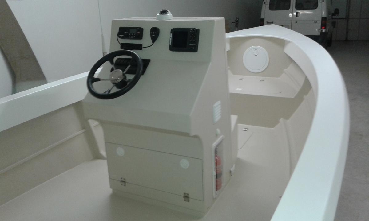

Lotus Posted March 4, 2015 Report Share Posted March 4, 2015 Mike I put the gas filler on the left hand side of the console ( its inside a special designed hatch ) You can notice the small hatch under the vhf antenna .The gas breather is on the right hand side , a small plastic fitting between the console air vent and the extinguisher Quote Link to comment Share on other sites More sharing options...
