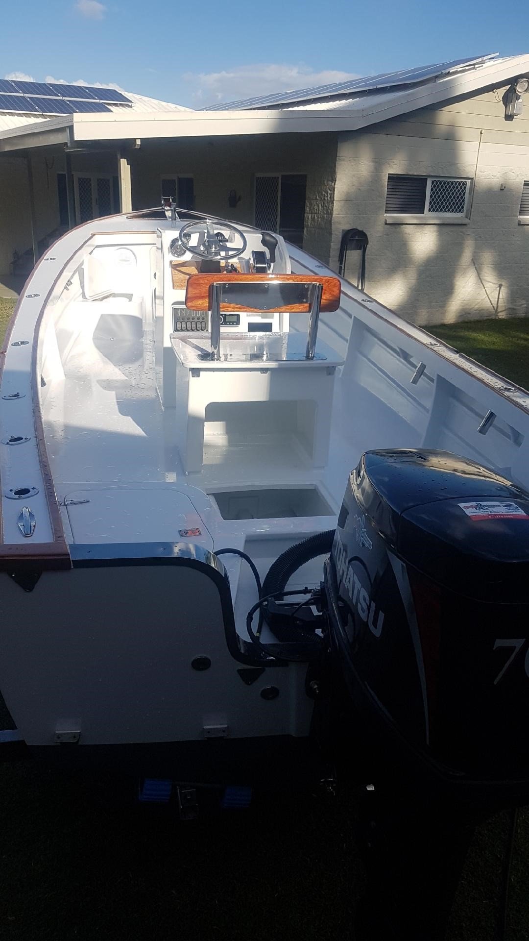

  4. Hi Guys, Thought you all maybe interested in my version of a fold down shade canopy for the timber tub... the front and back stays, once unlocked via hinged tube fittings, fold up and then after the nut on the rear of the gunnel plates are undone, the whole thing pivots forward to rest on the bow plate. A bit confusing at first, but the only way it will fit in my shed. it looks a tad tall but with the low sides of the OB-20 and the fact that I am 6'-9"........ ? I have no say in the matter! Stay safe Trev

  9. lenm Sorry no pics yet but I will next chance I get.... They are aluminium and a simple rectangular shape with Tohatsu fuel fittings on the delivery and the breather. Trev
  10. Here is (hopefully) a short Video of the boat at the local marina on an overcast day. 3 people and 60Lts fuel, no effort in getting onto the plane..... IMG_0356.MOV IMG_0356.MOV
  11. Lenm Yes there is enough room for a 60Lt tank forward of the console and one at the rear. This way, when we return home, they are pulled out of the boat and the unused fuel gets distributed between the family car, mowers etc and the bilge is nice and dry..... (I am a bit old school and don't like stale fuel in my engines)

  14. Here are a couple of photos showing CB in the salt for the first time last Sunday. We had 15 - 20 knot winds on the bay that day , which although weren't ideal boating conditions, were in fact perfect to see how she handled. My "crew" bailed out on me saying they didn't want to get wet, so I went alone for a run in the waves. The hull performed well, probably a bit flighty....(from NOT having enough weight eg: me and 20 litres of fuel) in the conditions. Except for the occasional bit of spray running headway into the swell at 45 degrees, it was dry and forgiving. The 70hp proved itself to have plenty of power and with 6 people on board in the flat water, it got the hull up onto the plane with no effort. Many thanks to Graham for his expert advice and support thru the 4 yr build. I will post some shots of her running the first chance I get.
