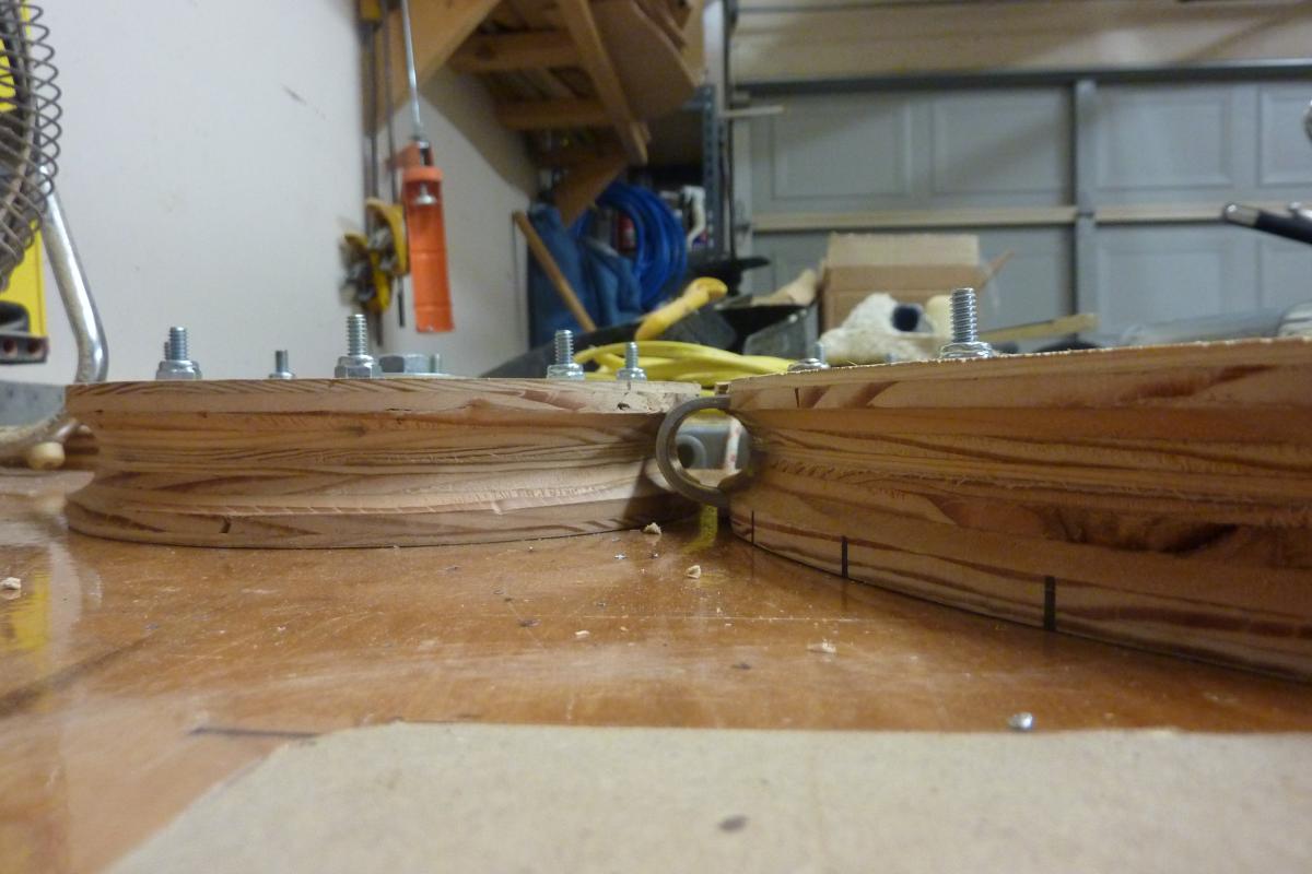

I think I've managed to put together a bending jig that will do the trick... About $50 and 6 hours of time. Half the cost was for the 7/8" round nose router bit, and the rest was for miscellaneous bolts, nuts, and a small sheet of plywood.

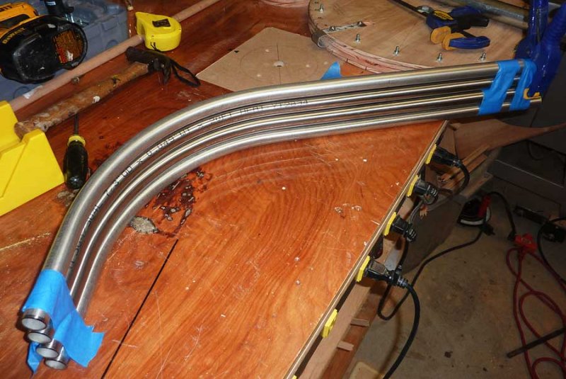

Well, happy to report that the homemade bender works great! No kinks, wrinkles, or other irregularities. Just a nice, smooth radius. The picture shows the four legs I bent tonight. I bent one piece, measured the resulting angle carefully, then re-calibrated my angle marks on the bender (to adjust for springback). After that, it was as easy as turning to the same mark each time... it puts the same bend in exactly the same place for each piece.
I'm relieved because I kept reading/hearing anecdotes from others that suggested bending would be hard or the results would be inconsistent. Very glad I listened to the few who encouraged me instead. It'll probably take a few more hours to make certain the corresponding bends in the crossbeams (to put some crown in the roof) all add up correctly and symmetrically to the desired angles, but I think this project is going to turn out much easier than I worried it might.
You did everything right... The big thing is to always measure, measure, measure!! As long as you hit the same marks, and the middle goes in the same place, and clamp is in same place on ridge you are always good. We always do the crown and bends based off the natural curve of the piping.

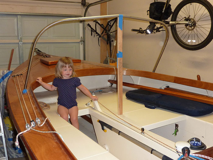

Last part I was worried about was how tricky it might be to match the crown in the crossbeams to the angled sides for the correct overall dimensions. But I got lucky and it came out right on the first try. Here's the first complete bow. One more to go.
I won't know how much to adjust the overall height until I order the fittings next month, but so far, this really has not been difficult. Hardest part is hacksawing through the tubing in a hot, humid garage... which really isn't bad either.
Plenty of room for Bella! :) Actually, the bow will be cut down a bit once I have the fittings. I want to see how much the attachment hardware will alter the dimensions before I do any cutting.
Several folks PM'd or e-mailed me with questions about the bender already, so I made this little video this morning in case others are going to attempt this...
