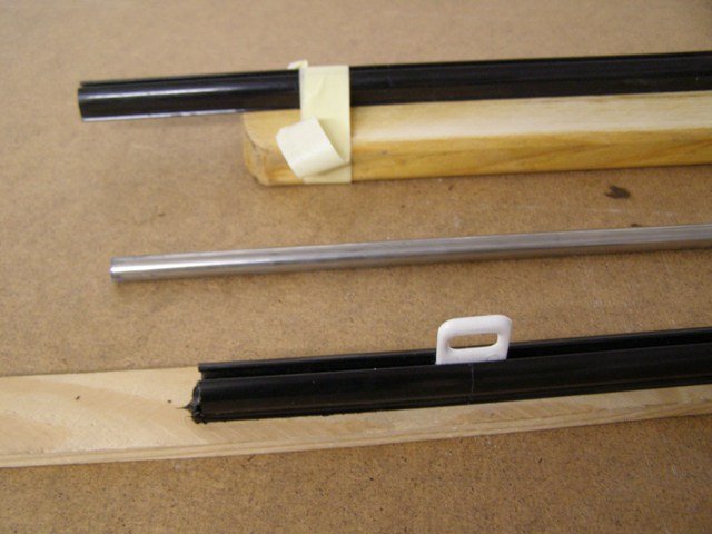

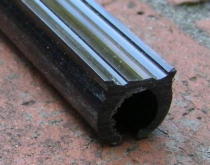

Guest wwbaginski Posted November 15, 2009 Posted November 15, 2009 In fact there's no info on tracks, please contact directly here: customerservice@vandusenracingboats.com I've not been glued them on my masts yet, beacause I'm still hoping to sail this November again. Tracks are planned as a winter project. I,ve got them by post, cut into pieces about 1.5 m long each, total length 15.3 m in cost 120 $. They can post in a coil of the right length form too but it was too expensive to me (i'm in Europe). Plastic slugs (only 1.5 $ each) I've got from my friend do fit to the tracks perfectly. He is a succesfull user of the system, in Sweden. He glued tracks with a polyurethane glue to carbon masts, but he said no problem with wooden masts . Here is my track photographed: Quote
Guest wwbaginski Posted December 5, 2009 Posted December 5, 2009 as Doppio is dismasted for winter, I started tests on carbon tracks. First step on photos: I glued two pieces with a steel rod inside , of the same diameter as the slug is. next day the rod has been pushed out with a slug. the method is ok, the slug passes the joint very smoothly. Next step, a strengt test, later. Quote
Randy Jones Posted December 5, 2009 Author Posted December 5, 2009 That looks pretty good. I was hoping you would do a test. If your glue test passes, I think I will use the carbon fiber sail track instead of the stainless steel. Thanks for doing the dirty work. Quote

Palolo Hawaii Posted December 6, 2009 Posted December 6, 2009 Perhaps his track was made from extruded black ABS and not actual CF? This supplier in NZ also recommends Sikaflex for their plastic track: http://www.c-tech.co.nz/shop/Our+Products/Sail-track.html (They've got small boat track in ABS for NZ$11/metre, too) I've also seen a skiff mast being repaired, and they bonded their true carbon track using 2-part Plexus adhe$ive. The tube has a mixing nozzle to blend both parts as it is squeezed out. pat. Quote
Guest wwbaginski Posted December 8, 2009 Posted December 8, 2009 pat., yes you're right, this is how they have answered my question today: "The sail track is not Carbon Fiber. It is an extruded black ABS " luff track #3". It gets attached to your mast with an glue like strong adhesive that comes in a tube we use "Plexus". Please let us know how else we can help. They can contact us directly if your would want.. -Aliisa" Quote
Hirilonde Posted December 8, 2009 Posted December 8, 2009 Ah, ABS is an entirely different animal. It is UV resistant by itself. I never thought of it being rigid enough for something like a sail track, but obviously it is, at least for small boats. Plexus is obscenely strong, but slightly brittle. It etches into the plastic as well as works as an adhesive. Quote

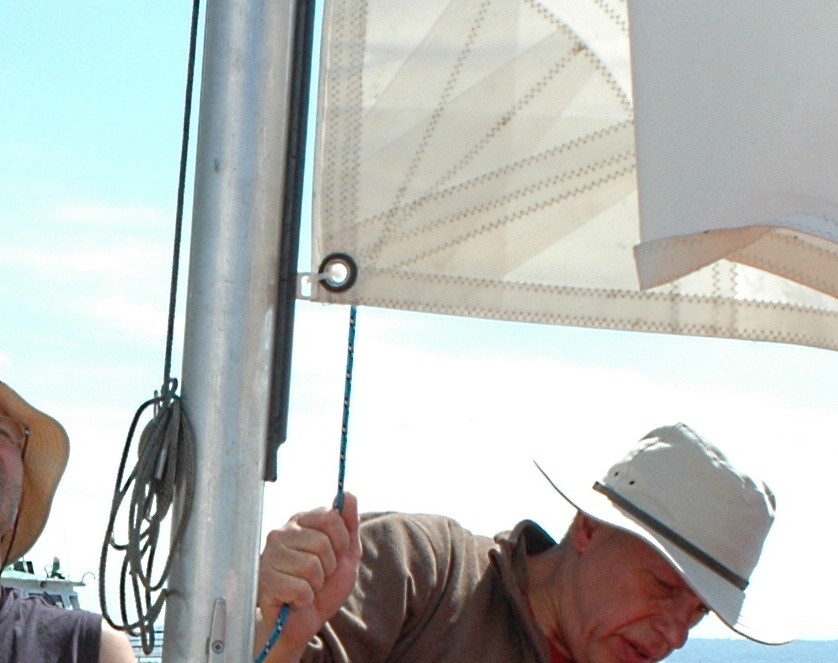

Guest wwbaginski Posted June 16, 2010 Posted June 16, 2010 1. bearing balls glued in mast foots meke the rotation VERY easy: http://www.messing-about.com/forums/index.php?topic=7126.0 2. plastic tracks and slugs do cooperate nicely , no doubt the tracks are stong enough. Reefin and unreefing underway became much easier - no need to pull the sprist off the masts wne rising or lowering the sails. 3. alu tubes laminated on lower mast parts made them stiffer and the mast curve starts above the sprits now. Quote
