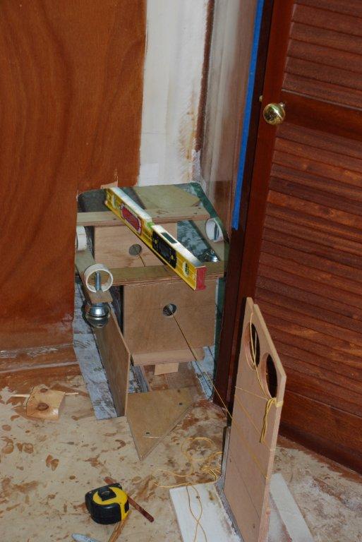

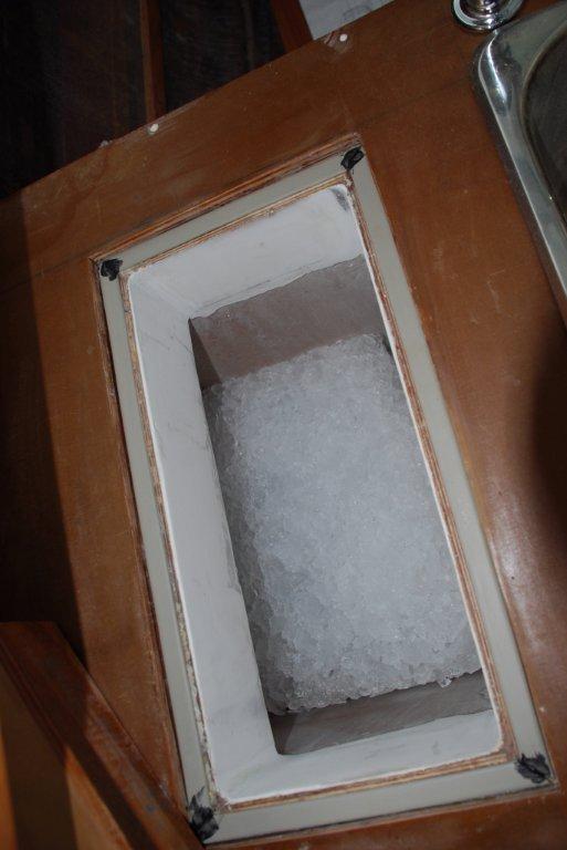

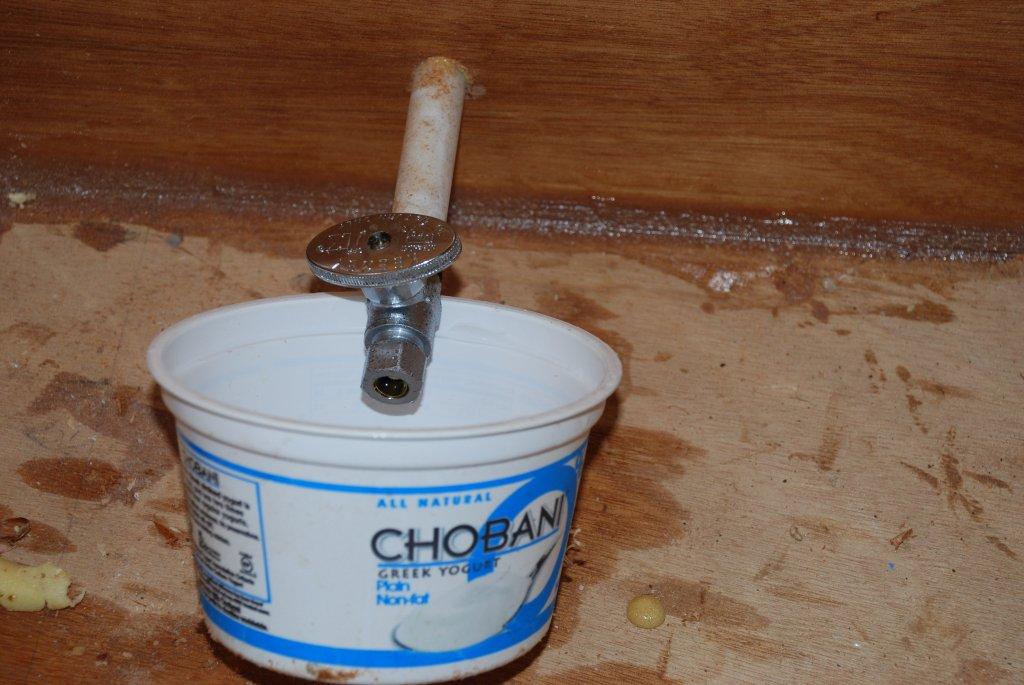

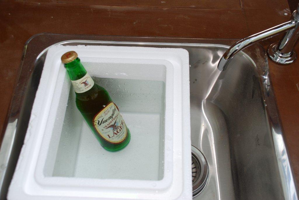

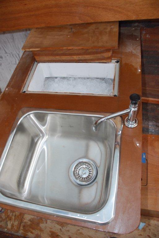

PeterP Posted August 22, 2011 Author Posted August 22, 2011 Slowly getting back up to speed after my surgery. The first picture shows the port 20 gal water tank all plumbed in. It took a several tweaks to get that sorted out. Its twin to starboard is being framed in even as we speak. I am really excited about the ice box. I was bit worried when I poured the first batch of foam since I did not get the anticipated expansion. But the thing seems working just fine. Last Sunday I filled it with just on 100# of soft ice. Each day - to simulate usage- I would open it in the morning and in the afternoon. At 5PM each day- Happy Hour - I drew off the melt water through a valve in the bottom- measure the volume and put it in a styrofoam box with warm bottled beer. The volume and temperature were enough to chill two bottles in about 30 to 40 min. On top of that - all that melt water can be used as rinse water, shower water or in a pinch filtered and boiled for tea. That boost my water capacity significantly by 15/16 gals. After 7 days exactly the box is still 2/3 full of ice. I am adjusting my hopes from 10 days to close to 14. I feel it would be feasible to get easy two weeks with some hard ice blocks in the mix. Quote

PeterP Posted August 31, 2011 Author Posted August 31, 2011 Well, I am officially shutting down my ice box test run after 18 days. I quit draining the melt water when Irene hit but when I looked in this morning there was still a good pile of ice in the bottom- probably 4-5#. Good enough to chill a six pack or make a pitcher of G&T. I am tickled pink. I feel that with a mix of soft & block ice I could go 3 weeks. That is not bad. I know blocks are not always available but when I can get some I'll be in clover for a good while. PeterP Quote

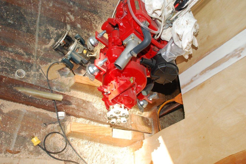

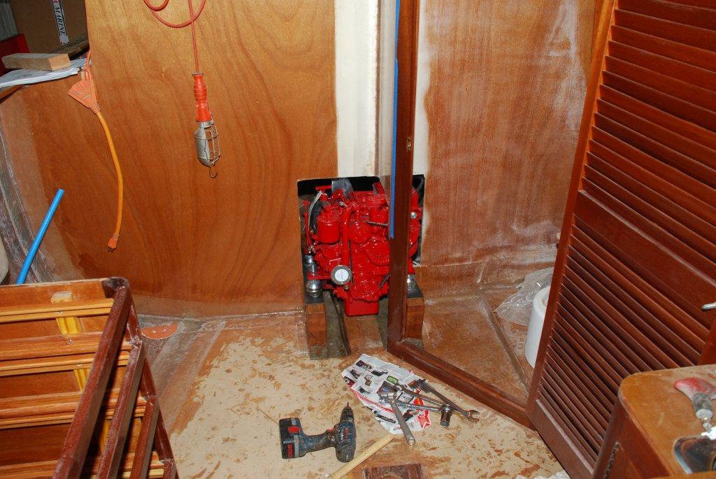

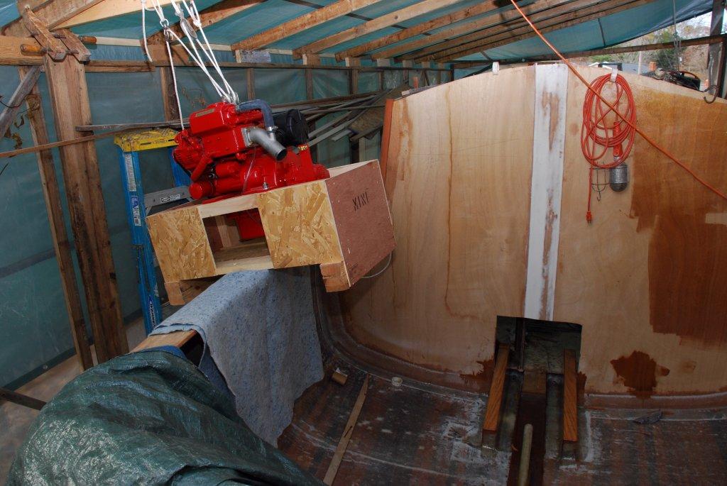

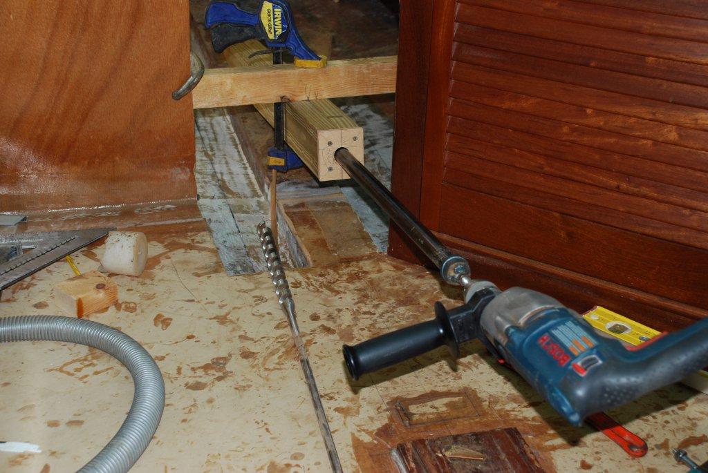

PeterP Posted November 19, 2011 Author Posted November 19, 2011 With the last years tax refund burning a hole in my pocket I decided to buy the auxiliary: fourteen horse Kubota diesel as re-engineered by Beta marine. All this happened last Spring and was a bit premature to be sure -but with the tsunami wrecking the Japanese economy I became worried that stuff would get too pricey or unavailable - so I got it. It's been sitting in the garage since then and I have been scratching my head about stuff like shaft alignment, boring 8 deg HOLE! through perfectly good and solid boat bottom etc etc.Now I am on the verge of putting the little donk in its place of toil. I have some more pictures. First shows the engine and beds layout. Second shows my home made boring bar/jig and third shows the engine beds all glassed in with the 1 5/8 stern tube awaiting epoxy. All perfectly lined up on the string. Regards PeterP Quote

Twetmore Posted November 23, 2011 Posted November 23, 2011 Peter, I am interested in your boring jib, diameter of hole and length that you bored. I made wood birdsmouth mast for my boat and put blocking at the bottom and 6'-8' into the mast. I have what is probably a dream to wire some lights to the top of one or both of my masts but am worried about blowing a hole in the side of the mast. Blocking goes from bottom, 3' up stops and starts again from 6'-8'. I have a feeling this is nearly impossible to do on my own but thought it would ask the question anyways. Thanks, Tom Quote
ChrisObee Posted November 23, 2011 Posted November 23, 2011 I would use a table say and cut a grove in the side of you mast the length of the blocks, lay your wires within and fill with expoxy and wood flour. Or you epoxy some shims in there and knock them down afterward. Quote
PeterP Posted November 23, 2011 Author Posted November 23, 2011 Tom, I basically agree with Chris except the way I read your post your mast is already made I think. Hard to get the table saw in there now to cut the dadoes. I only bored through 16" where it counted. But honestly, even if I messed up and the bit wondered off say half an inch - no big deal. Epoxy is just wonderful. You don't have that luxury though.I would not attempt to bore out a mast. No way. My starter bit was one inch auger tacked onto a 1/2 in steel bar. The boring bar was 3/4 in black pipe with 1/4 in dia bolts tapped into the end. Heads ground off to provide a good shearing action. Advantage being that by screwing the bolts in/out you can fine tune your bore and at the end of the day the pipe gets recycled into a pipe clamp. With augers you only get one size and they are not cheap in the sizes I need. Did you think about running a fine saw down the middle - cutting the slot and then re-gluing? Good luck PeterP Quote

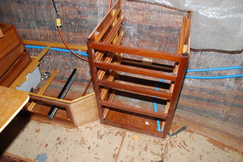

PeterP Posted December 8, 2011 Author Posted December 8, 2011 One step forward, two backwards. That's the way it goes sometimes. The chart table cabinet underwent several modifications the last of which were conduit snakes for the various light fixtures up front. While I was at it I decided to add another drawer to the S-board settee/berth. Trading good buoyancy volume for stuff space. Hope I don't come to regret it later. The little diesel is in. Need to order the shaft and PSS seal to finalise the alignment. Everything looks good so far. About where I had hoped to be at this point. Not perfect but good/workable. Cheers PeterP Quote

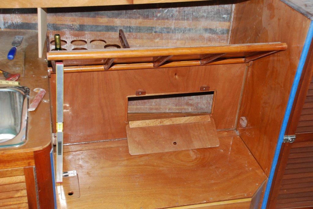

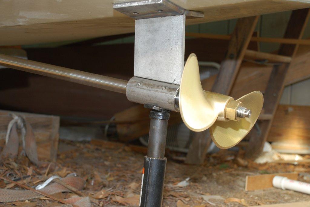

PeterP Posted February 8, 2012 Author Posted February 8, 2012 This one is for all those Santa deniers I guess. Santa IS, still, doing his stuff for all the GOOD girls and boys. The reason he does stuff for me is not because I happen to be particularly good but because my wife is part elf. So I got a shaft and a prop for Christmas. The fact that it only just arrived a week ago I don't want to dwelve on. I'll come back to the shaft& prop in just a sec. First the seat back-rests. It took a while to put into effect the ideas I had. I wanted rests that flip up easily to allow access to the storage behind. Naturally, the starboard side rests have to come up to allow full width on the berth. The pictures show the final product. I like it so far- we'll see how it works in real life. Next, I had to pull the diesel one more time. I spent gobs of time making sure the beds were bang on the money and when I put it all together it looked JUST SO SWEET. The problem was the set up was adjustable in only one dimension. Like Graham says: every time you think there's even chance of success you're most likely 90% wrong. So I pulled the donk and notched the beds 1/4" to give me some more play for the final alignement. Now we are back to the shaft. Boring out for the stern tube was only the beginning and I can see why some people develop such a dislike of engines and things of that nature. In a nutshell this is what I've accomplished so far. Ran a shaft up a stern tube and built a strut for the said shaft. I reckon I have probably close to four days worth of work in that. The number of times I climbed in and out of the boat to check the latest iteration of tweaks and adjustments is beyond count. Hopefully, things will go smoothly in the welding shop tomorrow and I'll have it all together later on this week. Be good PeterP Quote
