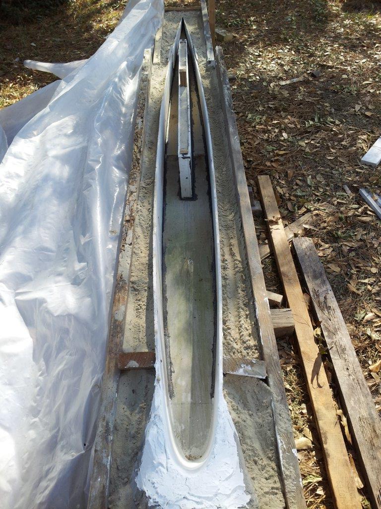

Howard Posted December 9, 2014 Posted December 9, 2014 Peter:  Looks good. If you need an audience when it comes time to launch that thing, let me know. I"d love to be in attendance.  On pouring the keel, what I learned from doing the CB tip, and from a conversation with a local lad who claims to know a thing or two about casting, is you need a cap on top of the mold, PLUS a a makeup reservoir on top to replace the volume lost due to shrinkage as the lead cools. Otherwise, you end up with a cavity on top that has to be filled with something.  When I do the keel for the 26, if I don't get that fellow and his large crucible to help, I'll make a casting form box with 2 x 8 lumber on the top and bottom..........2 x 6 lumber on the sides, with green sand as my mold, replacing the top board before the pour. I'll leave two gaps and make two sand boxes on top to pour through, which will double as my makeup reservoirs. For my crucible, I'll make two of them from 20 pound LP tanks, with legs welded on, and use two fish cookers as my heat source. Each of them will be slightly more than half full, so they will heat faster, and with two running at the same time, will dump faster........one on each end, filling towards the middle. The 26 keel runs about 750 pounds, so you would probably need three crucibles instead of two. It might sound like a real fire drill to handle that many, but I bet not. Heating that much lead takes a long time. The only trick would be if you have to heat each individual drain pipe to get them flowing. I plan to have a helper on the 2nd one. For something like this, it shouldn't be too hard to recruit bystanders.......if nothing else out of morbid curiosity.  I'm also mindful of what Tony told me about his first attempt at casting his keel, where the weight of the lead pushed his mold apart, so he got to do his twice. That is why the heavy 2X lumber and making a tube of it. That and the need for a cap to get an even top. Wood will scorch, but it shouldn't hurt the keel any, provided it is dry. Green, wet wood might get ugly. Quote
PeterP Posted December 9, 2014 Author Posted December 9, 2014 The juicy things you find out if you listen long enough. Tony never brought up his lead adventures with me. I actually plan on pouring about 50 -60# more than required to allow for the uneven shrinkage and all the substitutes in the wheel weights that are likely to affect specific gravity of the metal. I'm not doing a stand pipe - just overpouring into an open top mould and planing it flat for mating to the keel stub. Good point about shoring up the sides which I intend to do using 2x4 stakes in the ground tied across the top. As for the help - I already have offers to video the proceedings "just in case". Now if I could only get some help with the actual work...Cheers PeterP PS Joe the Singer will go to work on the boat cushions. Regards Quote

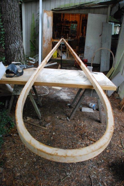

Greekbuilder Posted December 10, 2014 Posted December 10, 2014 Thank you Peter for your nice comments and solid advice. I'm also wondering if I should go that big. This will actually be my third build. Since my last post I managed to permanently include my boats at the bottom of each post like everyone else, but do these account as real boats ? Sure I spent a couple of months on the canoe and some 8-9 months on the Cartopper (mostly weekends and evenings) which adds up to about a year of boat building experience. But from a 12 footer to a 28 footer ? We'll see. How did you build the wishbone ? Out of thin strips laminated around a jig ? Got any pictures of the process ? And the lead keel mold ! You definitely know your way around. I watched these metal casting videos on youtube if you haven't seen them already Might be of some help. Can't wait to see how it comes out. Good luck with your pour. 1 Quote
PeterP Posted December 10, 2014 Author Posted December 10, 2014 The wishbones are laminted over a jig. The curved part - that is. Spruce strips 1/4 in. To save work I glued up one "fat" piece for each and slit it in half on the table saw. You will need to make two different jigs since the 'bones are both different. The straight sections are just that - sawn wood scarfed on at 10:1. I did'nt feel like I needed to go overboard on the scarf since I wanted tape on the outside for added strength anyway. The finished dimensions are 2 1/4 in x 3 in x 3/8 in hollow box main and 2 in x 2 in x 5/16 in hollow box mizzen. There is 6 oz (?) kevlar tape front and back and 10 oz glass top and bottom. The kevlar is mostly for ding protection ( whacking pilings), the glass will help with sun degradation. May even paint the top and bottom and leave the yellow kevlar for an accent. The main weighs 24 lbs and the mizzen was 18 or 20. if memory serves right. That's without hardware. Not super but not bad since they are big mammas. Don't ask me how I got the numbers - Graham thought they looked reasonable. We'll see. Quote

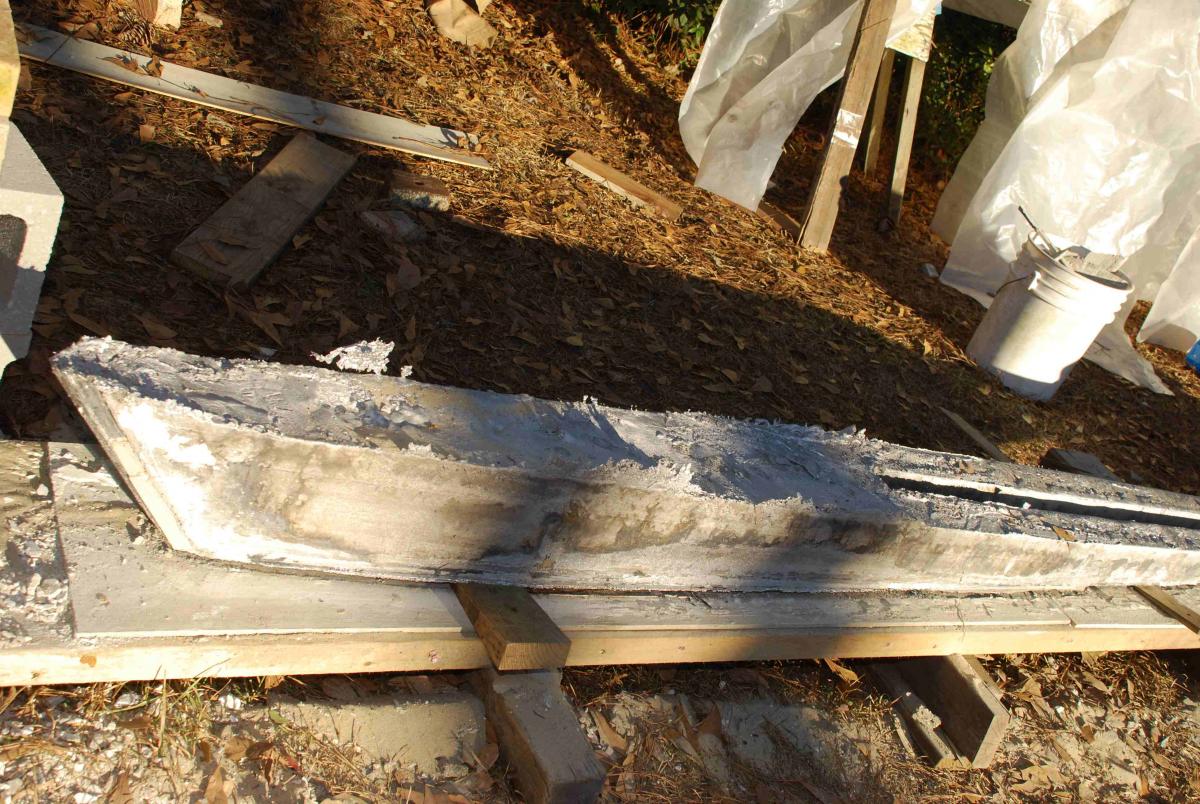

PeterP Posted January 11, 2015 Author Posted January 11, 2015 Poured the lead keel. Not something I want to do very often but it is doable. About the mould which underwent a few changes in its evolution - I think it was up to Mark III by Pour Day. The basic concept of using Hardie Plank for the contact surface backed by sand proved to be excellent. The idea of using drywall mud mixed with sand to leak-proof the joints would've worked -I think- except when I filled the mould with water to double check the volumes- the whole thing turned to soggy mess necesstating a major re-do. So back to square 2. The final configuration had regular mortar 3in fillet on the back side and 3M FireStop (1000 degF) caulk 3/4in fillet inside. That worked great. I had zero leakage. It took a bit over 2 hours to melt the 1200 # lead with +/- 300 000 BTU on hand. Hugely inefficient heat transfer. I tried to mitigate the heat loss by walling up with fire brick but still - I guestimate 70% of the heat just blew away. (Some of it kept me warm on that very cold day tho') The big hand-held propane torch was invaluable as it helped to melt the plug which forms inside the pour tube. Big thanks to Tony and Seth who selflesly loaned me some of their equipment. I melted aprox. 1200 # - left about 10# inside the two tanks, skimmed off about 40# of slag and I suspect another 20 - 30 # will come off during clean up and fairing. I thing I shoud be realy close to designed weight. Not a bad days work. PS -There are two tanks available to who ever shows up. Mine will hold 700# and Tony's will hold 500# - his is the better built of the two. Cheers PeterP 1 Quote
Joe Anderson Posted January 11, 2015 Posted January 11, 2015 Very Nice Peter. Thanks for the photos. Glad to hear the pour went well. Looks like the hardi plank is a good way to go. Â Your earlier version Mk 1 mold had sand filling the center board slot. Mk 3 has no sand just some 2X spacer blocks. Why the change? Quote
PeterP Posted January 11, 2015 Author Posted January 11, 2015 After I water logged the mould all the sand had to come out for it to dry out and when it was time to put it back together - upon reflection- I did not see the need for it there any more. The lead is only about 3-4 in high in that section so the pressure wasn't that much of an issue. Quote

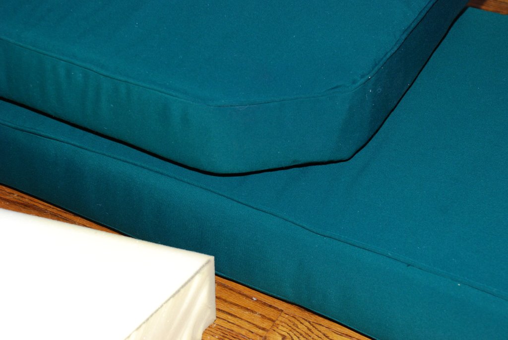

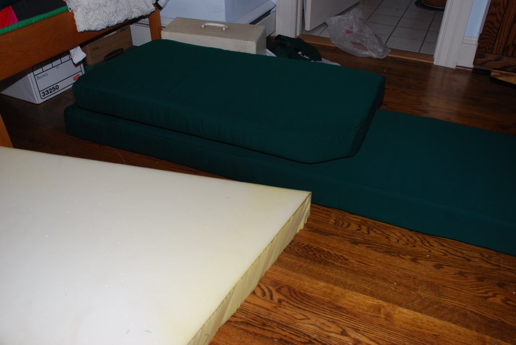

PeterP Posted January 21, 2015 Author Posted January 21, 2015 Last week brought some cold weather while I was cleaning up the lead keel. Nasty cold and wet - so I moved indoors and made some cushions. One more thing I learned on this job. The day I die I'll have so much experience I can hardly stand it. The cushions look great with fancy piping and all. In addition they fit like they are supposed to, they are comfortable and the price would be hard to beat. Take a good look at the Singer sewing machine: no frill all metal job given to me for free simply because it was deemed to be too old and lacking in sophistication. I love it - it is slow BUT it wil put a V-92 thread through six layers of Sunbrella and never miss a beat. The key there is: all metal. And now for the best part: it warmed up again so I went around the boat jacking it up bit by bit, slid some schedule 40 PVC pipe under the building frame, hooked up the old Ford pick up and promptly smoked the clutch. In the excitement I forgot to remove one of the blocks, things got jammed up and smoky before I realised what the problem was. Then -finally she slid out. Bit by bit and there she was in the light of day. PeterP 1 Quote

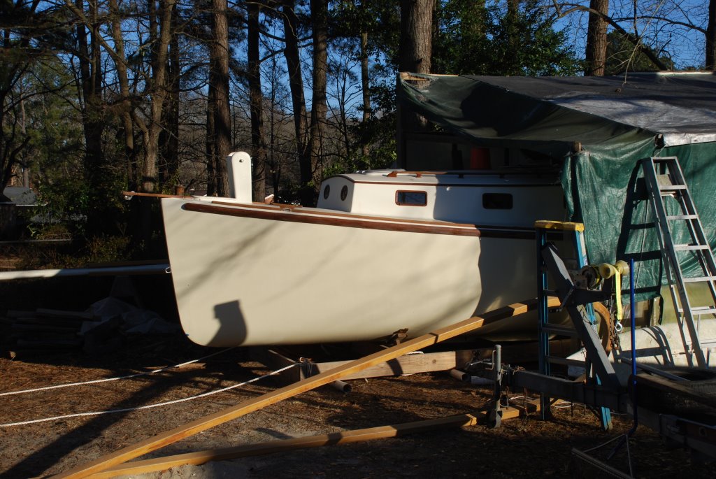

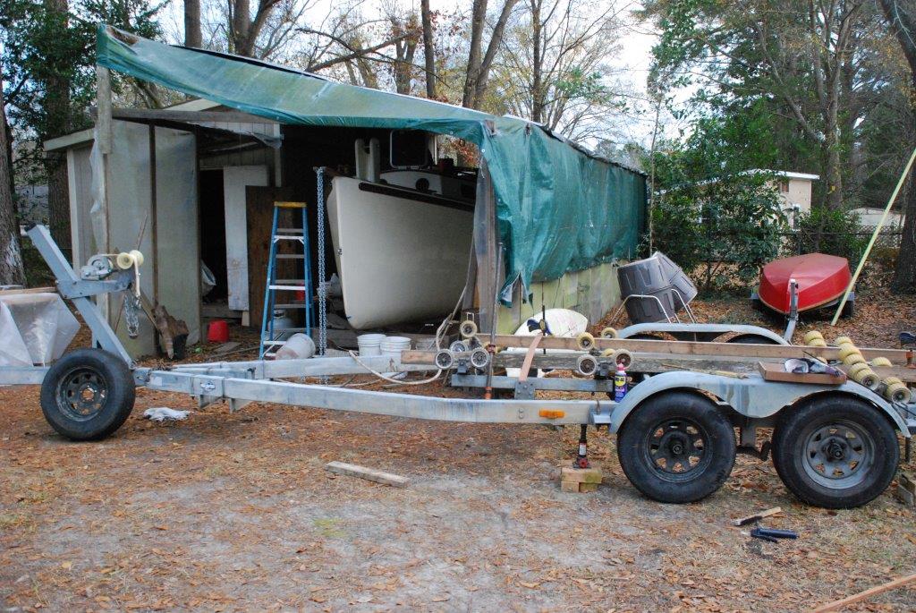

Howard Posted January 21, 2015 Posted January 21, 2015 Hmmmm. Cushions finished.......pulled out of the shed into the light of day........next to a trailer. Keel ready to install. That is looking very close to splash time!!! Quote
