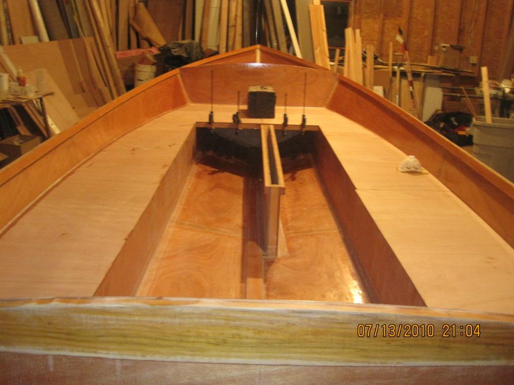

  11. It has been a busy summer and I really did not get to work on my boat at all. With my Dad getting ansy to get it our of his garage in the subarbs I am planning on finishing it by May. Here are a couple of photos. My next step will be putting the deck on.

  13. I thought I would update everyone with my progress for anyone that is interested. I have finished all of the deck framing and just need to seal the wood with epoxy and sand some fillets, then I am on to installing the deck. I think I have decided to use 4 ounce fabric on the decks and seats similar to Wes for abrasion resistance so that will add a little more time. With my wedding coming up and August and my project coming to the finish line, I have not had as much time to work on my boat as I would like and have been meaning to post some more pictures. I have a couple of questions or things that I would appreciate comments on if anyone has experience: 1. For the last 4-5 months I have been trying to figure out a way to mount my outboard on the transom in an inexpensive way. I was going to try and custom build something similar to Wes's setup but I don't think I have resources to make a bracket I am comfortable with. I finally decided I am going to go with a Garelick adjustable bracket Garelick 9" Adjustable Outboard Bracket. It is expensive...the problem that I am having is that even thought I have a long shaft motor, the depth is not enough to allow me to tilt the motor up when not in use and keep the cavatation plate below the water line when in use. This bracket achieves this and would allow for adjustment based on how much weight I have in the boat. Before I purchase it though, I would appreciate any input. 2. Trailer! I have been trying to figure out a trailer for this boat for a while. I know that there are a lot of posts out there which I have been reading. It is an odd boat to trailer because of the size to weight ratio, it seems that many people just deflate the tires a bit to make up for the low weight which I am fine with. I have been searching on craigslist constantly and contacting local marinas without much luck but will keep trying. I was wondering if anyone knows if there are regulations for the length of the trailer versus the lenght of the boat, I have a feeling that if varies from state to state but would appreciate any input. Has anyone recently purchased a newer model that works well that I could look at for reference? 3. Finally, I am looking at ordering navagational lights. I was wondering if anyone had any input on bow and aft lights. I want LED to minimize power loss. Do people typically mount them on the deck or on the hull at the bow? Thanks, Tom
