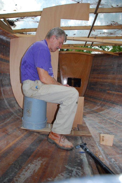

PeterP Posted October 14, 2010 Author Posted October 14, 2010 Well, I cut out some bulkheads and clamped them in the boat to see how things would feel and look. As mentioned elsewhere I wasn't 100% decided about the head placement. I felt drawn to Garry's "head aft" but who knows -I thought. So putting up a few partitions would clarify things - and guess what. Worked like a charm. The picture clearly shows the forward head as being clearly too tight. A real Houdini job -in fact. Redesigning the entry way to the cabin would give me more knee room but the cost would be a tight rathole of a passage to the bunks. Not me, not now, no way. So by eliminating that I am faced with two possibilities: things had better work out up against the aft bulkhead or it'll be a cedar bucket in the cockpit. PeterP Quote
Steve Day Posted October 14, 2010 Posted October 14, 2010 Good idea to try things out while changes are easy. Getting "stuck" in a head that is too small in a seaway can be quite interesting, to say the least. Careful thought and trial really is a good thing. Keep on working and taking pictures. However, we might have done without the one of you sitting on the "throne." Steve Quote
PeterP Posted October 15, 2010 Author Posted October 15, 2010 Steve, I detect a hint of disapproval . I guess I was kidding myself thinking I cut a fairly decent facsimile of Rodin's Thinker. It is definitely low budget version. PeterP Quote
Garry Posted October 15, 2010 Posted October 15, 2010 That's definitely a smart way to do it, trying temporary bulkheads out to see how it feels I mean. But keep the bucket handy. You'll be doing a lot of sittin' and thinkin'. One thing about the aft placement, you should be able to tuck most of the head back behind the companionway ladder so there is less loss of cabin space. Also, you MAY be able to tuck the seat partially under the bridge deck without impairing overhead room. Quote
Steve Day Posted October 15, 2010 Posted October 15, 2010 No disapproval! Actually, hearty encouragement for the trial. I just wasn't sure about the pictorial record. Steve Quote
amberger Posted October 26, 2010 Posted October 26, 2010 Hey Peter, Things seem to be progressing rather nicely; it's rather exciting to watch it develop. Great idea about forming mock partitions. Korie Quote
