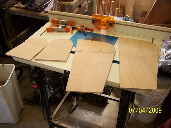

Greg - It that the standard spindrift rudder blade?
A good question.   No, it came from a 14ft. boat (Skipjack) that I bought for salvage parts and its trailer.  I realized today that this rudder is not going to be a good choice for the Spindrift because it is not a kick up rudder.  Until I really started working on it a couple of days ago, I thought it was a kick up type, just with varnish sealing the joints.  I plan to go ahead with the refinish and then put it on Ebay.
I can fabricate a rudder per Graham's design in a couple of rainy days and am now going to do so.
Thanks for asking. :)

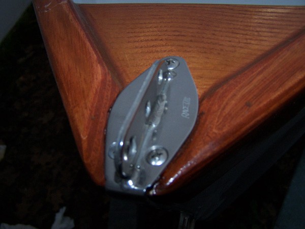

Some of the hardware from B&B arrived yesterday. Today I fitted the bow eye and the stem fitting and hope to have the chain plates fitted tomorrow.

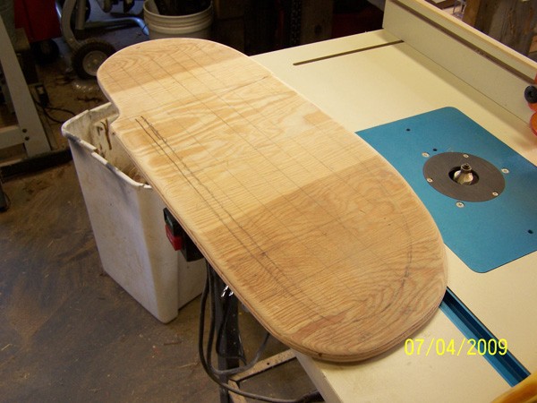

I decided to make the aft hatch seat with strips of white oak and walnut, then finish it bright.  The new band saw blade has really made it nice to do resawing again.

Greg, it looks like a Medieval torturing device. Do you threaten the wood with the nail board to get it to behave? ;D
The rudder is now mostly done, just needing the downhaul installed, the pintles, gudgeons, and the stem fitting is also installed. I wonder why a wing nut is specified for the rudder axle? I like a self locking nut much better, that will keep its position.
I still need to make a tiller and extension but have just now really started thinking about it. It looks like it is a solid piece to the rudder cheek top in the plan. I do not like that, preferring a removable rudder and also one that will hinge up and down. I think I will give Graham a call and see what light he can shed in my head  ;D.
