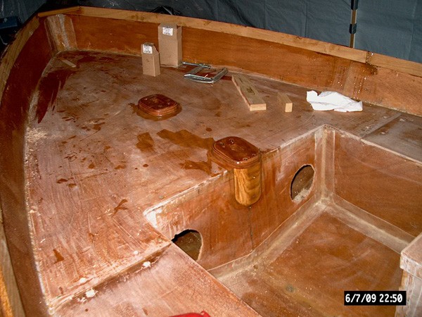

Greg Luckett Posted June 6, 2009 Author Posted June 6, 2009 It was in the upper 80s or low 90s in the tent today and the epoxy was kicking off fast the way I like it!!! Cure time was a couple of hours instead of 12 or more hours. The last of the gunwhales and the boat name board are now installed. The seats are sanded and almost ready for fairing. The sole and cockpit areas need sanding and cleanup still. The stem junction is fabricated and ready for final fitting once the breasthook is also fabricated and fitted. The two quaterknees at the transom need fabricated, as well as the mast tabernacles. I plan to route a quarter round edge on the seating and the dagger board trunk. The transom seat and hatch still need some designing and fabricating. If tomorrow is as nice as today, all these details should be done and the boat ready for sanding and fairing of the insides. Man I love warmer, dry weather!!! The tiller is from the same boat I scrapped out that the mast is coming from. It needs a bit of repair and pics will be taken tomorrow and posted. Quote

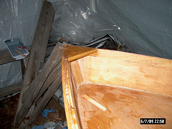

Greg Luckett Posted June 6, 2009 Author Posted June 6, 2009 A few more pics. The quarterknees are fabricated, fitted, and sanded but not yet stained or varnished. The breast hook was done wrong and must wait until the stem junction is not sticky any more...it is epoxied in place and clamped. Next it will have several layers of cloth tape and epoxy added to it, but before that the breast hook can be refitted for fabrication while the stem junction drys. Included is a pic of the rudder and tiller from an old boat that was scrapped. Man! I love recycling whenever it can be done. Oh, and a shot of why the work does not go as fast as it could? I do need my "thinking" time. ;D Quote

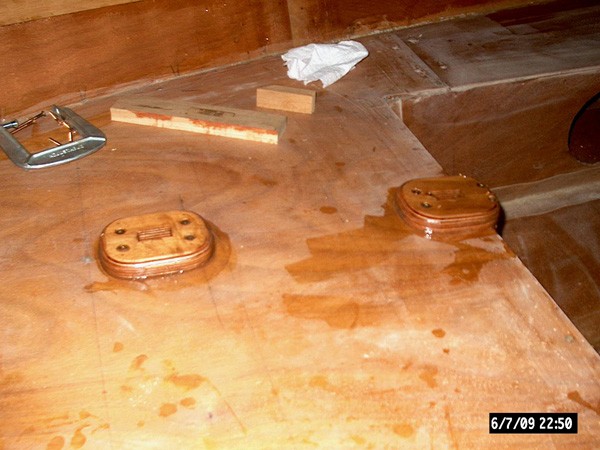

Greg Luckett Posted June 8, 2009 Author Posted June 8, 2009 It took me most of yesterday and today to fabricate and install the two quarter knees, the breast hook, and the two mast tabernacles. I spent a few hours shaping the block that goes under the aft mast tabernacle and on the bulkhead, then more hours cutting out the mast holes in the tabernacles, and then locating all of the pieces in the correct positions. It always surprises me how much time is spent on these details. Quote

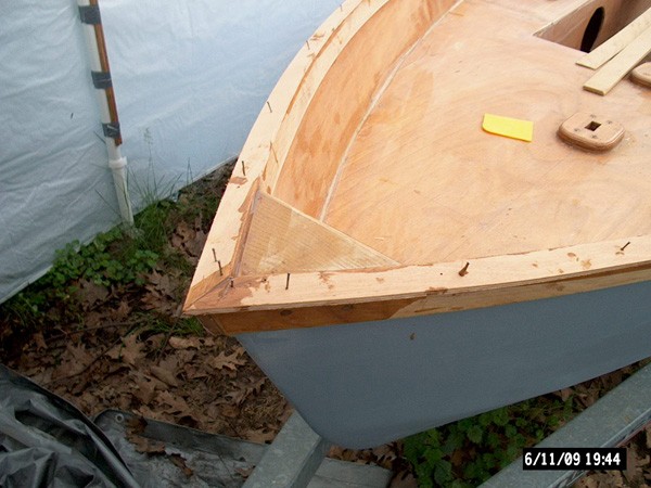

Greg Luckett Posted June 12, 2009 Author Posted June 12, 2009 Trying to maintain progress by doing at least a little bit every day is having a positive effect. The last couple of days were spent working on the gunwhales. It took some creative thinking and a day to arrive at the solution; hopefully a good one. Yesterday was spent laying it out and cutting and dry fitting. This evening after work was spent gluing on the parts. Tomorrow should see the cleanup and rounding of all the edges with a router, then on to finishing, sanding, fairing, sanding, priming, sanding, second primer coat, sanding, and then the finish coats. Did I mention sanding? Quote

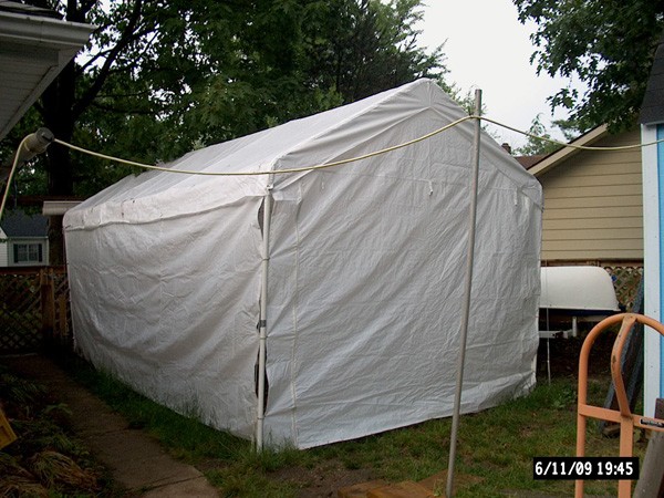

Greg Luckett Posted June 13, 2009 Author Posted June 13, 2009 Today the gunwhale caps were shaped with a router and then sanded and the areas where the filleting was needed, such as the nail holes were filled. Tomorrow should see the completion of the gunwhales. All the seats were rounded over today too, as well as the c/b trunk. I am attaching a picture of the tent with one end open for those interested in using the tent option. It has held up well so far, but no real wind storm have occured here yet, and it would not work with a snow load. Quote
