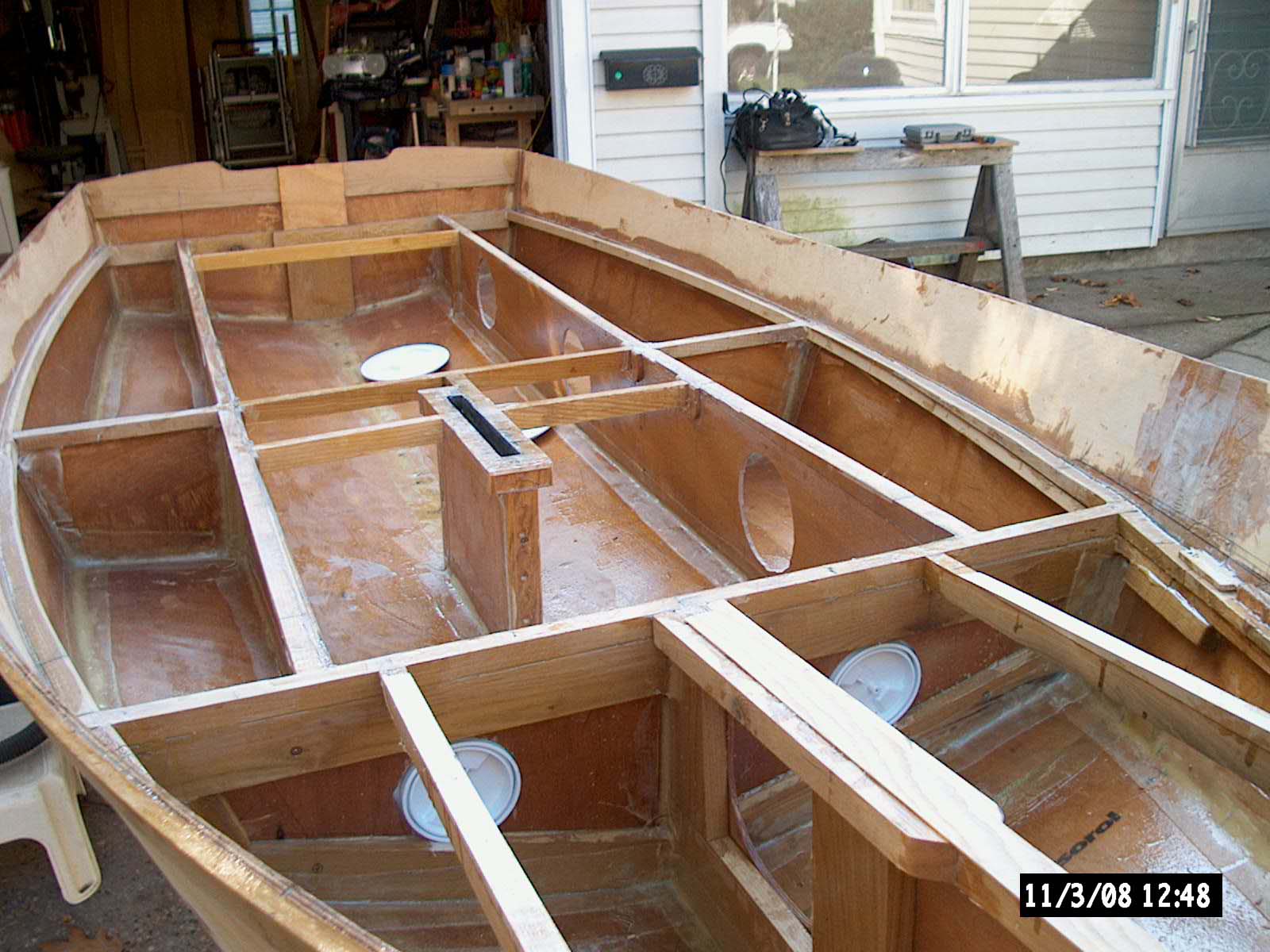

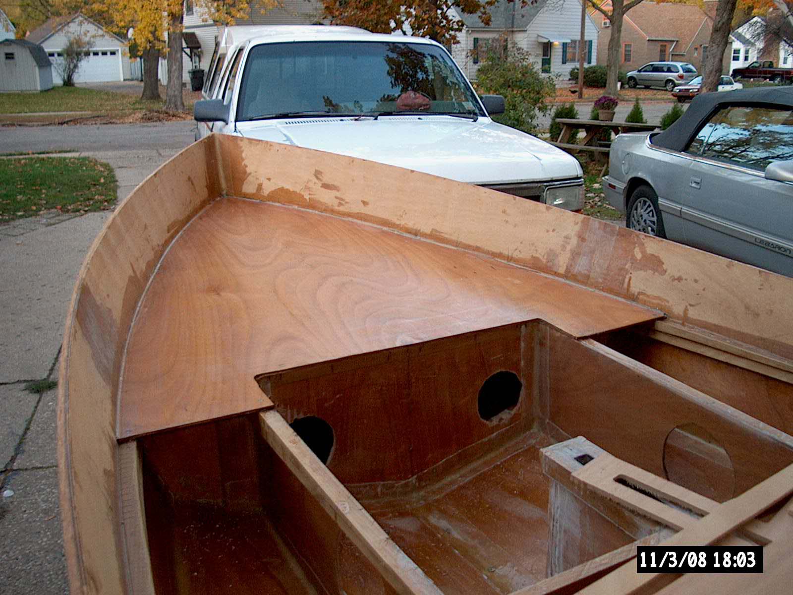

Greg Luckett Posted November 2, 2008 Author Posted November 2, 2008 Foredeck seat dry fitted, and next will be the access port holes to be cut and the side seats. I am thinking of a Griffith hatch on the foredeck for anchor and line storage. Quote

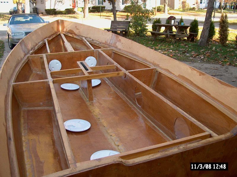

Greg Luckett Posted November 2, 2008 Author Posted November 2, 2008 Seats are now dry fitted and ready for installation. Ben and I worked most of the afternoon and are bushed now. We need more hardner too, so off to the store tomorrow. Quote
Greg Luckett Posted November 2, 2008 Author Posted November 2, 2008 Someone may have noticed that I am not exactly following Graham's design for the seat shapes. I did not like the 6 in curves at 6 of the 8 corners, but prefer very small, maybe 1/2 radius or less, corners. Less places for spiders to lurk where fingers and hands are grabbing and easier to fabricate too; just the router edge trimmer is needed. This week I plan to cut in the inspection port holes, install the dry fitted seats, and fabricate the two knees for the transom to side corners. I plan to hinge the aft seat to enable a battery to be installed and removed easily. I may call it a winter at that point and store the boat until next spring under tarps in the back yard. Quote

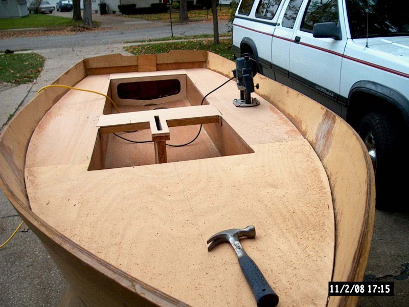

Greg Luckett Posted November 3, 2008 Author Posted November 3, 2008 I used a RotoZip to cutout the inspection port holes, then vacuumed, then some touch up sanding, then more vacuuming. Then the foredeck was positioned again, some screw holes located and countersunk for #8x1 inch siliconized bronze screws, then the bottom was coated with epoxy. It surprised me as to how much it soaked up. Next was epoxy with filler applied in the boat at each of the places that the foredeck would sit, then laid the foredeck back on, screwed it down in place, then epoxy coated then foredeck top, then filled the edge seam with epoxy/filler. At this point I need more hardner but the store is now in the winter hours and was closed today. Quote

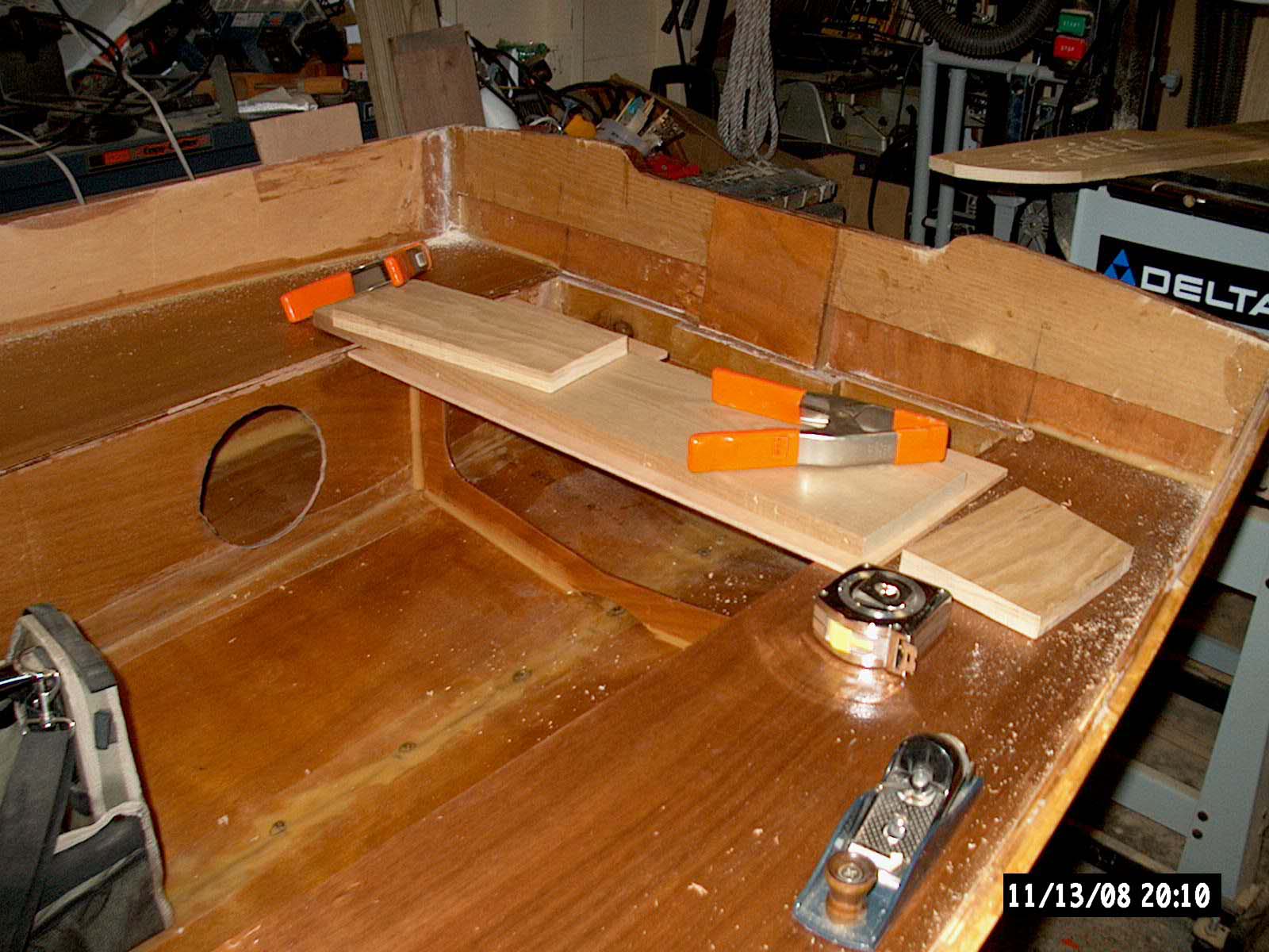

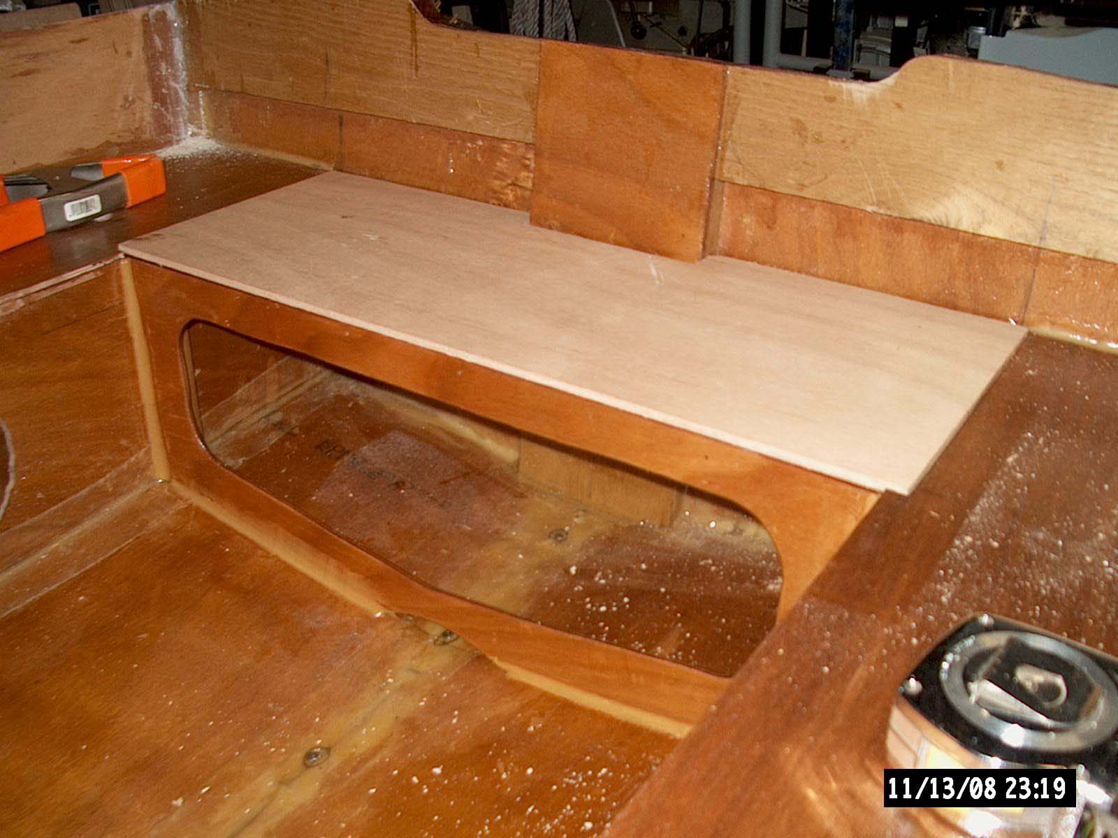

Greg Luckett Posted November 14, 2008 Author Posted November 14, 2008 I have been busy making more details, such as the quarter knees, the bow reinforcment, and a removable aft seat for battery installation, as well as finishing up the gunwhales. Quote
Ken_Potts Posted November 14, 2008 Posted November 14, 2008 Still looking great Greg but you need more clamps ;D Does the aft seat just slip down into place or is it semi-permanent (how often will you need access)? Quote

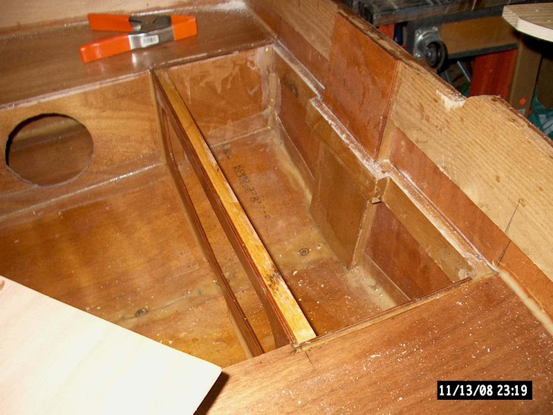

Greg Luckett Posted November 14, 2008 Author Posted November 14, 2008 Thanks Ken, and you are right; I do need more clamps....never, ever, enough of them! Ben and I have been debating how to do the seat. One method would be to install a couple of hinges by recessing them into the seat beam at the front. The seat would then swing up towards the bow and latching would be done near the transom. The other method, and the one we like the best is to just use some pan head screws to fasten the seat down, only removing them when installing or removing a battery. We both like the second method best. The seat panel will be reinforced with stringers to help it keep its shape since it will not be glued down. I took some better pictures to help visualize this. Quote
lbrewer Posted November 14, 2008 Posted November 14, 2008 It's looking good Greg! Are you going to put hatches of any sort on the seat tops?...or just use the inspection ports for access? Quote
Greg Luckett Posted November 14, 2008 Author Posted November 14, 2008 It's looking good Greg! Are you going to put hatches of any sort on the seat tops?...or just use the inspection ports for access? I hate wasting the storage space but dislike even more giving up the floatation, so no hatches on the seats or foredeck. Another builder (cannot recall who it was) did put hatches on and after doing so said they wished they had not due to the leaking. I have some 10 or 12 inch inspection ports that I could install on the foredeck and may do so in the future. That would be a good place for anchor road or spare lines and gear. The ports that I have already cut are more for keeping the enclosed areas dry while sitting on the hard, but are also big enough to store items under the seats. Thanks for the compliment too! Quote
lbrewer Posted November 14, 2008 Posted November 14, 2008 I hate wasting the storage space but dislike even more giving up the floatation I am having the same thought. Although there isn't a whole lot of under seat space in the nesting version anyway, I'd like to be able to utilize what is there. Quote
