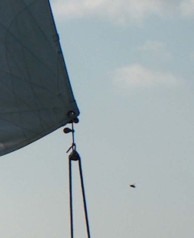

wkisting Posted September 17, 2008 Author Posted September 17, 2008 Another question: How do the single blocks attach to the end of each sprit for the main and mizzen sheets? Am I supposed to have stainless hooks for those too, or do they attach to the sprit some other way? Quote
wkisting Posted September 17, 2008 Author Posted September 17, 2008 Aha! Thank you. I like the idea of a bowline/stopper knot attachment, as it seems the cordage would be a gentler, lower-stress connection than a fixed eyestrap.... though it probably doesn't make much difference since several folks have suggested there are relatively minor loads on the ends of the sprits in this setup. Quote
Charlie Jones Posted September 17, 2008 Posted September 17, 2008 Graham uses the line through the sprit, tied to the block- here's a very enlarged pic of his mizzen sheet and sprit Quote

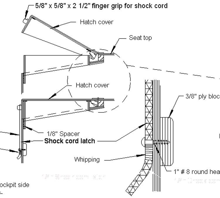

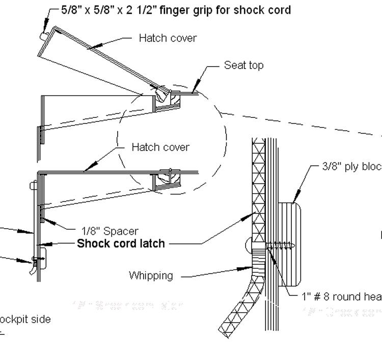

wkisting Posted September 18, 2008 Author Posted September 18, 2008 I know I've asked this before, but I can't remember getting a response and can't find it on this thread... What do folks use as a latch/hasp to hold down the DECK hatches? Any pics? I'm considering screwing a small SS metal lip to each hatch cover and creating a mahogany knob/turnbutton on deck that will rotate over the lip to hold the hatch down. But I'm wondering if there is something easier, simpler, and/or commercially available that works well as a hold-down. Quote
wkisting Posted September 19, 2008 Author Posted September 19, 2008 Any responses to my question in the previous post - about deck hatch latches/hasps? Wheeled the boat out into the sun today for some baking to make sure the epoxy is fully cured prior to varnish. Took these two pics: Quote
paul_stewart Posted September 19, 2008 Posted September 19, 2008 Regarding Hatch Latches: Wes, Here are a couple of picture of the latches on CS20 #103..... Quote
Richard Whitney CS#70 Posted September 19, 2008 Posted September 19, 2008 Wes To hold my hatches shut I attach a plastic hook or ring to the inside of the top of the hatch. Inside I had a plastic hook attach to the inside of the compartment with a length of shock cord. To close you just pull this tight - hook it into the hook/ring on the inside top of the hatch cover and let go - the tension hold it shut with no fittings visible from the inside. To open you pull the hatch open abit - put your hand inside and unhook the shock cord. Works well. Quote
Richard Whitney CS#70 Posted September 19, 2008 Posted September 19, 2008 Wes Here is another post from Joe Nelson from awhile ago explaining the same thing. Try using shock cord under tension hooked to the underside of the hatch. If you install an eye strap to the underside of the hatch and a hook on the shock cord...attach the other end anywere you can get downward tnesion...you can lift the hatch and unhook the cord to fully open the hatch. Then no exterior latching hardware is necessary. Quote
wkisting Posted September 20, 2008 Author Posted September 20, 2008 Paul, I've got the seat locker hatches figured out (using a metal hasp that can be locked with a padlock), but I'm wondering about the hatches on the fore and aft decks. Richard, thanks for the suggestion. I know a lot of kayakers who have used that method to hold down kayak hatches but I've always been skeptical about the convenience of using something that you have to reach inside to "unhook". Of course, I don't plan to use the deck hatches very often on our CS20 except on trips where we need the storage, so perhaps this is an ideal situation for that kind of setup, not requiring frequent access. I do worry a bit that the downward force won't be very strong to produce a seal, since there must be enough slack in the bungee to allow you to get it open far enough to insert your hand. Have you had any trouble with leaks in rough conditions? Quote
Ken_Potts Posted September 20, 2008 Posted September 20, 2008 I used the method Richard describes to secure the foreward hatch. I attached the secure end of the shock cord on the forward bulkhead near the bottom of the boat. That way it is a long cord that doesn't have to stretch much in relation to its length when the hatch is pulled open. As far as I can tell I've never gotten a single drop of water in the forepeak even though I've had plenty of water on the foredeck. I only access the forepeak when I'm looking for a pfd or an anchor. I've never felt that reaching inside to unhook the shock cord was an inconvenience. Quote
