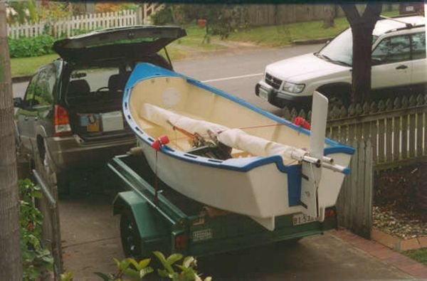

I use a standard 6*4 box trailer for an 11ft 4 inch dinghy (Welsford Golden Bay dinghy - shortened). These trailers can be had second hand pretty cheaply- at least here in Australia. I use the trailer for general purpose as well so just sit the dinghy on top which makes it a little high, so lifting it on is a little more difficult, but quite manageable.
Here is a pic.
Peter HK
