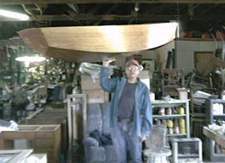

LOL- No bricks for sure. I should tell you I cut my boat building teeth building multihulls and I still have a fear of adding unnecessary weight. Unnecessary weight in the construction does NOTHING good for the boat, just makes it heavier and cuts the payload.
Just as an example- here's my Minipaw before the seats went in :lol:
