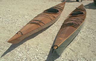

These two yaks were at the last Duckworks Messabout we attended- they are glassed

I have done brightwork before on a kayak... I wasn't sure, though, if it works the same way when using ply... (cedar wets out really nicely, but I noticed when building my ply Pocket Cruiser that the layers tended to look a bit milky in a lot of places instead of glass-clear like the 'yak... maybe it was the glass I was using... didn't matter anyway since I painted the Pocket Cruiser).
Anyway, sounds like the same process I used to finish my cedar strip 'yak (all bright). That's encouraging.
