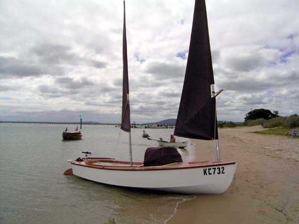

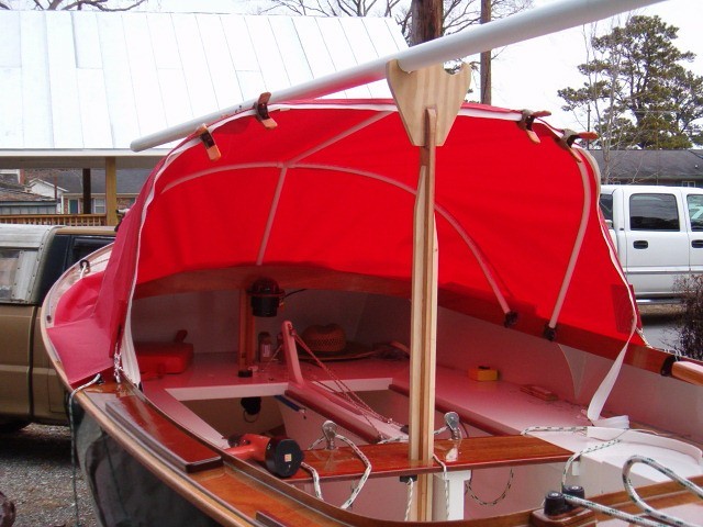

Here is a couple of picks of my dodger being made.

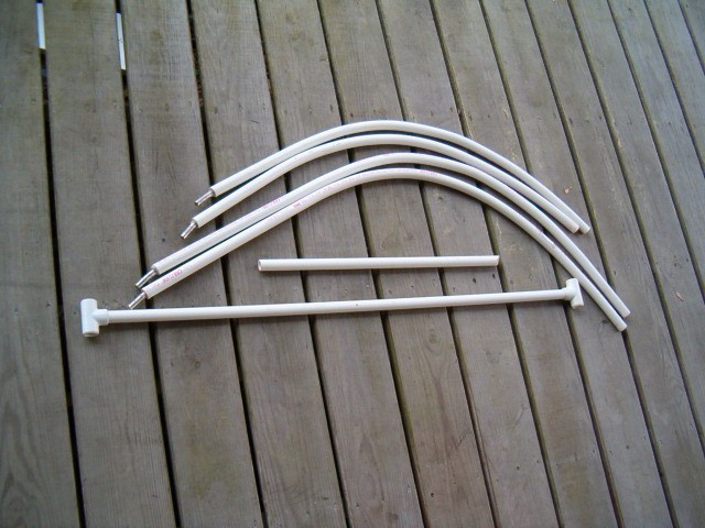

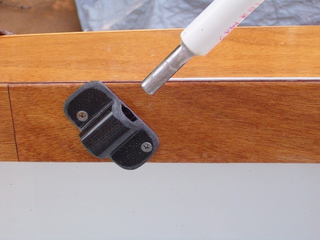

The frame is 1/2" PVC with 3/8" ss pins glued to the bottom ends. The pins fit into epoxy/glass shop made fittings that resemble side mount oarlock sockets made by Tom Lathrop. The cover is made from 1.5 oz. ripstop nylon that I already had.
The front end has a sewn in boltrope that slides into a 6' length of PVC flexrail. The sides clip on with Dot fasteners. The back end zips onto the main cover and has a no-seeum screen which I hope will be bug proof when I put in a pair of under deck ply gussets to close off that area.

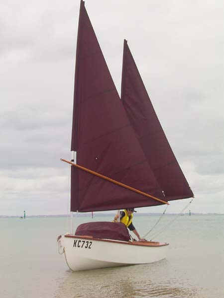

I went for a low profile dodger so that I could sail with it up. I just have sitting headroom at the aft end and have found it to be very comfortable.
Looks great Graham. I was envisioning something similar for mine someday. Did you have to heat the PVC to make the bends? I was planning on snaps that attach to my cockpit coming --- any problems with that idea?
Thank for the pics. I can't wait for my firsy night in CS17!
Tom
I drew out the curve I wanted on a sheet of ply and clamped a 1x2 against the PVC and used my heat gun to soften it where I wanted the bend. You need to to be very subtle with the heat as once the pipe becomes plastic it has no stiffness at all and is easy to deform. Just keep moving the heat around so that you don't burn the pipe and to get it to bend where you want it.

Nice! Is the frame collapsable?

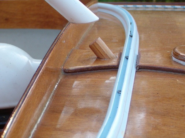

Is the flexrail attached to the coaming, or does it stay there because the sides are attached to the coaming? Actually, I'm not sure what a flexrail is. Does it have a track, similar to a track in a mast?
Charles
I just checked the catalog, it is called Flex-a-rail. It is just a PVC track extrusion. It is inexpensive and light.
The two bows join at the center with tee's which are glued to the top fore and aft piece. the whole lot comes apart and stows easily in a forward side locker.
The Flex-a-rail is screwed down to the deck in front of the coaming. I increased the gap to the coaming at the center to make room for the forward center PVC strut which fits over a dowel that was drilled to the front angle.
The picture shows the forward strut fitting over the dowel. The track was installed in front of the strut.
Very nice, Graham. I've been waiting to see your dodger/cabin design. I like the flexibility of being able to sail with it up. How high could you make it on a CS20 without catching the foot of the mainsail?

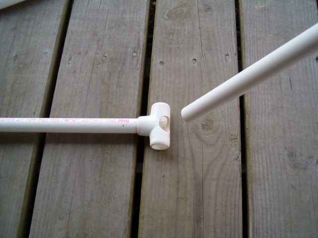

And another request.. Could you take some close ups of all the 'detail' points ie the attachments to the coamings, the way the bows clip together etc?? all the little fiddly bits in other words.

Rob,
The bits are not that tricky. Beside the 1/2" pvc there are only two T fittings with a hole drilled at the appropriate angle in the forward T to accept the front vertical pipe and the 3/8" stainless rod for dowel pins. The pins were bent to the correct angle and then taped with glass and epoxy so that they would fit into the pipe.

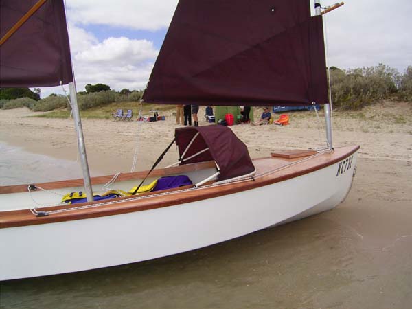

Here are some photos of the dodger/cuddy that I made for CS17 #122, Kirsty Ann. We wanted something that could fold down out of the way when coming in to a dock or making our way through crowded waters, and could keep the kids out of the wind and water at a moment's notice.
After a few month's thought, and a couple of abortive attempts, I finished up with a cover sewn in 4oz sailcloth, using pvc tubes shaped with a hairdryer.
It works well for the kids, but I have to crouch a bit to get under it. This was a compromise - I wanted to still be able to see where I was going when it was up, so it couldn't be made too tall.
