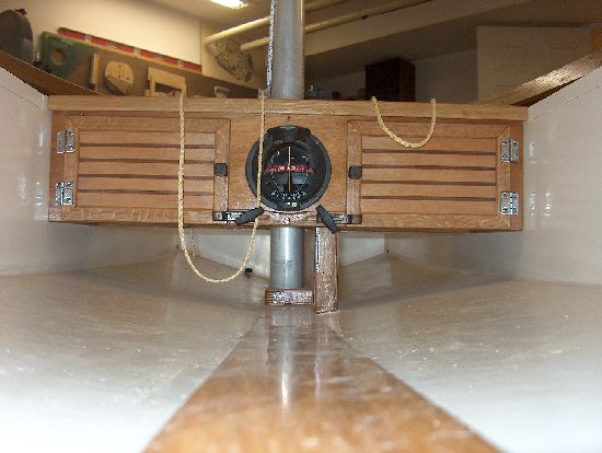

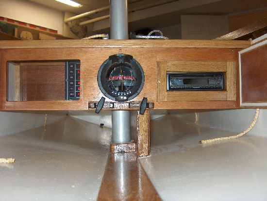

  23. Hi Dale, Glad to hear your making progress. Here's a couple of shots of my thwart. I started thinking a mini bulkhead was the ticket for a compass mount. It grew into a mount for a radio (my wife's requirement) and a "glovebox" which contains my switch panel for the electrical. It was a challenge to build this (I put in a mini mast drain tube) but, It looks nice and will be handy for the 3-4 day cruises I'm planning. Tom

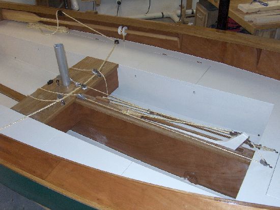

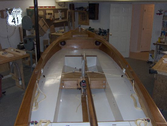

  24. I've got CS17 Hull #129 getting close. Masts and spirt booms are complete, varnish is done (almost), hardware is mounted. I'm building floor boards for the forward cockpit this weekend. After that, mast cradles for trailering, a boarding step on the transom and ??? (I'm sure there's more :roll: ). I'll be ready to transfer from the building cradle to the trailer in April! Here's a couple of pics.
