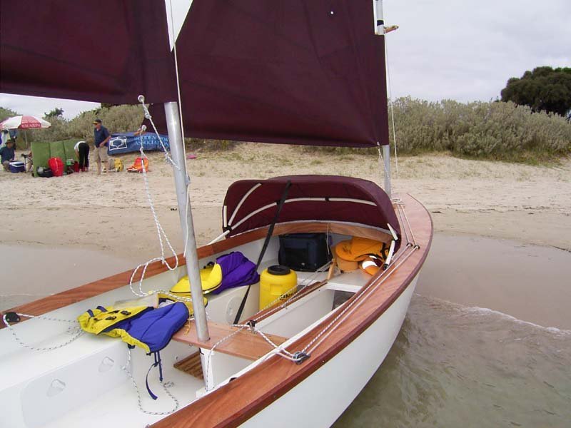

The time has finally come to build the next boat (a CS17 Mk3) , but in order to do this I need to sell the one that currently lives in the garage I will use as my work space. Kirsty Ann (CS17 #122) was launched in January 2006, and has provided years of safe and enjoyable sailing on Albert Park Lake, Port Phillip, the Gippsland Lakes, and the Nooramunga Marine & Coastal Park. Her shallow draft meant that we were able to sail up the narrow and shallow channels between the islands behind Wilsons Promontory to camp in some beautiful and remote locations. The boat is coated in BoatCote expoxy, with fibreglass sheathing on the lower chine. For a very low-maintenance finish, she is painted in white Aquacote, with the deck painted in clear Aquacote. A folding cuddy provides a bit of protection from the weather if needed. When stored, the masts lie on crutches that fit into the mast steps. Registered until January 2019, Kirsty Ann is being sold on a Dunbier trailer (registered till December 2018, and comes with a spare wheel), with a Honda 2HP long shaft air cooled outboard, and all the necessary safety gear, including lifejackets. Price: AUD $6500. You can contact me at peter@batchelors.net. Cheers, Peter
