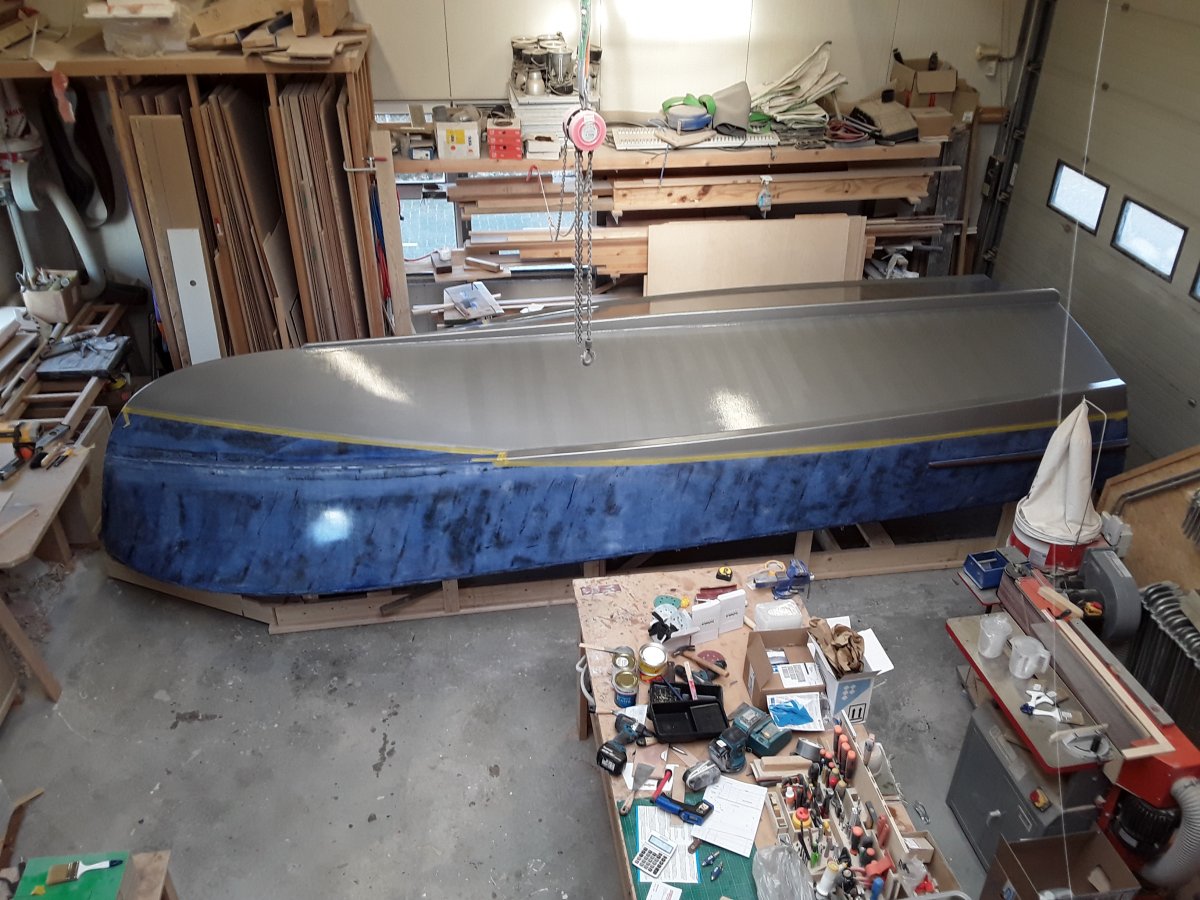

Your boat is looking amazing.
You've pretty much caught up with me in as many months as I have spent years.  I underestimated you from the beginning...thinking you'd be slogging along like me.  Wishful thinking for a compadre, I guess.  Not the first time I gross!y underestimated someone, though.

Hi Jan
Boat looks a big 20 footer in your workshop, good to see you making way at a nice pace.
Out of curiosity, what made you choose the kevlar to sheath the hull?

Hi 1bigcarrot
I chose this kevlar / carbon fabric to use the following reason
1 less weight
2 much stronger than glass
3 more inpact strength
Jan,
I notice that you kept the outside keel high all the way to the transom. The reason why we drew the keel ending .331 from the transom and tapering to its full height well forward of the transom is to prevent cavitation during turns while planing.
As you have built the keel you should be ok at planing speeds running straight and long slow turns. It will cavitate when turning at speed.
I normally like to do the keel as you have built so that I can support the boat as far aft on the trailer as possible. I find cavitating more annoying, not to mention what it may be doing to the engine.

Graham,
In my area there are only 3 spaces where you can go faster than 12 miles. You also need a permit and I do not have one
For this reason the boat also gets a motor with 10 horsepower and I do not think that I get problems with cavitation
