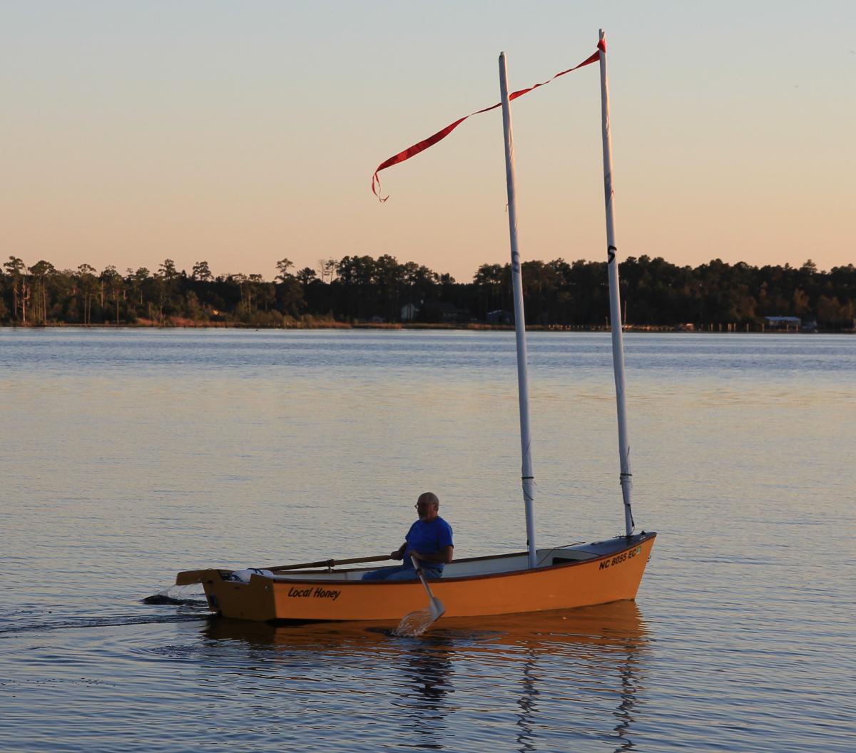

I will try, Amos, but I've had a darned difficult time posting photos on this forum, lately.  Here's one that Graham took last fall. I'll try to get a good detailed shot tomorrow.
