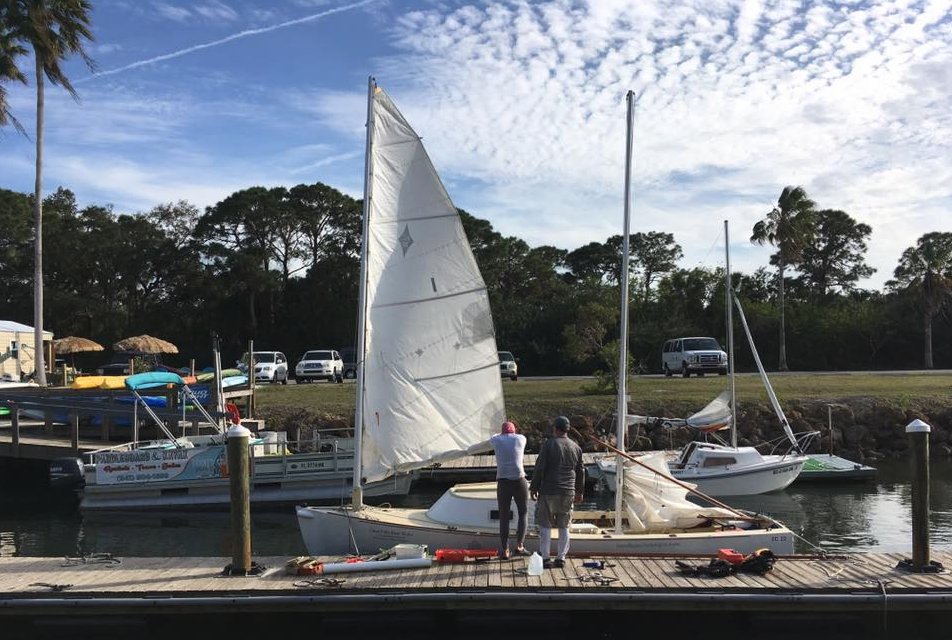

Seuss Posted March 5, 2017 Report Share Posted March 5, 2017 EC 22 having a rough day. "If it doesn't break it's too heavy" Quote Link to comment Share on other sites More sharing options...
Joe Anderson Posted March 5, 2017 Report Share Posted March 5, 2017 Oww that must have hurt. Do you know any details. Quote Link to comment Share on other sites More sharing options...
Docpal Posted March 5, 2017 Report Share Posted March 5, 2017 Latest posting on FB shows them working on a jury rig- https://www.facebook.com/pcolaboy/videos/pcb.1184570241661422/1566714233371329/?type=3&theater Quote Link to comment Share on other sites More sharing options...
Docpal Posted March 5, 2017 Report Share Posted March 5, 2017 She is almost a schooner at this point, great recovery !!! Quote Link to comment Share on other sites More sharing options...
Tom Lathrop Posted March 6, 2017 Report Share Posted March 6, 2017 The weakest point of any unstayed mast is where it exits the deck or,in this case, at the connecting point of the tabernacle. What you are looking at at the stub on Southern Skimmer ( if my memory is correct) is an insert made with a double layer of carbon weave over a foam mandrel. The break appears to be at the end of the insert which was inserted to reinforce and distribute stress away from the exit from the tabernacle. Since even a double layer of carbon weave is not nearly as stiff as the aluminum mast, it was thought that this was a good idea. The fact that the greatest load would be at the bolt through the mast on the tabernacle, it seems strange where the break occurred. Has the aluminum mast suffered any physical or chemical damage at this junction? I would like to see the result when they get home. This mast has survived some severe loading in rough conditions since it was built. Temporary running side/back stays are used when the spinnaker is flying. Quote Link to comment Share on other sites More sharing options...
Mike Vacanti Posted March 6, 2017 Report Share Posted March 6, 2017 Alan posted a YouTube video and he explained that the mast failed due to severe corrosion. It looks like water was held against the mast at the point where the reinforcement ended. Here is the video: Mast failure Quote Link to comment Share on other sites More sharing options...
Tom Lathrop Posted March 6, 2017 Report Share Posted March 6, 2017 I was suspicious of that and maybe we should have foreseen the possibility of salt water puddling at this point. It is one of the issues with using non anodized aluminum for masts. A drain might have prevented the failure but, who knows? May need to rethink how stress relief is engineered. Just having a thicker mast section would not have failed without any reinforcement but weight, especially aloft is always a bugaboo. Quote Link to comment Share on other sites More sharing options...

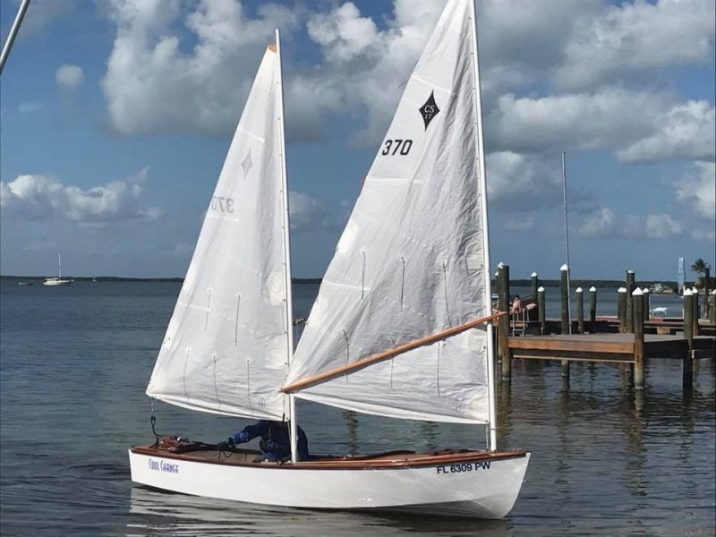

Seuss Posted March 6, 2017 Report Share Posted March 6, 2017 From the Watertribe Facebook page . . . Here's swimboy's CS17 coming into check point #2 (or #1, depending on how you're counting) in Chokoloskee That's a pretty boat 1 Quote Link to comment Share on other sites More sharing options...
