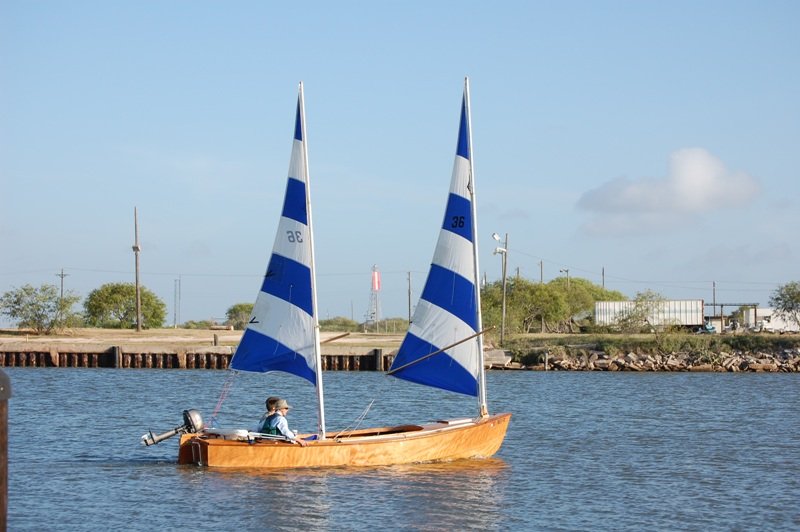

I have a bimini on my CS 20. I have standard sails, no battens. No stay sail. With the 22' mast my mizzen clears the bimini. We have not used the bimini much and I don't have a picture under way with the bimini up. Here is one with the bimini folded down.
Interesting. On #36 my masts are both 22'. I have standard sails. Lots of room to look under when they are raised to the top. On the Texas 200 at one point we had two reefs in both sails and had the main brushing the deck. Other times without reefs we had the sails pretty low for stability. After we passed where the ferry crossed in the Coupus Christi shipping channel we about ran into a dock because we had the sails low and forgot we couldn't see through them. After that we paid better attention to the blind side when we had the sails lower to the deck.
