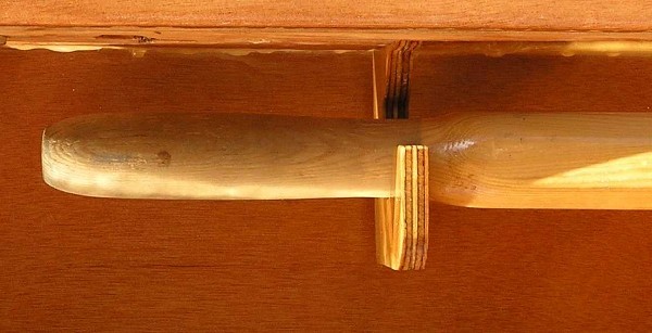

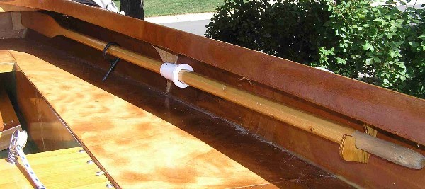

  11. In order to have a place to put the oars when they are not in use and yet have them readily available I hung them under the side decks. The oars are spoon blade spruce 9' long.
