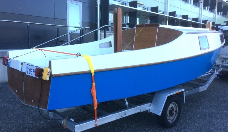

Well, here she is guys. Still some work to do but off on her first trip outside of the garage to get a hull identification number. The re-built trailer looks ugly but seems to work fine, so will do for now.

No, that's just shade that looks like a stepped transom. My lovely wife doesn't claim to be a great photographer and got the tree et al in the shot. I will, however, take a pic of the transom area and post it. I have built the transom strong, from 3/8 ply, and have enclosed the ends of the seat back "tunnel" by continuing the transom up to that height. At the bottom panels I planed a chamfer and filled it with an epoxy and flox mix as I glassed the bottom. That way I could have a strong but sharp trailing edge on the bottom. Then, when I glassed the transom, I just carried it over the filler so that glass from the bottom and transom meet at the sharp edge. This should make for minimum trailing edge drag at the stern as well as resist damage to the ply structure.
Wow, you ARE a fast worker. Good luck with the project, your work looks neat and accurate.
