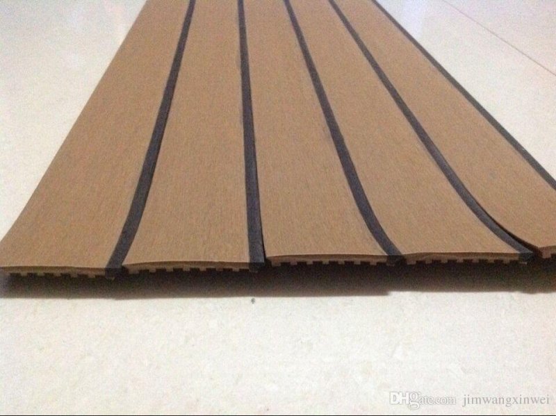

  13. Synthetic teak ready ! I went for the King-plank type but but with pointed corners for more modern look . Thanks for all your opinions guys , it made a difference ?
  14. I made some cardboard drawing for the decking I like the kingplank design and is professional but it looks too classic for this boat The herringebond type looks fine but for some reason I cant place the center line ( where planks meet ) in the center !! Not sure about the other 3 designs ? ???
  15. I`ve decided to cover the front deck (passage), the 2 steps and the driving platform with synthetic teak . the advantage over solid wood is its lightness and it is maintenance free ! But still confused which strip direction looks better for my boat !! Any thoughts are much appreciated ?
