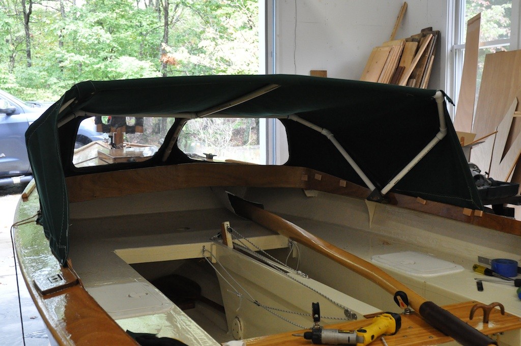

  6. Hi Wes I am working at a camp in the NC mountains and have little internet access. Here is an attempt to send you notes on the dodger and floorboards I made for our CS 20 with large sail option.
  7. I bought the frame from Sailrite. It's stainless instead of aluminum (stronger). I sewed the material out of sunbrella and the clear plastic for windows that Sailrite sels. You order a wider frame and then cut it down to fit. One thing I didn't get done in time is to put a zipper around one of the front windows to give better access to the front deck. When the pad eye for the snotter came out of the mast (ss screws were tapped into the mast and stripped the threads in the aluminum mast) in the night off the Everglades, I had to step around the side, holding onto the dodger top, to build a new mast attachment out of line. (The final fix when I got home is a bail like is sometimes used for a boom vang or mainsheet. That way the screws are having a sheer force rather than the in-line force that stripped them out.) I hope this helps.

  14. http://www.thewoodenboatschool.com/catalog.php Graham will be teaching small boat design at WoodenBoat School this summer. Check out the catalog at this address.

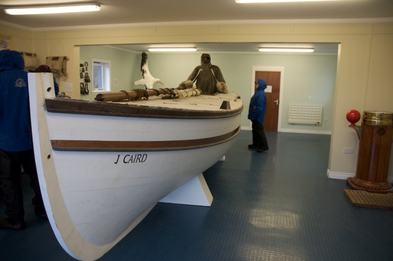

  17. Full sized replica of the James Caird at Grytvicken, South Georgia:

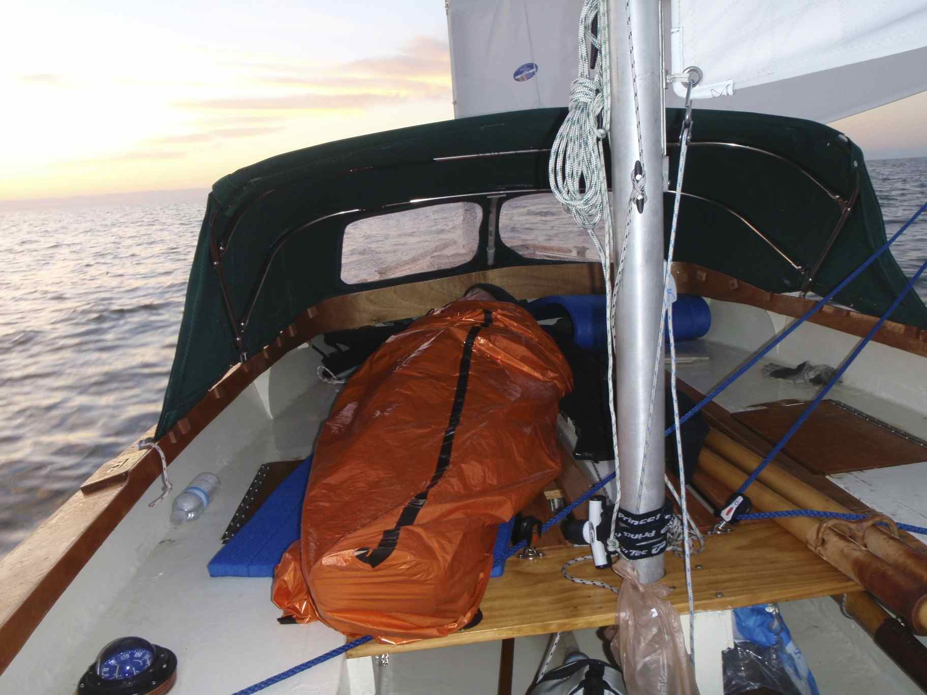

  18. I did a dodger on the standard CS20. I am modifying it in 2 ways: adding zippers to the windows to have access to the main w/o going forwars (to reef, etc.) and replacing the PC with a standard stainless frame so that it will lie down assembled and attached to the foredeck. I found this did a wonderful job of keeping the boat dry in a choppy reach or beating, and we could sleep under it with only our feet exposed. It would make a dry cooking spot at anchor.
