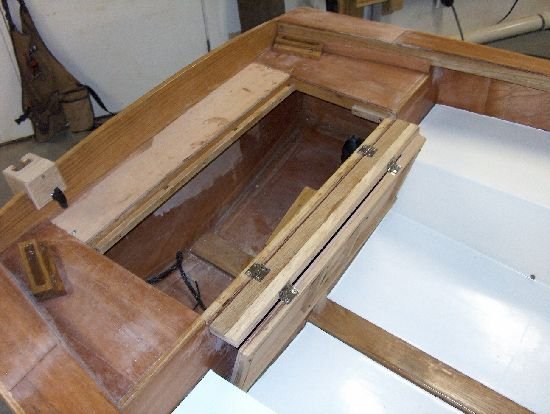

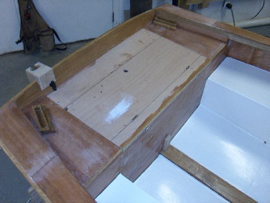

I did a raised seat approach on my CS17 with the large folding hatch, I've got great access for my ice box (presently under construction), my trolling motor and the battery. I believe the seat will be my favorite perch when sailing next summer! I'll post some finished shots in a couple of weeks. I found mocking things like this up with cardboard and duct tape is a good first step. Seeing it in 3D really helps sort out questions like you're having! Good luck. Tom

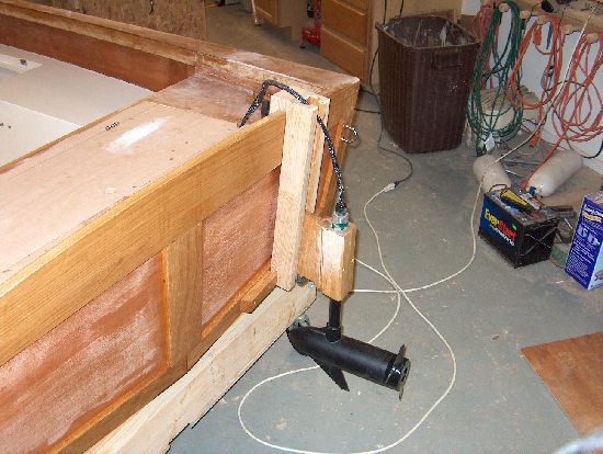

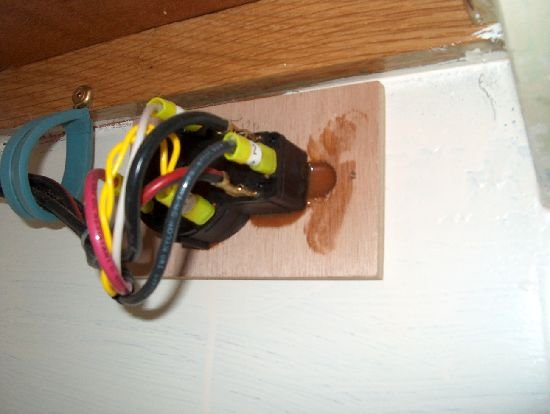

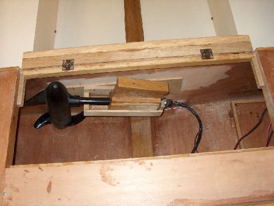

Thanks for the comments. I epoxied the controller (a pot w/ detents) to a piece of 1/4" plywood and have that screwed a seat side. The attached shot is from inside the aft seat locker. It's accessable if I ever need to replace the unit. Right now, there's a 1/8" shaft protruding from the seat side. Before I'm done I'll turn a small oak knob. I tried hard with the battery, controller, motor location to minimze the wire length and, to use heavy gauge wire to minimize resistance. It should work fine and, it was easy to do. I'll report on my results --- hopefully this summer! Tom

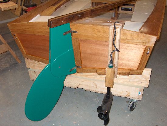

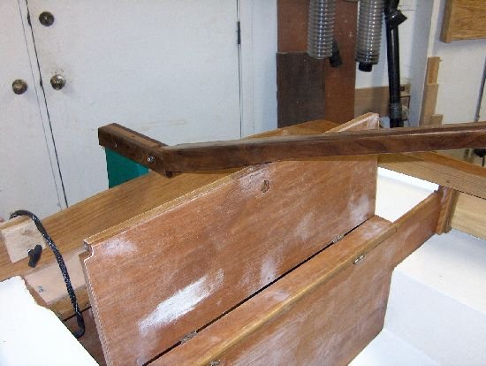

I haven't posted pictures for a while so I decided it was time. Summer has slowed down my building but I'm still hopeful I get to the water before it turns solid (yep .. I'm in Michigan). Here's some shots of my lazarette and the approach I took with my trolling motor. I cut the shaft on a Minnkota trolling motor and made some mods. The controller is mounted under a seat and will have a small turned knob to control the speed. I think it will work pretty good. This weekend I started the rudder and tiller. The tiller will be hinged to allow the lazarette to open. I'll post pics of that in a week or two. Happy sailing! Tom

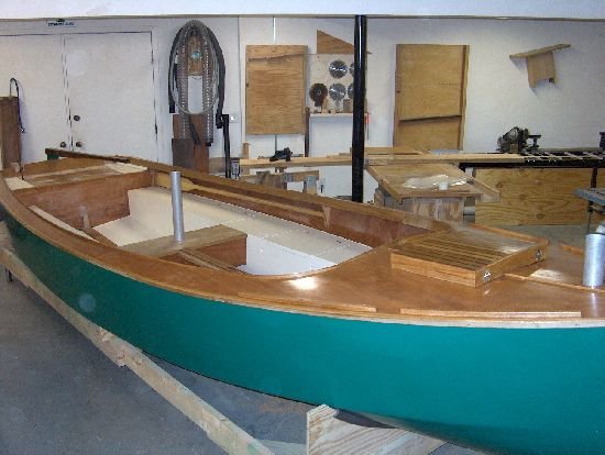

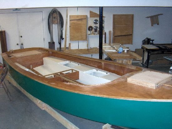

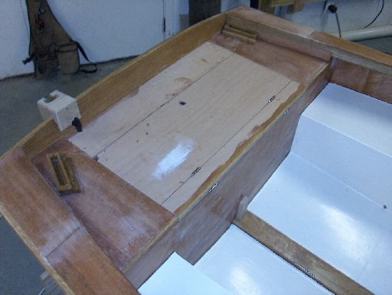

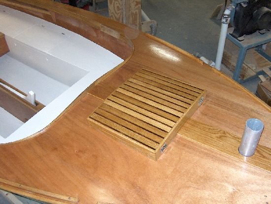

Hi everyone! Sorry for not posting any info for the last couple of weeks but ... (no good excuses come to mind). It's hard to put a lot of time in on the boat with the weather so nice but I've managed to squeeze in a few hours. I absolutly have to make it to the water this summer! The idea of sailing this summer is keeping me going. I can't wait to post some sailing shots! In the last couple of weeks I fitted the cockpit coaming, fabbed the rub rails, and built my deck hatch. This weekend I got the forward deck fit and temporarily screwed down. Heres a couple of shots. Keep on building! Tom
