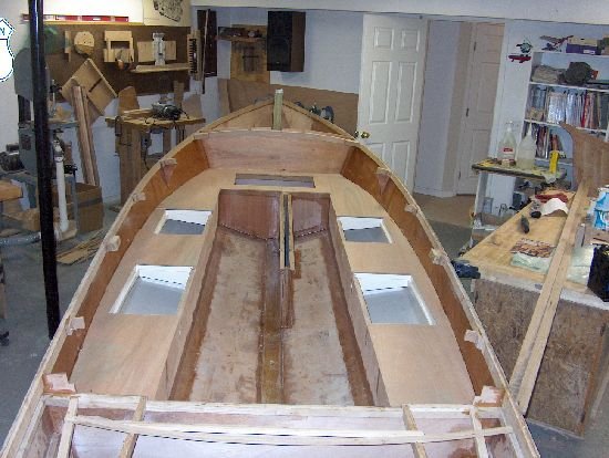

  3. Hi everyone. I haven't posted any pictures for a while so I here goes. I've made good progress over the last couple of weeks but my free time is getting scarce. Here's a short description of what you'll see in the pictures: Thwart: As I mentioned in an earlier post, I got a little carried away with this one. I started with the idea of a short bulkhead under the thwart to mount a compass. I ended up with a mini-locker that currently has a switch panel installed. I'm going to build a panel with two fold down doors (kind of like a glove box) Forwad mast step: I got the mast step epoxied in and the mast tube fitted. The housing shown has pocket to collect water and route it through the hose and SS tubing back to the cockpit. Deck Framing: The deck is framed in. I've got a plan to build a curved (to match the deck) deck hatch. I'll post pics of that in the coming weeks. Oars: I ended up buying 7' oars. I know they're shorter than what Graham recommends but, that's all I could fit in the space I had allocated. I'll have an electric trolling motor as the fall back to the wind so the oars should be emergency only propulsion. I ended up with a bracket system to hold the oars that seems to work pretty well (at least in the basement where I've been sailing). Hardware: Graham sent me a bunch of hardware - Thanks! Tom

  6. Looks great Scott. I'll be framing the forward deck structure in the next week or so. I've thought through the deck hatch but haven't yet started to sketch it. If you have any details on how you're going to attack yours, I'd love to hear about it. I got the thwart and mizzen mast step built last weekend. I got a little carried away. I wanted a small bulkhead aft of the mizzen to mount a compass. It ended up being mini locker (glove box?) that will house a radio and also a small switch panel (deck lights, aux power, etc.). The nice thing about calling this a hobby is it doesn't have to make sense :wink: . I'll get some picture this weekend. Tom

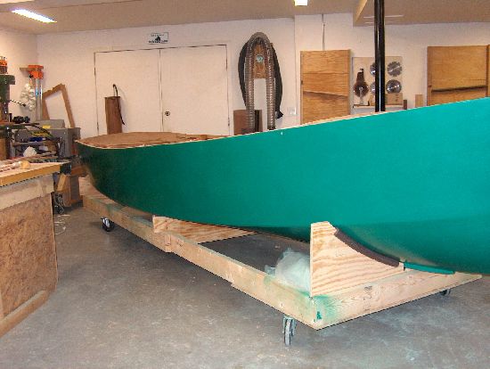

  10. The flash on the camera makes the paint look a lot lighter than it really is. I used about 1.5 quarts of "Mercer Green". I rolled and brushed on the first coat and then sprayed on the second and third coats. I painted on a Sat and Sun. and then sanded and buffed it out on the following Tuesday evening. Dale --- Thanks for the photo. Good luck with your CS17... It's a great project! Tom

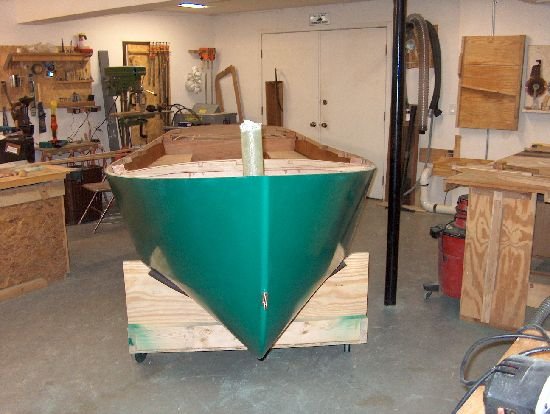

  11. I haven't had a chance to post status or pictures in the last couple of weeks so here I go! I got the hull painted. I ended up using Systems 3 water based two part polyurethane paint. It went on well and dried very quickly. I very much appretiated the fact it was water based - It made painting in the basement tolerable and clean up was easy. I recommend the paint! The boat is now right side up and I made the mast tube and started the deck framing around the cockpit. The seat tops are trimed to fit the hull but have not yet been glued in or trimed flush with the seat sides. I'm putting that off until I get a few more thing done. Tom

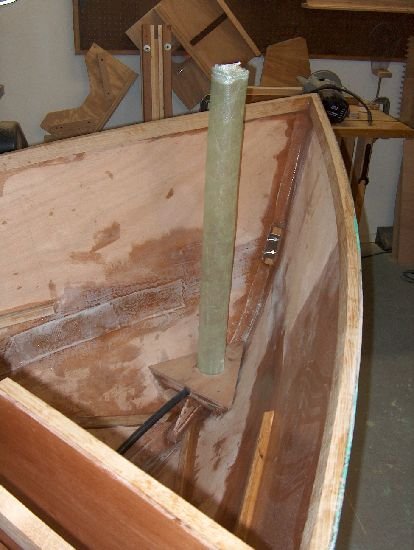

  13. I just made my mast tube this weekend. I used the 4 wraps of 6 mil plastic but did it in two pieces. I taped the pieces using plastic packing tape. I wrapped the mast section/ plastic using 10 oz tape with about 1/2" of overlap. When this hardened I wraped it second time with some of the 6 oz. continuous cloth I had left over from the hull glassing. When I dissassembled the mess, the two plastics slid away from each other (one stayed on the mast, the other tube). I had to wrestle the plastic out of the tube. I did this by grabbing the ends and twisting. The plastic rolled up on itself and broke free from the epoxy. It was no big deal but I should have used some virgin plastic. The piece I used had been around the shop for a while and wasn't as smooth and slippery as it should have been. The tube looks great. I'll post pictures when I get a chance. Tom
