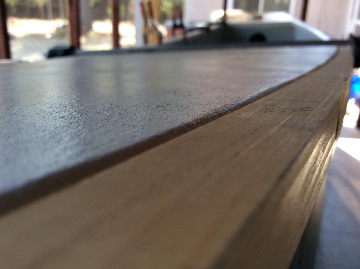

I'm curious about PAR's method of using the gap between the coved and squared edges as a caulk seam. Am I to rely on squeeze out? If so, how do I keep the goop out of the weave, off the bright rail, and nice and full and smooth? I think a solvent wipe would leave a small cove in the top of the caulk, which would be less than ideal, here, I should think.

Tape everything off on bright finishes. You don't need to use the ooze out, but it's handy when it's there. I don't use solvent wipes as it often does as you suggests, but more importantly causes the surface of the goo to cure more quickly than the full bead and this can cause cracking when everything does eventually cure. As to the color, it depends, I usually go with a contrasting one, so you can see when it needs to be renewed, but sometimes I'm simply trying to hide the seam, so a matching color makes sense.

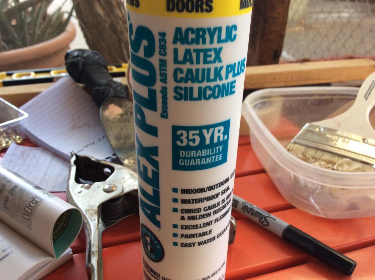

I've seen this stuff but don't have a lot of data on it other than the usual tech and MSDS sheets. It's an elastomeric, so you can paint over it, but alkyd paints will probably have a reaction without a primer, though is fine for acrylics. It's not recommended for immersion and it doesn't "tool" as well as the polyurethanes.  It also doesn't seem to tolerate a lot of movement. It's a "spirits" clean up goo, so that's no fun either. When I look for a new caulk type of product, I key in on the label and the terms; waterproof, mold and mildew resistant, paintable, etc. If it doesn't have these things on the label, I don't consider it.
Commonly available stuff is from DAP and it's their Dynaflex 230 series. It's waterproof, mildew resistant, good flexibility, is paintable, tools easily, etc. All the big box stores carry it. It's not recommend for total emersion, but all of the acrylic urethanes will have this disclaimer. Another option is DAP, Premium Construction adhesive. This is a polyurethane and though cures a bit stiffer, has much higher tack, yet is still waterproof and paintable, though is solvent cleanup.

Anyway, I used this to seal up a dumb little pirogue we made from plywood to beat up. Ain't beat it up yet, and the goop is still gooping. This boat is stashed in the wild, so no kid gloves, here.
Not a pro, and not recommending it, yet, but it meets all PAR's criteria, it was free to me, and I have used it before. I plan to use it on my rub rails, which I chickened out on the flush mount deal. I'm setting them down about 1/4 inch from the deck...
Apparently I'm not the yardbird guano I imagined myself to be. Once I clamped them flush, I just had to leave them.

Oh yeah, noted. I'm going to leave them screwed in place for a few days to take a little set, then I'll stick em on.

There are only 2 places I would ever use silicone or a goop containing it:  glazing acrylic or polycarbonate and to fill the spaces for teak decking.  Once silicone contaminates a surface cleaning it off enough to get anything else to stick (caulk, paint, varnish, almost anything) can be difficult to impossible.  There is always a better choice.  Just like some old boats, free is some times not worth the price.

Dave, That DAP product he's using is a typical exterior "painters" caulk and don't contaminate the surface that much. It's siliconized, not a true silicon, which I agree (real silicon) is just too troublesome to use except on glass or some plastics. Again, the tape trick will prevent it getting on places you don't want it, particularly varnished surfaces, where adhesion issues can show up.
