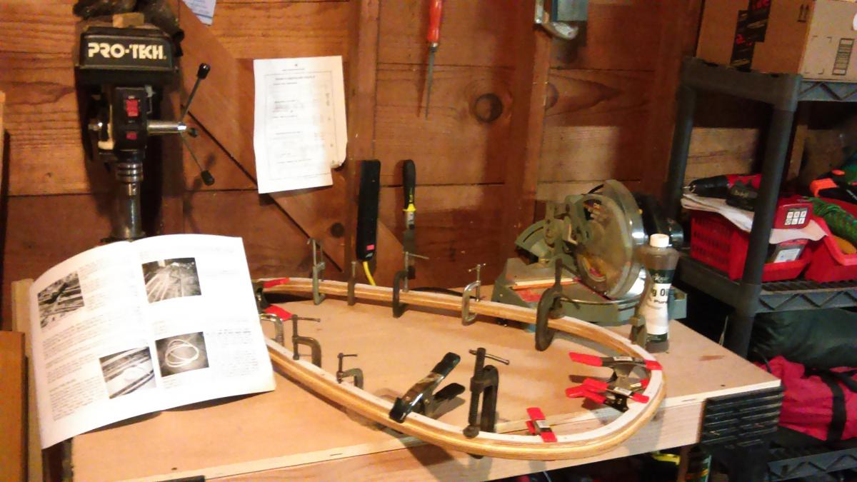

Prior to starting to skin the boat I began to wonder about the plywood coaming.  From reading the build guide and Jeff's book I know I need to lash the bottom ring in place.  Knowing this  I started searching the forum and came upon nopoe's Ravenswood build thread. I have not taken the coaming apart but it appears to be held together with 6 screws.  Another thing I noticed is that some of the paper template tore off.  That is not too big of a deal and I think I can compensate for the small area that is missing.
Before I start to drape and sew the skin on what do I need to do with the coaming?  From Nopoe's thread and Kudzu's responses it a looks like I need to drill the holes for the screws as provided by the pattern.  Should these go all the way through the coaming pieces, i.e. through the top of the coaming or are they pilot holes?  Do I glue any pieces together? I just want to make sure I am not missing a critical step.
All this is covered in the manual, just review it.
One thing that is not mentioned is the option of putting in the screws from the bottom. I have started doing this and really like it but it is a pain in the butt to do. I have found that a small ratchet with a screwdriver bit makes the job possible but not easy.

Thank you for the advice.  Sometimes when a person gets focused it is hard to see the trees from the forest or in this case page 65 from the rest of the manual.
I like the idea of putting the screws in from the bottom and if I can come up with a screwdriver bit for the ratchet I might try it.
I use the small 1/4" drive(?) ratchet. Somewhere I picked up a set of sockets with a special socket just for bits. But a standard socket the right size will work. It's not fun thing to do but a screwdriver just doesn't work in that small space.  And they look MUCH better with screws in from the bottom.

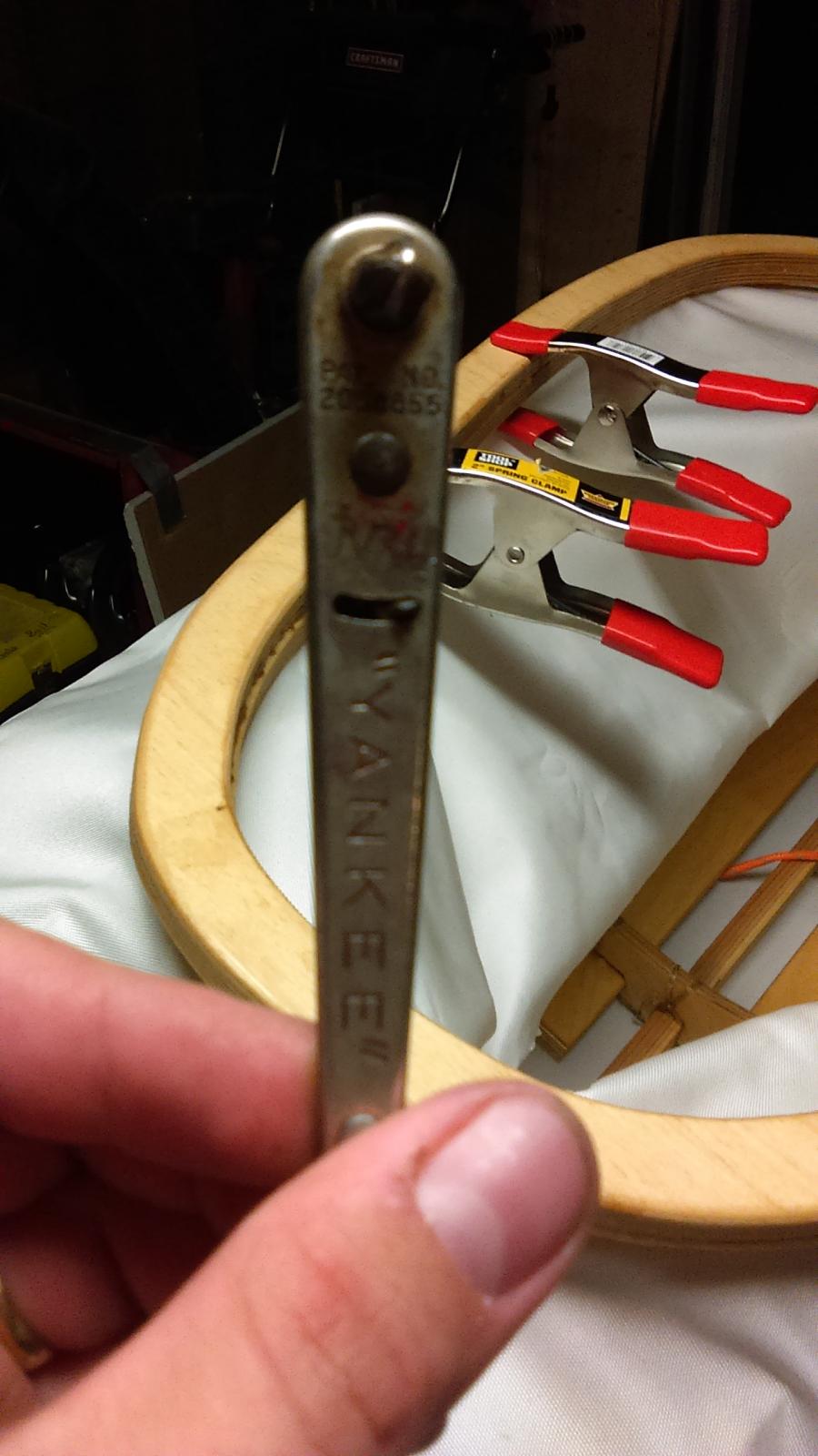

Well it's funny how life has a way of popping up and impeding progress.  Needless to say it has been a while since my last post.  Work, travel, and triathlons have meant little progress has been made at least until the last few days.  The skin is on and I am working on attaching the coaming.  Thanks to Kudzu for the drive ratchet idea.  By way of my grandfather I am the proud owner of an American made, North Bros. Mfg. Co "Yankee" ratcheting screwdriver. This is proving invaluable in putting the screws in from the bottom of the coaming.

By the by, that screwdriver is very cool.
