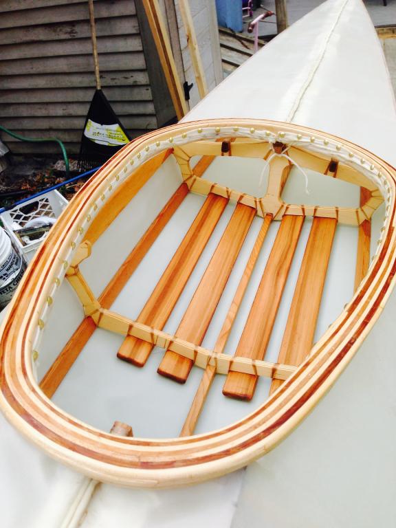

  4. I built three of these Kudzu SOFs and used a 1/4inch round over router bit on just about every edge. The edges that did not get the router treatment got the edge sanded off. John C

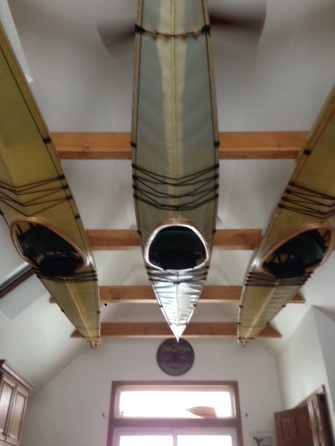

  13. 3 feet of snow on the ground and 3 kayaks in the rafters. Long shot, Vardo and Fire Fly (l to R) http://s850.photobucket.com/user/John_Casanova/library/?sort=3&page=1
