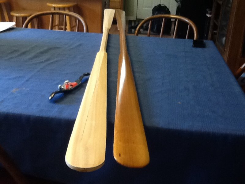

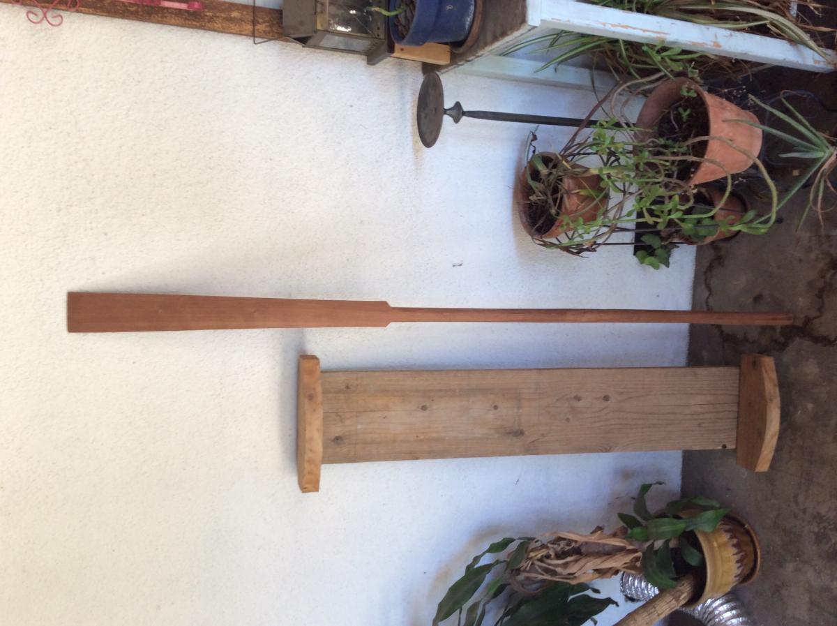

Bcone1381 Posted June 20, 2014 Posted June 20, 2014 I need a second paddle, and am making this out of Western Red Cedar. It's two 7 foot 1x4 glued together, roughed shaped with a band saw and further refined with a spoke shave. Dave Finnegan at Charlestown Boatworks showed us has some fine works of art on this website (and at a very good price) that I do not try to live up to. These are very light, are a joy to use, but use soft lumber that will get dented, and marred easily. (Broken in!). A worthy improvement would be an oak tip and blade edge. At my level of skill I submit to the Keep It Simple mentality. A combination of frugalness and enjoyment I get in making my own gear drives my ambition that some of you may share. The spoke shave (on the left) is a great tool for this task. http://www.qajaqusa.org/QK/makegreen2.pdf 1 Quote

Hirilonde Posted June 22, 2014 Posted June 22, 2014 I used the same article/tutorial for my paddles. I have seriously streamlined the process since, but I still work towards the same shape. Those paddles pictured look great. Without the hardwood tips you will need to use some care pushing off, but I think you will find they serve you well. I plan on putting epoxy on the tips to make them hardwearing. Epoxy won't do much in the way of making them "hardwearing". And once the tips are scratched up it will make refinishing it tedious to do well. Using hardwood tips is the closest I can come up with to protect the soft cedar. Using bone is a little impractical. Protecting the edges seems over kill unless you are hunting seals in icy waters. It might be amusing to some day make a paddle with tips and edges protected for the sake of a historic replica. But this project has yet to make it to the top of my list of things to do. Quote

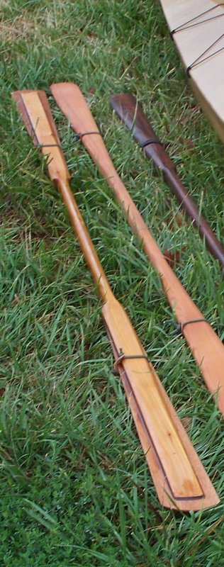

Action Tiger Posted June 22, 2014 Posted June 22, 2014 I have used nylon cord soaked in epoxy to beef up my paddle edges. I can't remember who I stole the idea from. It is not elegant, but it is tough. Soak a cord in epoxy, then pin it around the edge of the blade. The blade/cord junction can be smoothed with schmutz, if needed. Quote
Hirilonde Posted June 22, 2014 Posted June 22, 2014 Soak a cord in epoxy, then pin it around the edge of the blade. The blade/cord junction can be smoothed with schmutz, if needed. This, or similar is a common practice for centerboards and rudder blades on the bottom and bottom of the leading edge. That is, where they would hit rocks or the bottom in shallow water. I think it would make a paddle blade into something quite crude looking and distort the shape. For me anyway, one of the prime reasons for making a wooden Greenland style paddle is that they are beautiful. Any efforts I would add to make them durable would have to be beautiful as well. Quote

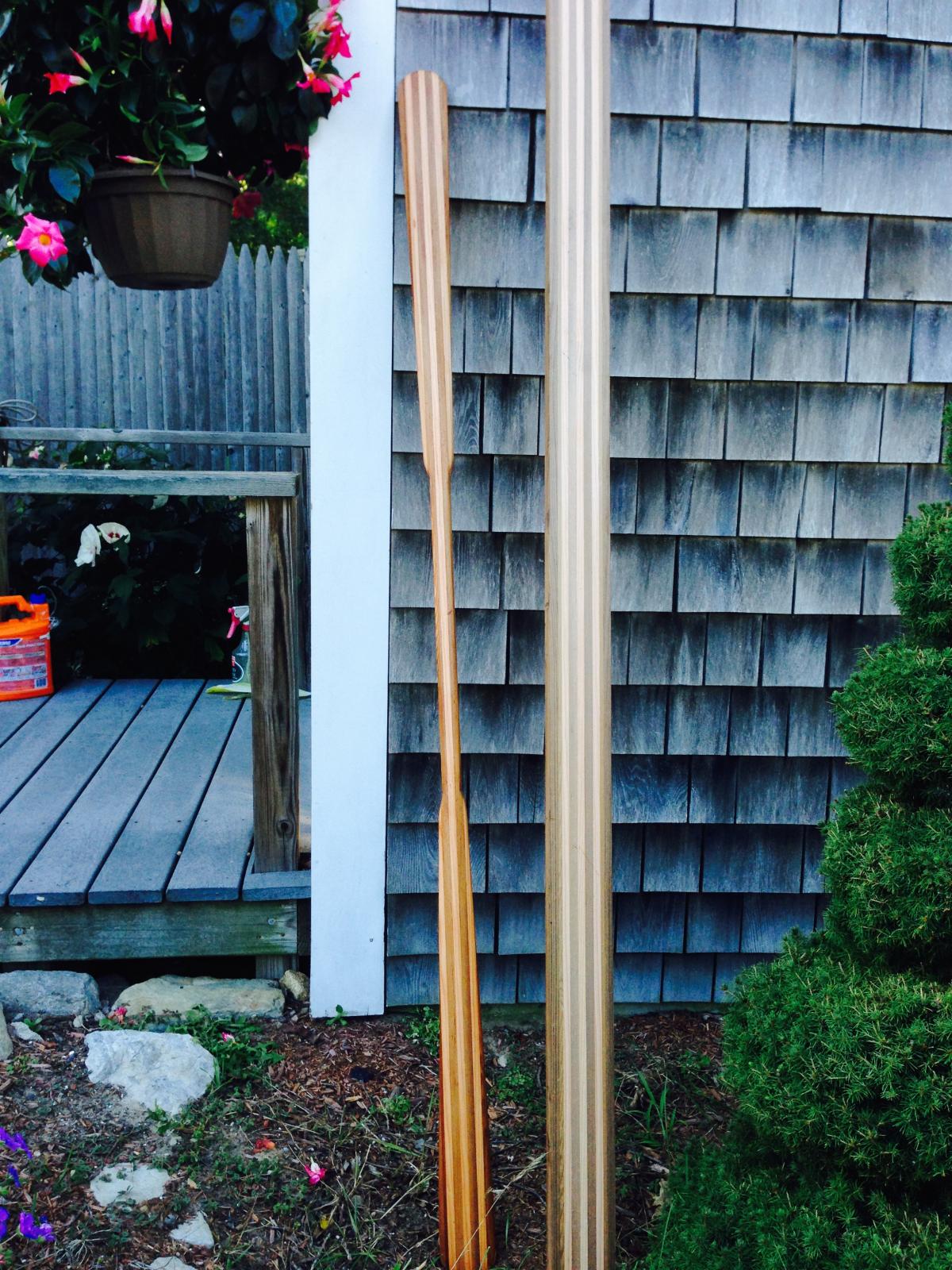

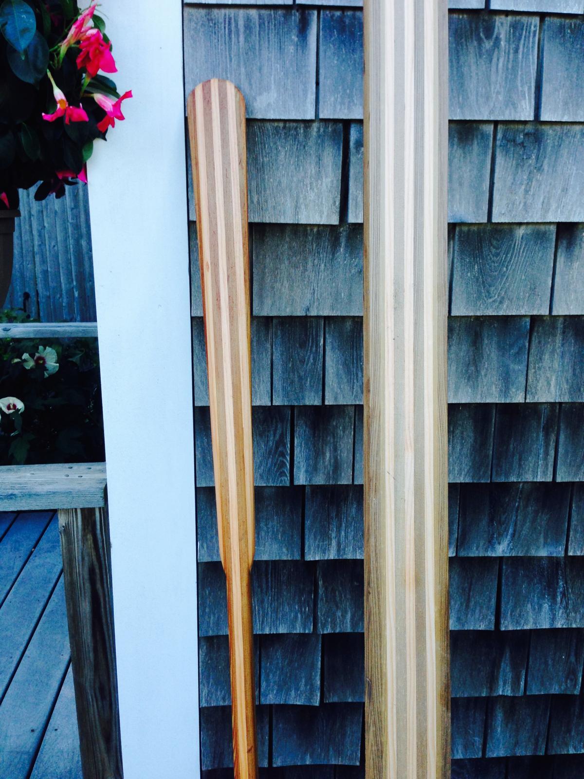

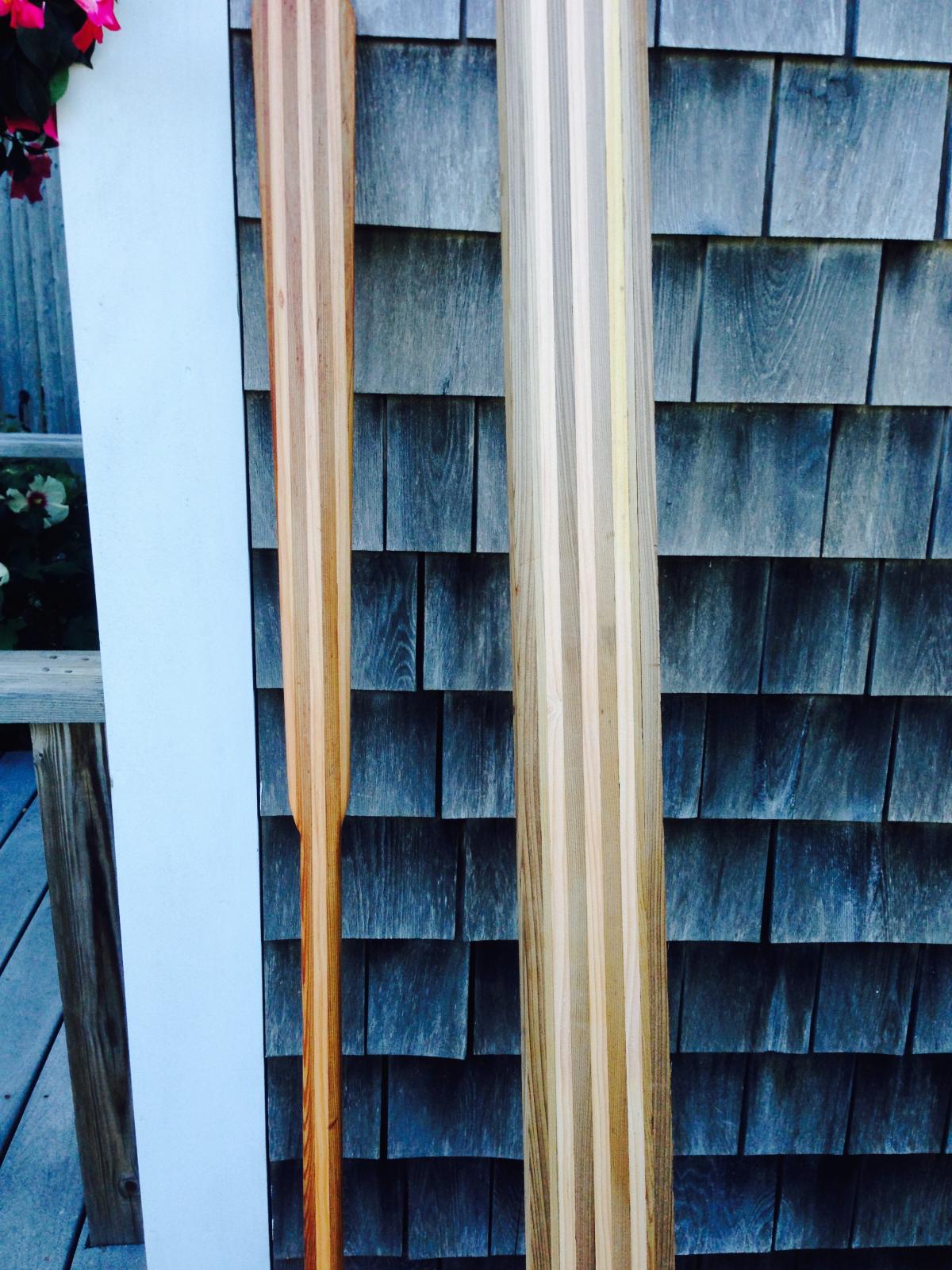

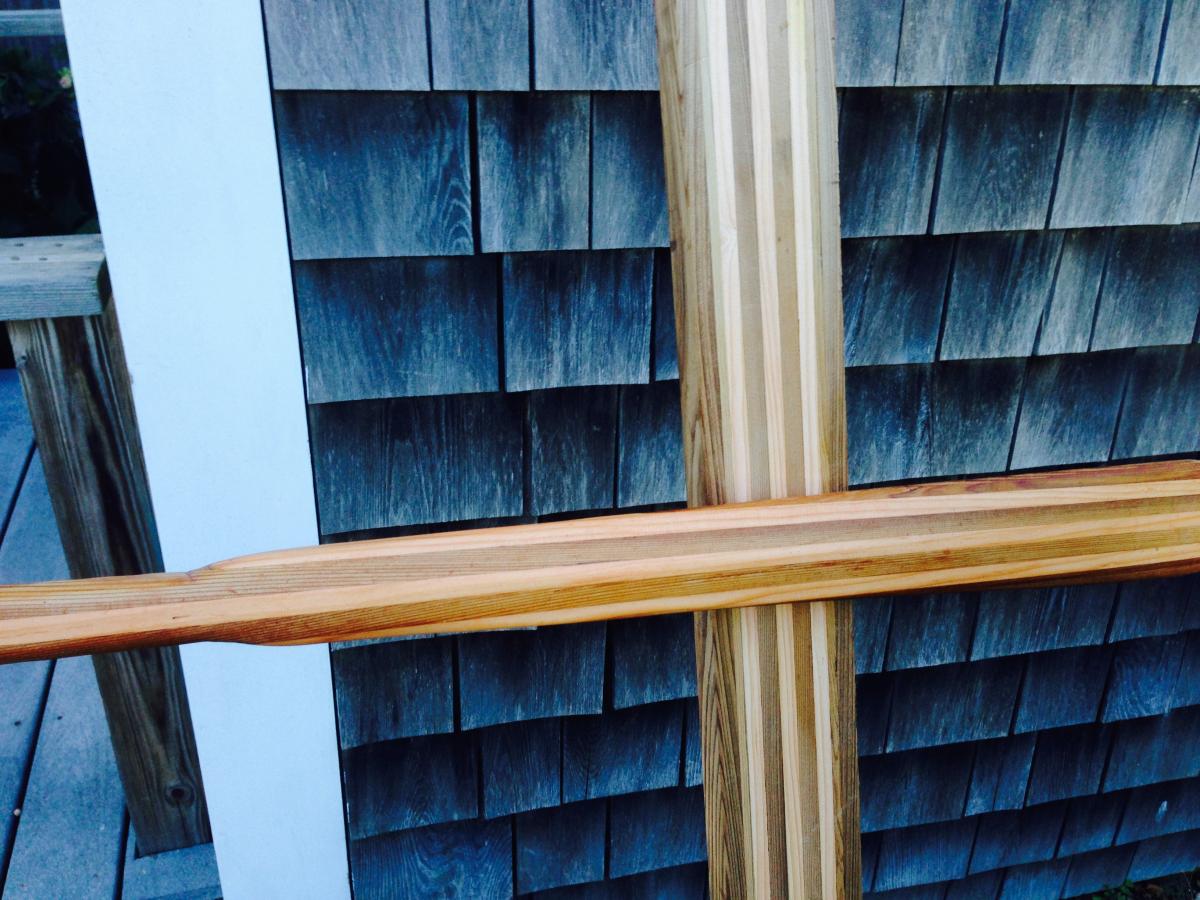

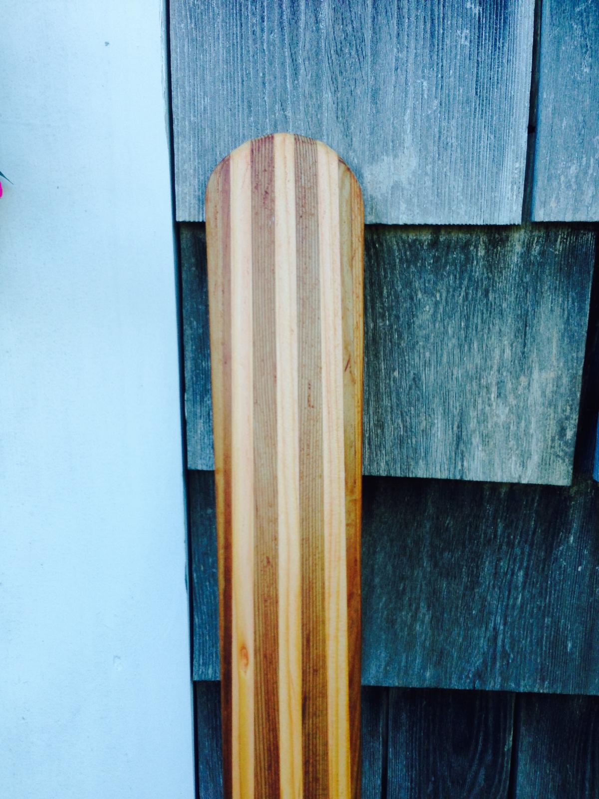

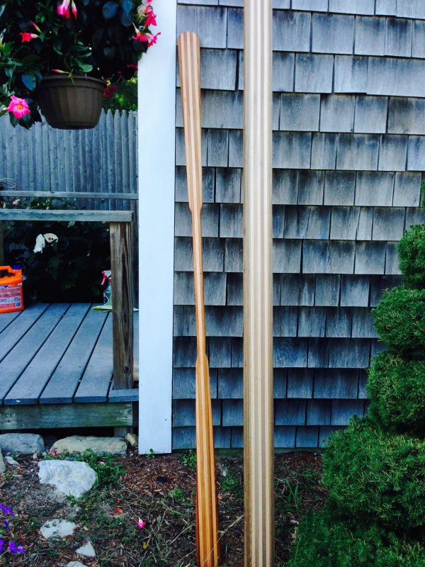

CapecodJohn Posted August 15, 2014 Posted August 15, 2014 Thought I would try my hand at carving a greenland paddl. I had a piece of redwood left over so I matched it up with a piece of white cedar. I ripped them on the table saw planed them and glued them up with tite bond 111 hope it holds. The first one is for my wife mine is still in the blank not bad if I say so myself. Quote
