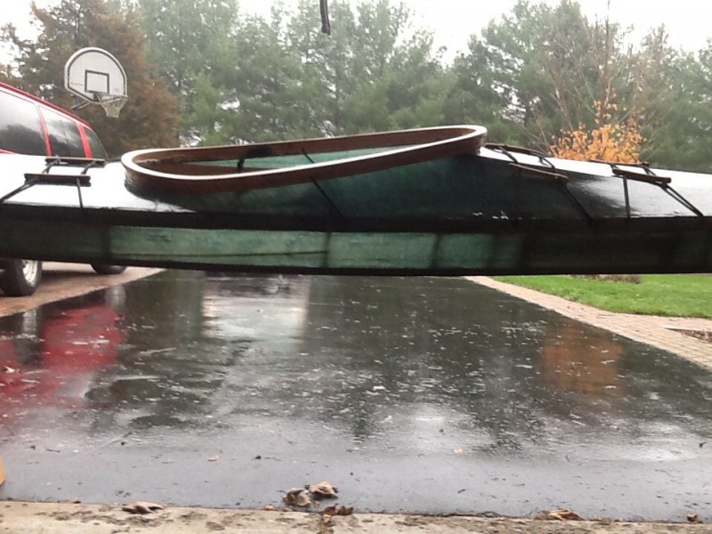

Gentlemen, This information helps me a great deal, and I appreciate the wisdom you all bring. For Woodman: This is a profile shot of the coaming on my wife's Ravenswood. It's made of oak and was flat. I then set the coaming onto the kayak frame and wrapped a ratchet strap around it and cranked up the tension to get the flex I was looking for. I suppose it sat there a week or so. It was removed to cover the frame, and I think the tension of the fabric may help it keep that shape.
I envisioned wrapping the coaming mold 4 times with the 1/8" stock to build up a 1/2 inch thickness. Would that be too fleixble? I have one make of oak with those demensions on my wifes Ravenswood and its plenty sturdy.
Is the idea of using 1/8 Russian Birch Plywood for a laminated coaming built in accoradance with the assembly manual pg.66 A godd or bad idea? My Lumber supplier also sells a product they call Bending Plywood. Would that be a better product to use?
