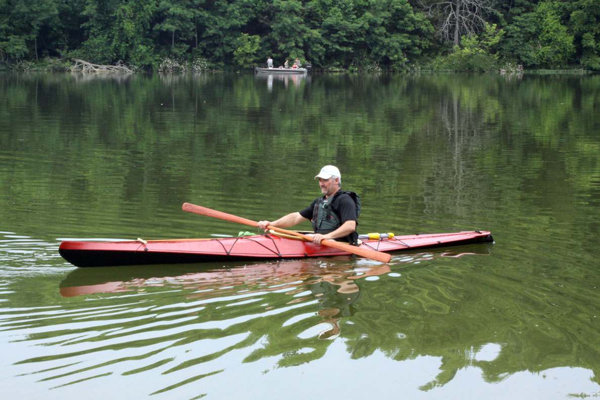

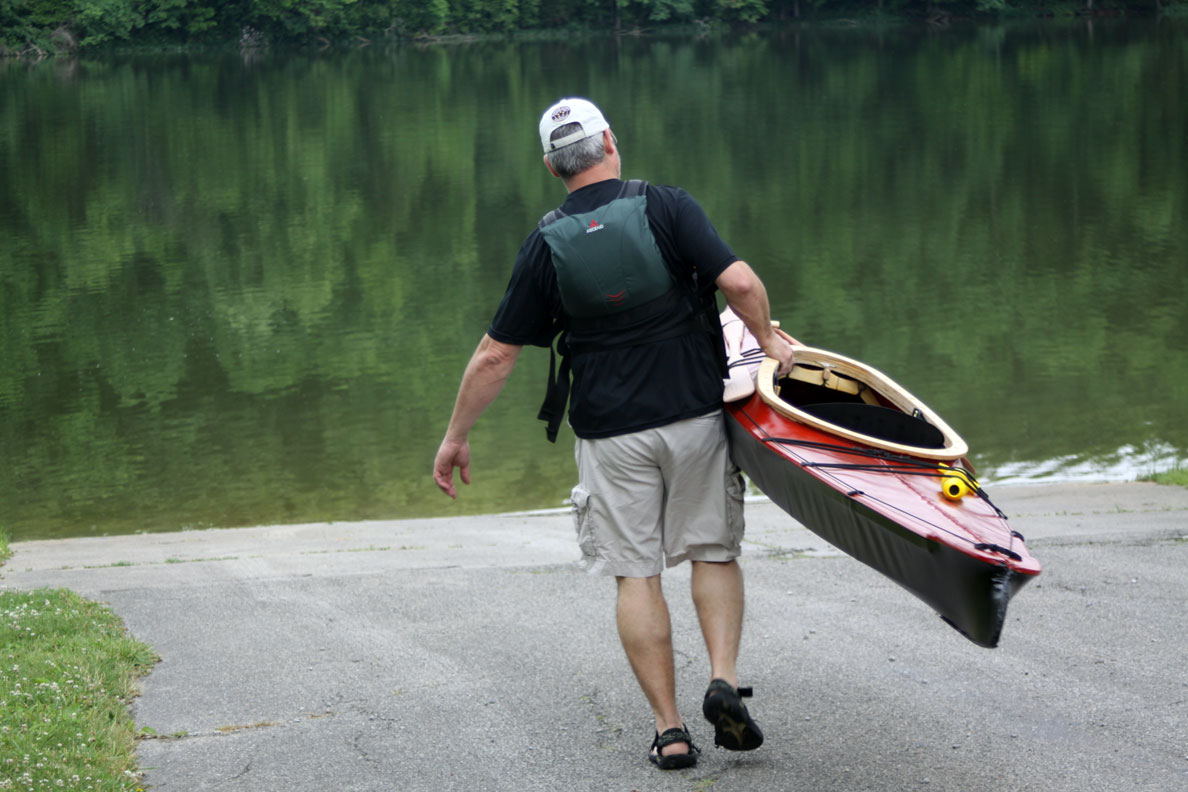

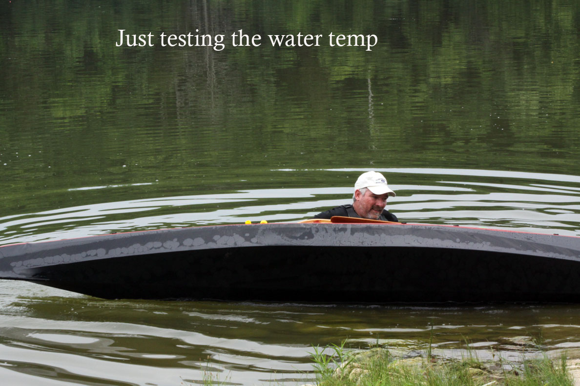

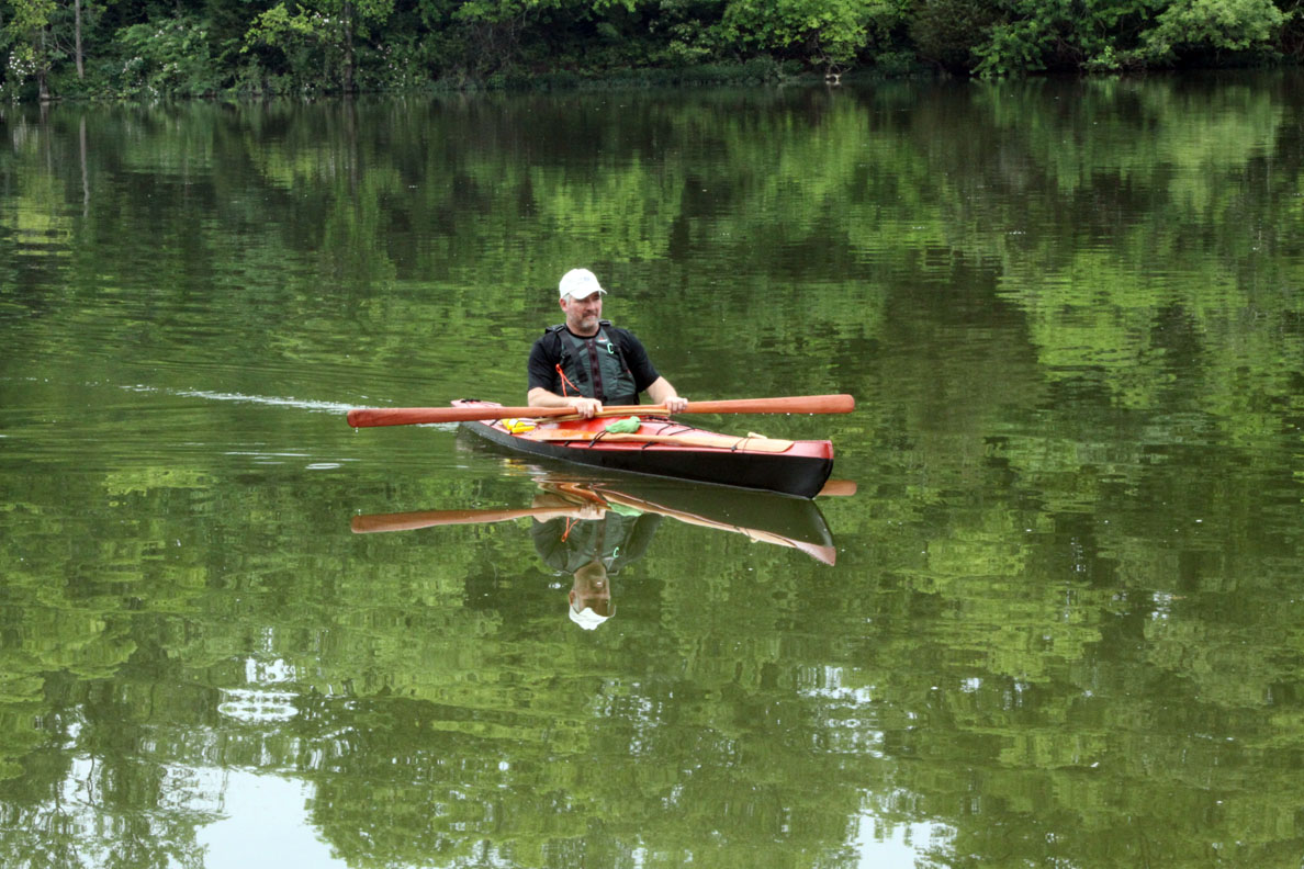

  13. Decided it was launch day for the Curlew. Chose a quiet lake, with minimal motorized traffic. Overall experience was good, need to make minor adjustments to foot rests & minicell foam seat. Also need to get a thermometer so I don't get so wet testing the water temp. :-)
