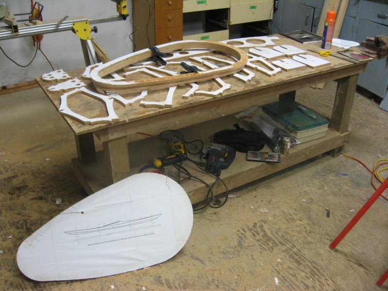

Just startng a Shad build after many months of sitting on the plans. Should be nerve-racking/intresting as I have little experience with power tools outside of hand drill (Heck i'm 33 and don't know how to drive :) ). Just finished cutting out the plywood bits today in a friends workshop (off grid/no power at my cabin). Got lots of sanding in my future I think. :) Anyway so far so good and I'll try and post pictures as I go.
Awesome!  You've taken the first step, you can do it.  My plans are supposed to arrive on Thursday, so I should be able to get started this weekend.  I'm looking forward to seeing your progress.

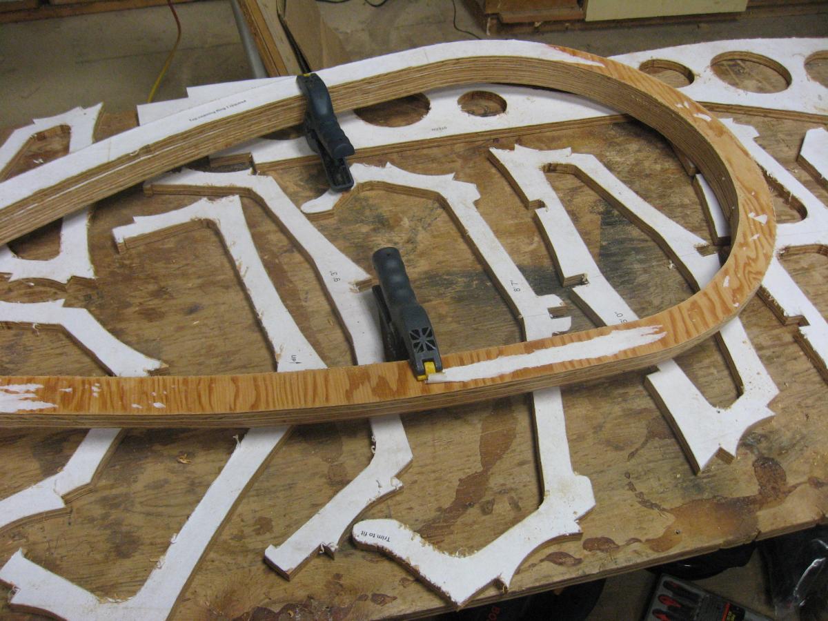

Sanding day. Big problems getting the paper off. Had to scrape the paper and adhesive off with a chisel. Some chipping here and there when sanding but was fairly straight forward. Need to find a file to tidy up the stringer slots. I'll try and drill/glue/sand the coaming in the next few days. I might chicken out on cutting the stringers myself and get a friend to do it for me.

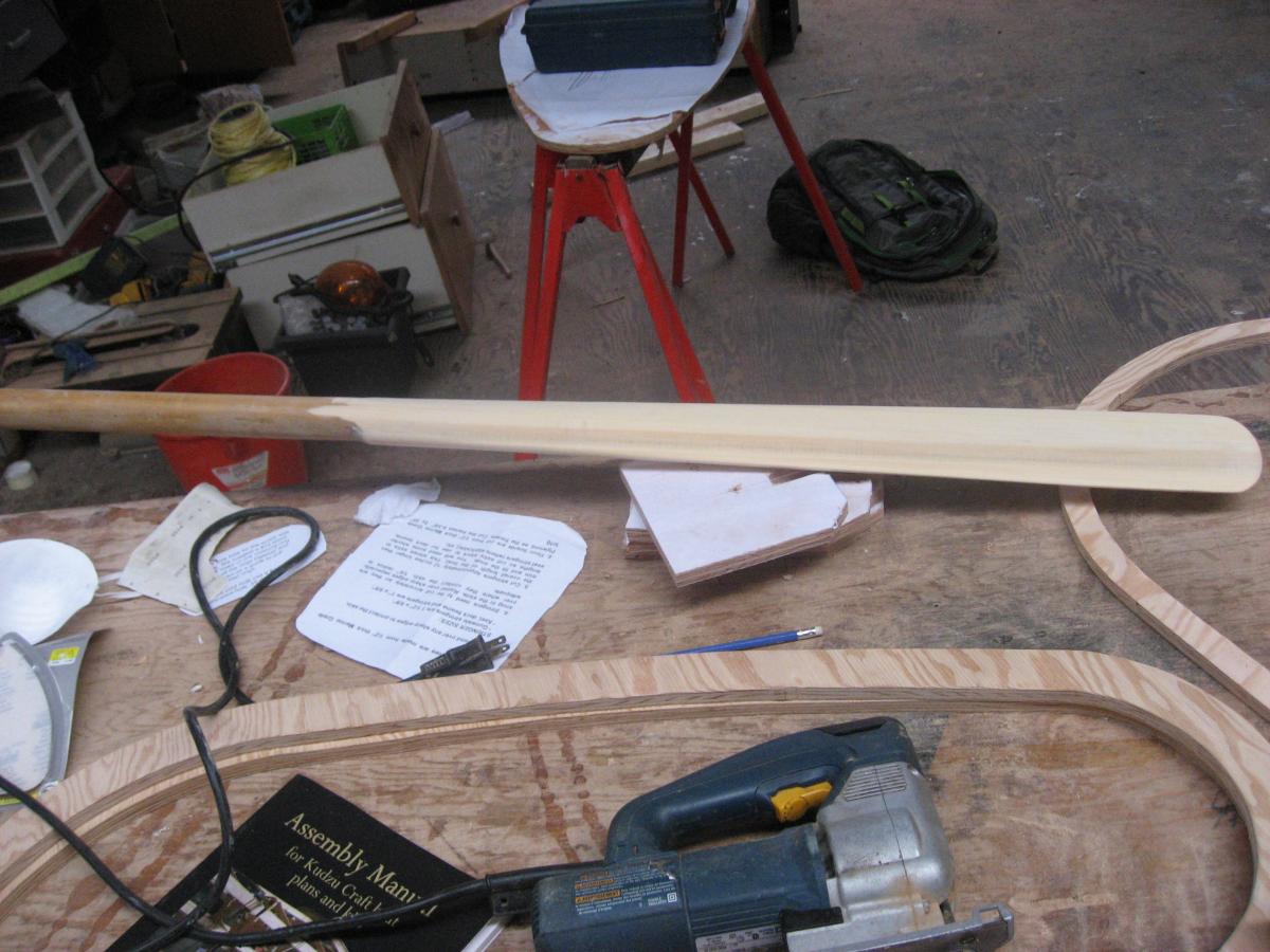

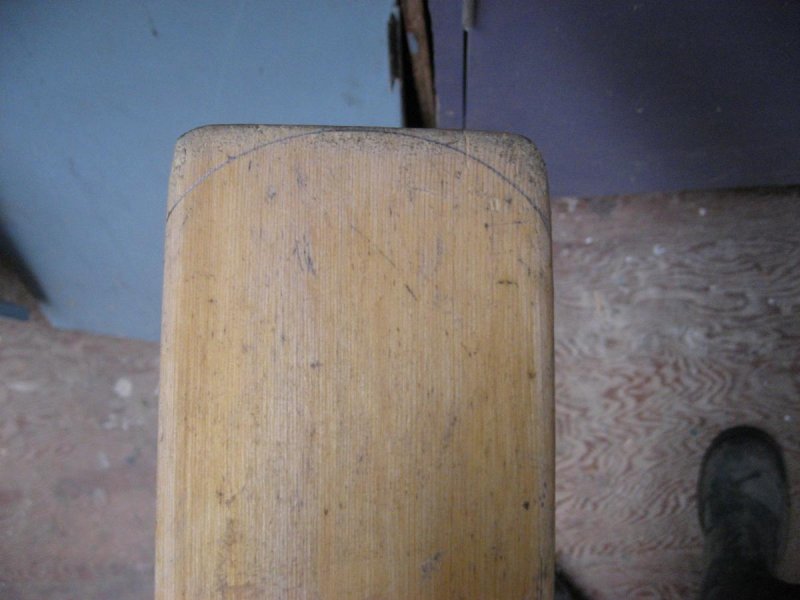

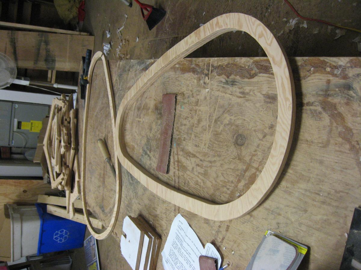

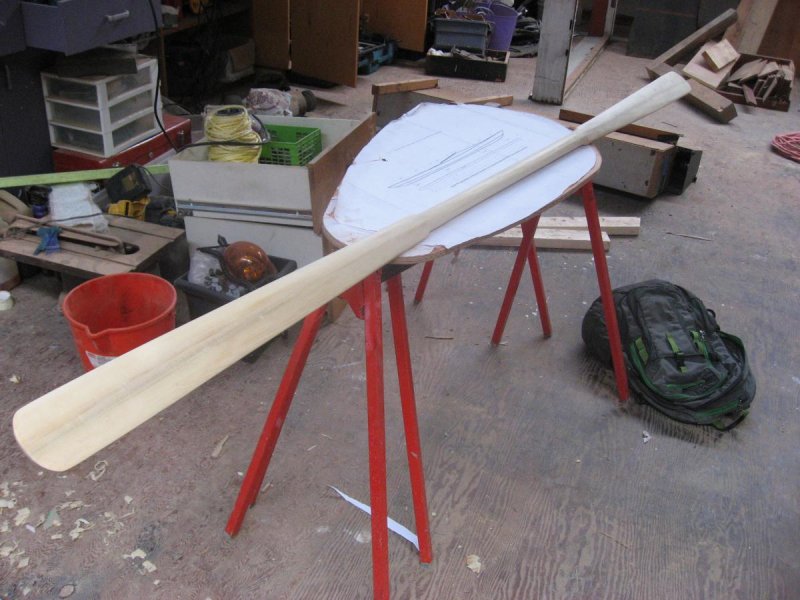

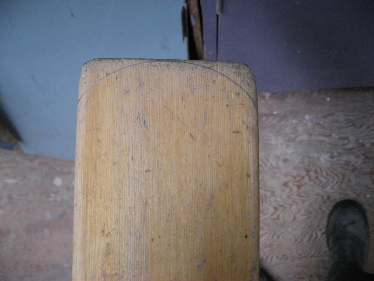

Went into the workshop the glue the coaming but the glue i had on hand (gorilla glue) said it was type II water resistance so I figure I might need to find some other glue in town. Thanks for the comments on glueing plans to wood for any future projects. I do appreciate it. This project is part learn as you go and part therapy for me. Rather then waste my time at the shop I grabbed my Greenland paddle from the rafters to do a long overdue re-carving. Carved this paddle 2 years ago and was way over built (the paddle got the nickname "bear mauler" by my fellow kayak guides). Grabbed the block plane and gave the paddle the wood equivalent of Liposuction. Also cut in rounded tips. much lighter now but will have to see how it rolls and how it holds up to banging on the rocks when i need to free clients. Had a laugh when my friend walked into the shop and asked me how I was planning on adding the blades to the paddle (Greenland paddles seem to confuse people). Sorry for the interlude on the build but it is kayak building related. :)
Back at it now that the snow and trees have been cleared and the power lines put back up (took 4 days, we got hit hard on the island). Just finished the glue/clamp/drill/sand of the coaming. Woot. Will be another break as I pick out some wood for the stringers.

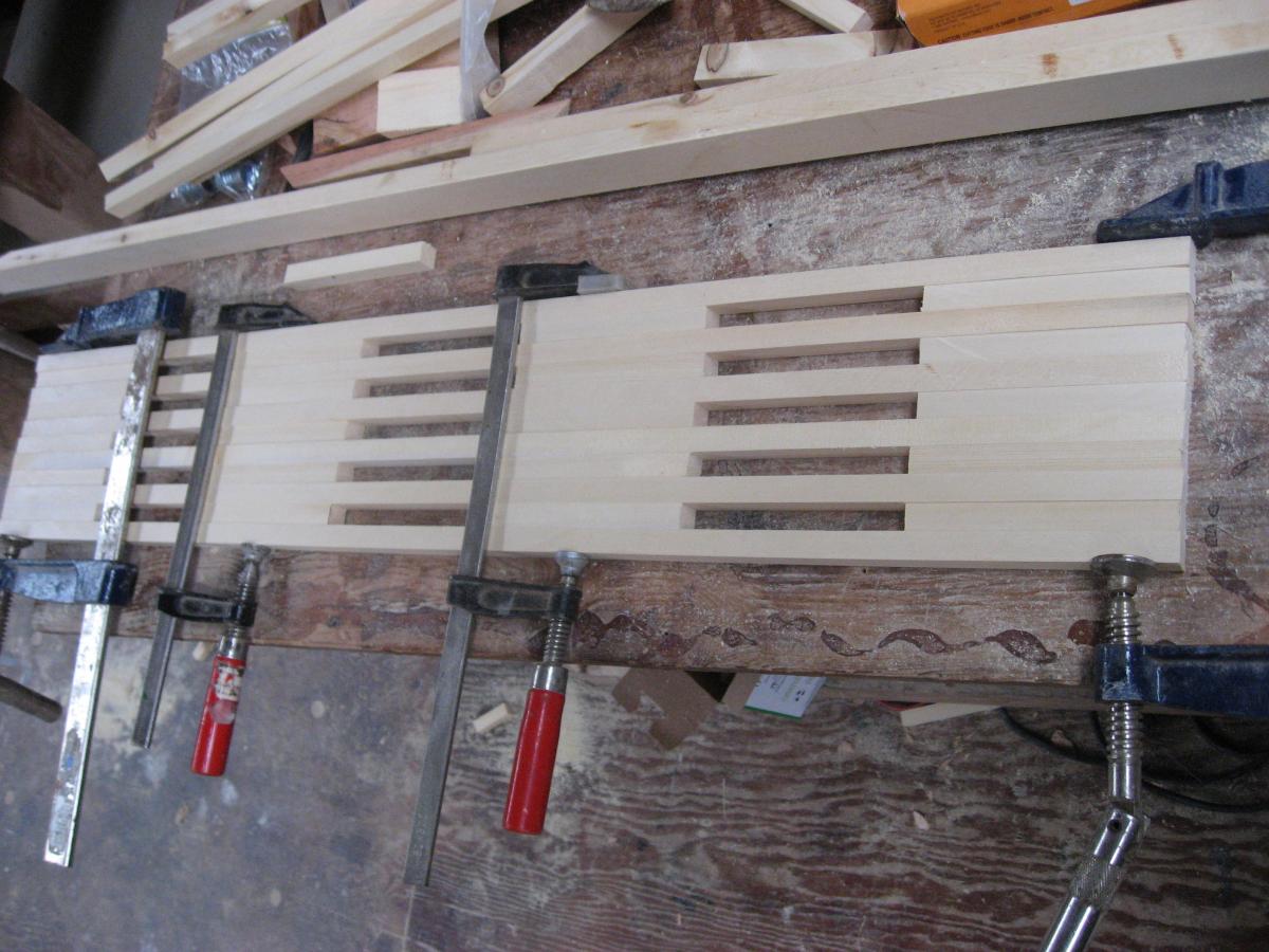

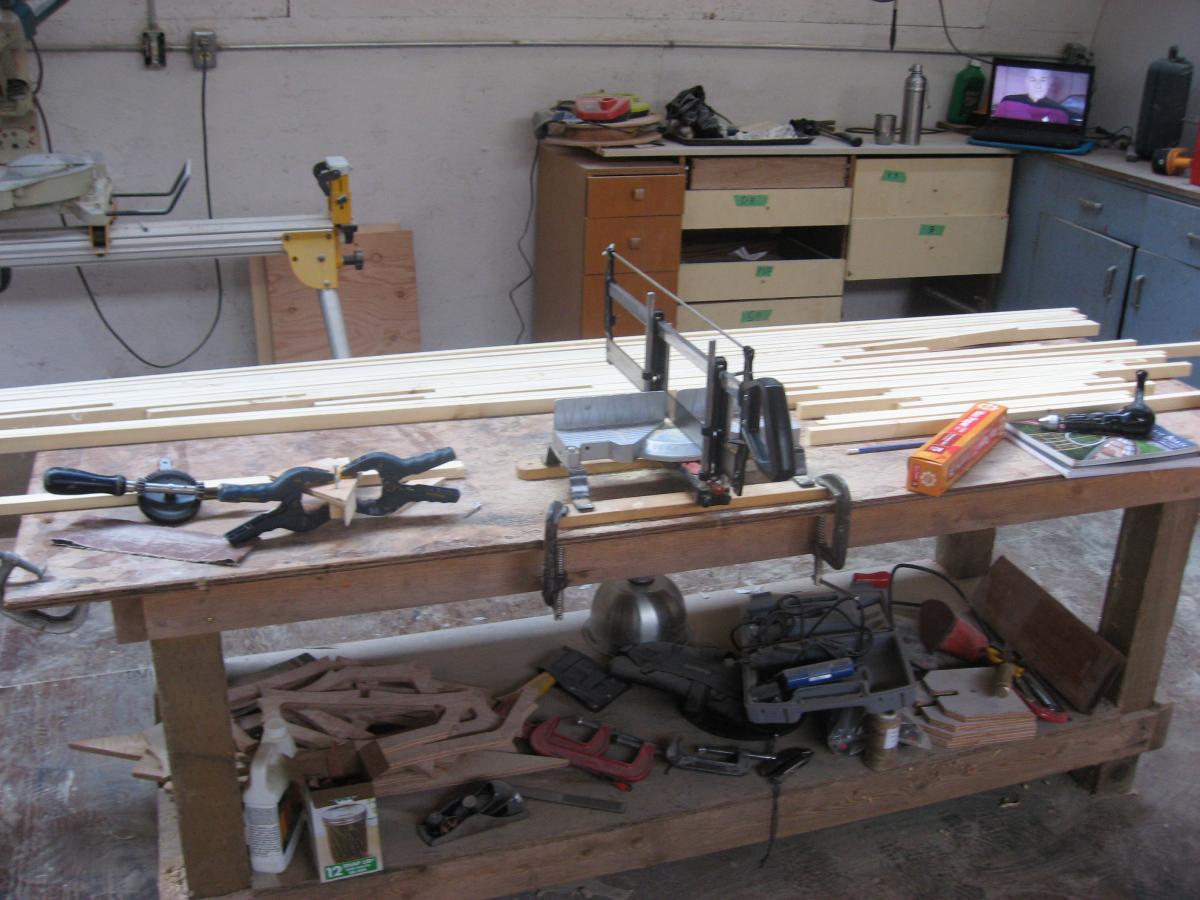

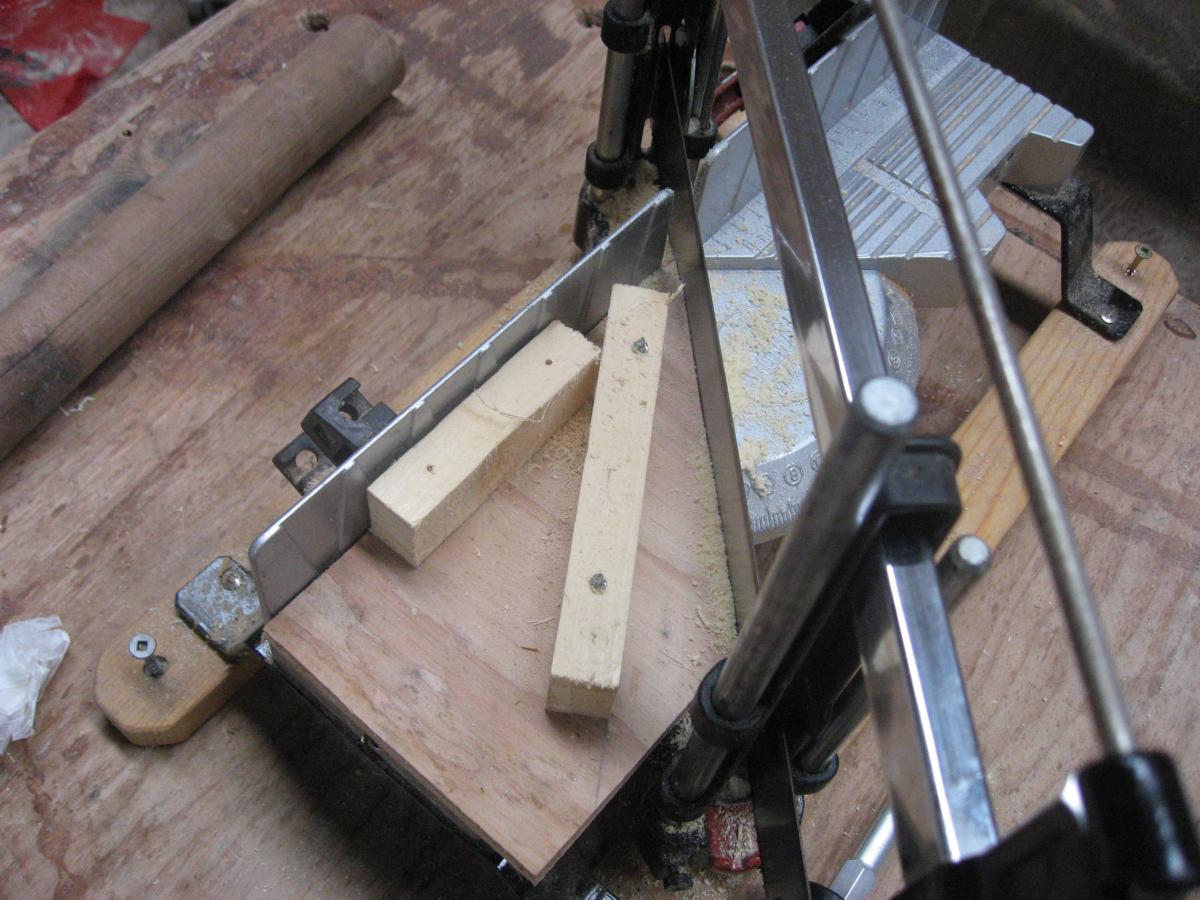

Getting started on the stringers after a bit of a delay. Heard I might have some problems gluing the yellow cedar scarf joints as yellow cedar doesn't take glue well (?). Did the scarfing with a jig and my hand miter saw. Gluing is turning out to be a slow process, Onward and upward as they say. Oh before I forget, anyone have any info on glassing  over a skin on frame kayak? My boss is pushing to do it as he has a friend that does it and he says it works well. Thinking about it because if I have a glass kayak I can use it for work (and it could pay for itself) and with a SoF kayak I can't (Guiding). Thoughts.

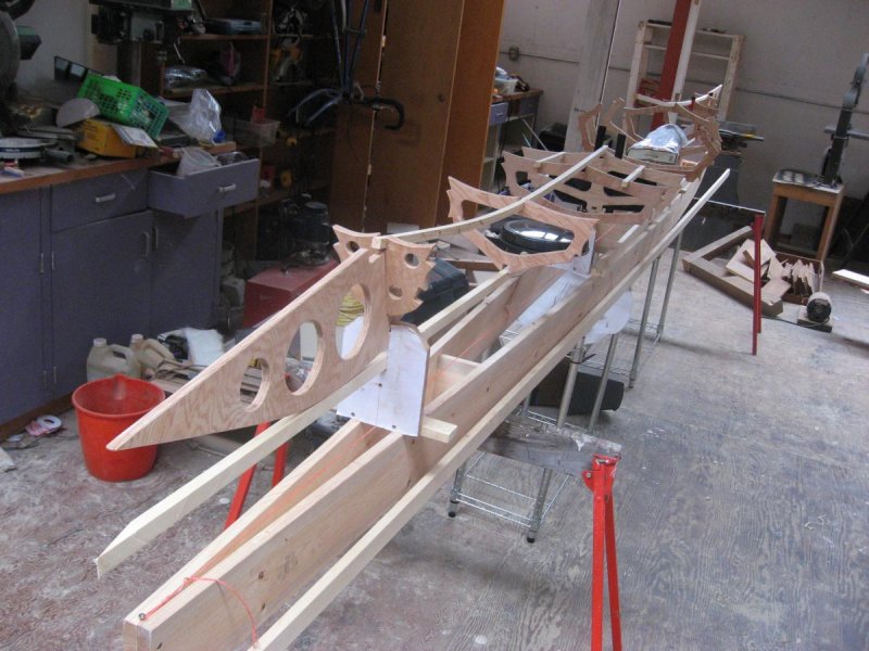

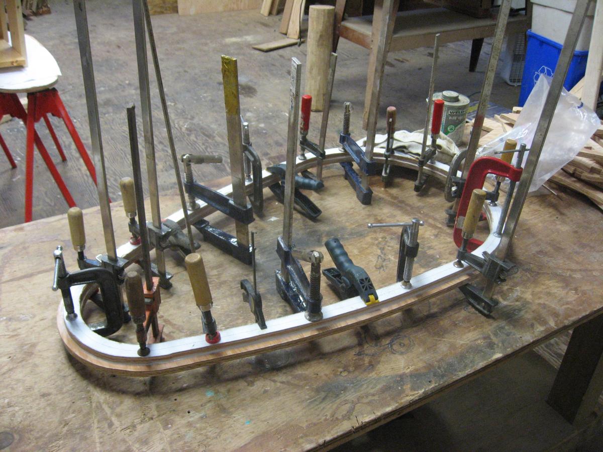

Back to the build. Still gluing the stringers and gunwale pieces together. I've set up the strongback and the brackets as well. Figured out where I will be putting in the hatch. Tossed some scraps together with the pieces for a bit of a visual for when all these pieces start to come together. I did drop a gunwale, not in a nice way, and it snapped along the scarf joint and this has me wondering if they are strong enough. the glue (titebond 3) seam not to penetrate too deeply into the yellow cedar fibers. As I said it was a bad drop (hit the work bench on the joint just a I grabbed the higher end of the thing) and wouldn't surprise me it broke but it does sew seeds of doubt. Any good ways of checking the joint strength? Also looking at making a seat from the ripping scraps.
Some pictures of the last day or two.
