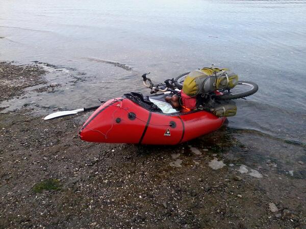

Bcone, Standard bikerafting setup. It's an alpacka packraft with sprayskirt and moded with thigh braces. Carries a my steel touring bike easily and fits with paddle in one 25L side bag (camp gear goes in other side bag). Raft setup weighs about 8-9lbs. I live on a small island and I use it when I want to go cycling on one of the other islands. I use a whitewater helmet for cycling and paddling ocean/river. Upside down it turns into a 1.5 ft thick air mattress (just toss a tarp over). If you want more info look up packrafting or bikerafting. -

Inflaties are awesome if you use them right. They are not performance oriented but you can go places and do things that can make your friends drool. If anyone tells you they are not real boats get them to read Paddling North by Audrey Sutherland. Congrats! Bonus Pic of my packraft set up (yes it works the other way around): -

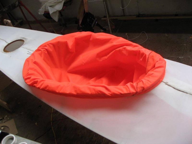

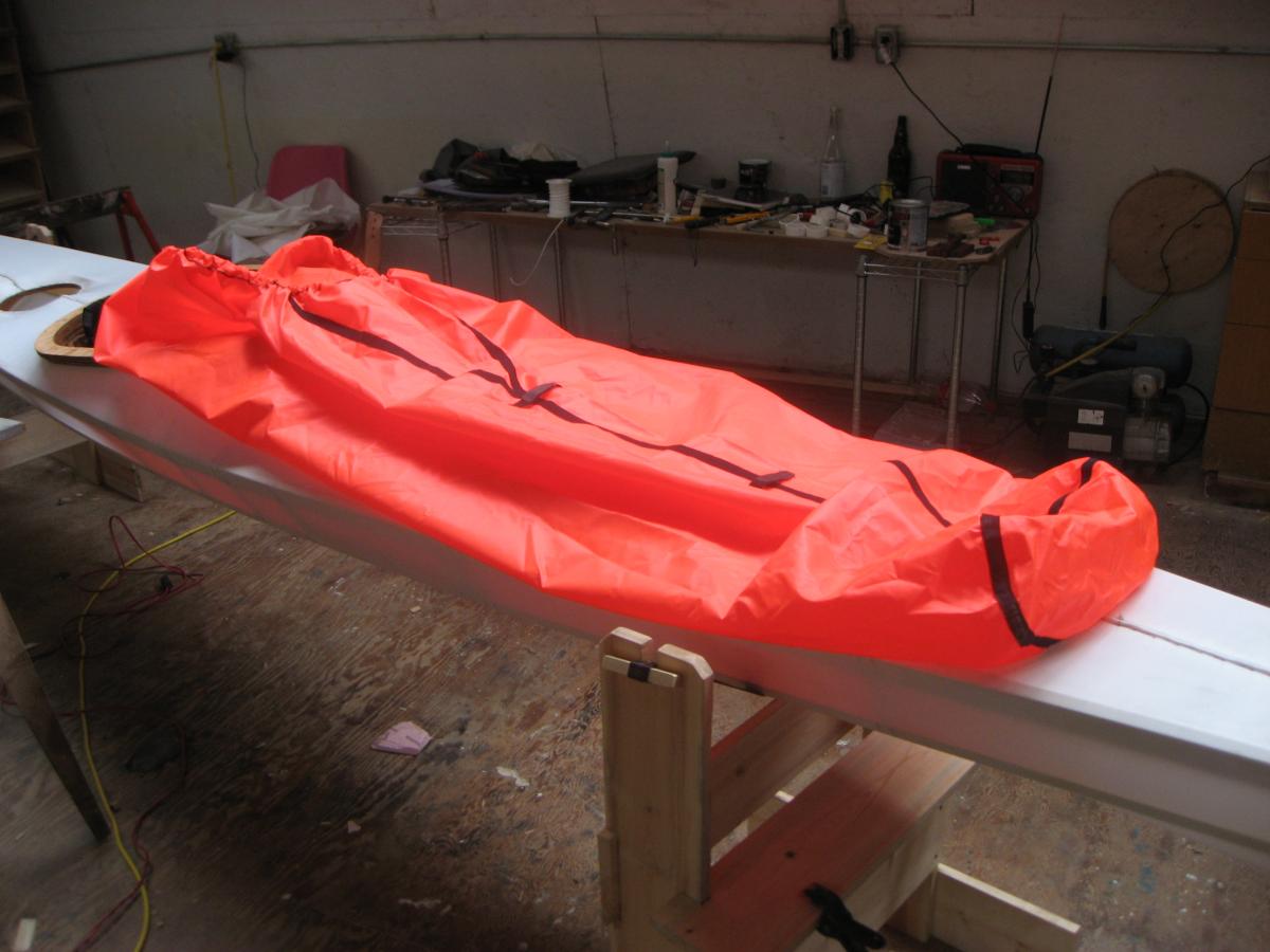

Keeping water out is not my primary concern for the most part. Keeping dirt/grime out and having less cleaning/maintenance for me is the big draw (I clean kayaks 60-90 min a day, 7 days a week in the summer). I reserve judgment on the water/safety aspect until I test it upside down. Entanglement is very low on my list of safety concerns. I'm ocean kayaking, not river/lake kayaking so drowning due to entrapment is not likely (I've never heard of a case in sea/ocean kayaking so feel free to link me to some info). Also I plan to use the rope system for packing bags for touring and the sea sock I would think would greatly reduce getting tangled up. Also touring I may need to substitute my float bags for gear bags with air until there is room for inflating float bags. So I do no intend to replace my float bags but I do see scenarios in my kayaking when float bags may not work. Both together will be my go to. I've always liked my safety in layers, using them all when I can and having options when I need to pick and chose. For my sock I went with a color you can see from miles off so it's also a visual signal in emergency's. Last thing would be the extra bit of warmth and comfort for paddling in the north pacific.
Just got my sea sock in the mail and need to get the kayak done to try it out. Hoping to do an "impressions" post on it later. If anyone has anything to say on sea socks I'd like to hear it and if anyone is looking for information on them hit the links below (saves me from retyping the info ). http://www.kayakquixotica.com/2011/08/12/the-fantastical-sea-sock/ http://www.qajaqusa.org/newsletter/Masik_Summer2003_07034.pdf Photos are of the sea sock I had made by Black Dog Kayaks for my "in progress" Shad
