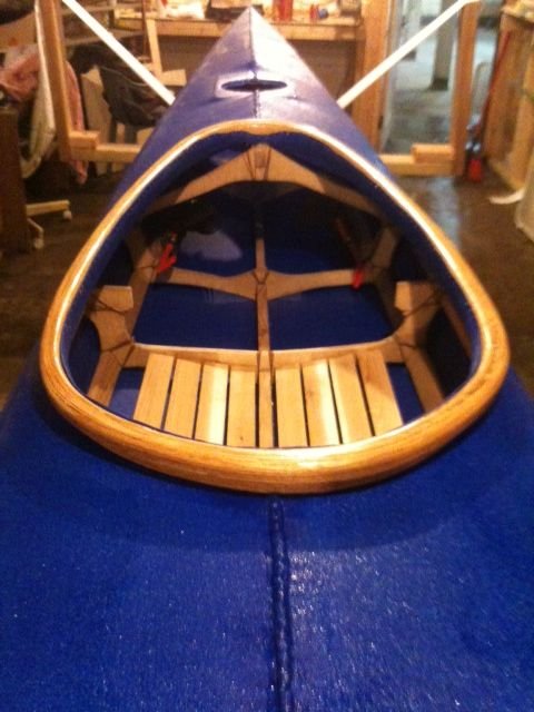

  6. I used steam bent oak strips 1/8 inch thick and actually layered mine about an inch thick then used a router to route out the excess on the bottom for the spray skirt lip, and used a round over router bit on the top edges.

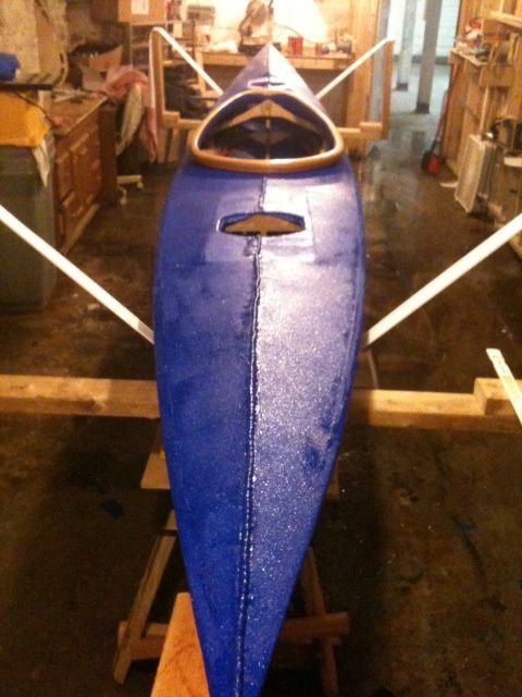

  13. I kinda dropped off the face of the earth for a bit due to heavy workload and moving, but the nimrod is done. Now just need to find time to try it out. I am not real happy with the finish using Corey's goop, came out kinda rough not smooth and glassy like i hoped, maybe due to the poly coating inside? But it did bond really well and I believe it will be quite watertight. Attached pics but not sure it will work from my phone. Sent from my iPhone using Tapatalk
  14. Progress coming much slower then I had hoped for due to other things that needed tending to, But, it will be done soon. First coat of polyurethane on the top of the kayak, looks a little blotchy, but I understand that is normal for the first coat as it soaks into the fabric. also a picture of the cockpit and a closeup of the fabric mounted to the cockpit coaming with the brass nails. The nails actually held a lot better then staples did, but I was only using the staples temporarily to keep the tension on the fabric till it got nailed. I ironed the fabric some, but it was already sewed so tight and without any wrinkles or creases, that the ironing really made no difference. Really hoping to be done prior to next weekend for a water tryout, but will have to see how things go.
