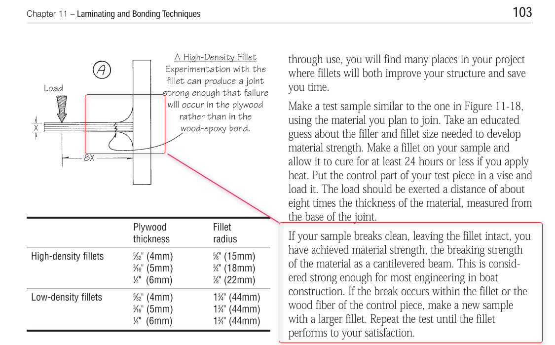

Howard Posted January 10, 2014 Author Posted January 10, 2014 Fillets. If you have not yet downloaded the West Systems Epoxy Book, I suggest you do so. Fillets are mentioned in detail starting around page 101 or so. This is certainly one area were the West and S3 literature differ. While most of us recognize that there are scantlings for plywood, etc, what may not be as well know is there are also scantlings for the size of the epoxy fillets, depending on the size of the plywood. Those appear to be much larger than I knew. I have two sources that are suggesting the radius of a structural fillet to be as much as 3x the thickness of the plywood. So for 1/4" plywood, that would be a radius of 3/4" and meaning the diameter of the fillet tool would be twice that, or 1.5 inches. That is much larger than I have been using, and if this is true, I need to beef things up considerably. A similar version of this story places the run out of the fillet up the side of the panels to be 2x the thickness of the plywood. That is less than 3x the radius, but is still bigger than I have been using. Years ago I did a fillet test, as the West literature suggests and glued up a number of fillets on 3/4" marine fir plywood. These were done with fillets alone (no tape), but also with various levels of tape over the joints. In every case, the fillet held and it was always the wood beneath it that gave way. The radius of these fillets was no more than 1/2".....much smaller than suggested above, and about all tape did was to increase the area of plywood being peeled off. Of course that was with fir and other plywood would be different. Best advice I can see is to make them big enough the wood always fails first and can't see how making them bigger is going to help beyond that. This is one are I'd like to see considerable discussion on. Quote
tom151 Posted January 10, 2014 Posted January 10, 2014 Years ago I did a fillet test, as the West literature suggests and glued up a number of fillets on 3/4" marine fir plywood. These were done with fillets alone (no tape), but also with various levels of tape over the joints. In every case, the fillet held and it was always the wood beneath it that gave way. The radius of these fillets was no more than 1/2".....much smaller than suggested above, and about all tape did was to increase the area of plywood being peeled off. Of course that was with fir and other plywood would be different. Best advice I can see is to make them big enough the wood always fails first and can't see how making them bigger is going to help beyond that. This is one are I'd like to see considerable discussion on. Interested in more specifics of your test failures... referring to Figure 11-18: cross section A (wood failure) and cross section B (joint failure) as shown on Page 103 (Chapter 11 of "Gougeon Bros on Boat Construction"). Would you comment and compare your testing failures to those shown. I found it very interesting that the "good" results (sketch A attached) are described as there being no failure at all in any part of the fillet-to-wood join. This was totally unexpected by me, having read that information many times over during the 1970's/ 1980's - I still had not retained just what an acceptable failure mode would look like. As far as System 3 vs West... I switched to System 3 because I liked the "less brittle" character of that product and, besides being surprised, also find it interesting that the difference in fillet size is so pronounced. 1 Quote
Howard Posted January 11, 2014 Author Posted January 11, 2014 Tom: The failures in my test were of the type in Figure B, with the wood peeling up from below. Except it never broke free at the top.......the plywood face always failed at the tip of the fillet on the bottom or along the base. Even with tape and fillets on both sides, the face of the bottom or horizontal plywood the vertical piece was glued to always peeled off and lifted up. Again, this was with fir plywood. Would be a good idea to repeat this with the Meranti I'm using for the Princess. And do it with fillets of ever increasing size to see if it's possible to get a piece of plywood to snap off as shown in Figure A. Structural wood, such as pine, might, but not sure about plywood. The other question I had after conducting this test was the need for multiple layers of tape. If one layer of tape was strong enough to peel the face up, what more would additional layers do? Chain is being only as strong as it's weakest link......in short, no need to over build things. Quote

Howard Posted January 13, 2014 Author Posted January 13, 2014 Still scratching my head on the issue of the size of epoxy fillets. The West chart Tom referenced up above suggests the radius for a structural fillet for 1/4" plywood to be 7/8", which translates into a diameter of a fillet tool to be 1 3/4" inches. That isn't a radius of 3x but 3.5x. And a tool for a cosmetic fillet to be almost 4 inches in diameter. For 1/4" plywood? Ouch. An extension of the rule of thumb for the runout to be 2X the thickness of the plywood is for the depth of the fillet itself to be equal to the thickness of the plywood. On a 90 degree (perpendicular) joint, that would place the depth of the fillet at 45 degrees to be 1/2" for 1/2" plywood. That results in a radius of about 1 1/8" vs. 1 1/2" that the 3X radius rules suggests to join 1/2" plywood. That seems a bit more reasonable and realistic, but is probably still larger than what a lot of folks are using. BTW, the 3X rule leaves a fillet that calculates to a depth of about 5/8" when using a radius of 1 1/2 inches. Complicating this even more is that unless the angle of the fillet is perpendicular, or 90 degrees, the angles will either be obtuse or acute (more or less than 90 degrees). If the panels to be joined are at an angle (as would be the case joining fore and aft panels to a V bottom hull), the same fillet tool would leave you with a fillet depth of much more and much less depth than the thickness of the plywood, so if you want to maintain that depth rule, you would use different sized tools to shape your fillets, depending on which side of the joint you are working on. I doubt many of us are doing that, but if you wanted to maintain that rule, you would need to. Of course all this could be calculated into a chart for different thicknesses of plywoods and angles, which I doubt anyone has done.... including the authors of the references. About all they show are graphics explaining it, leaving it up to readers to figure it out for themselves. Quote
