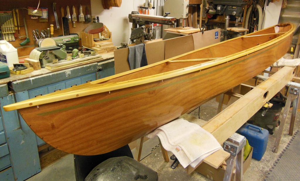

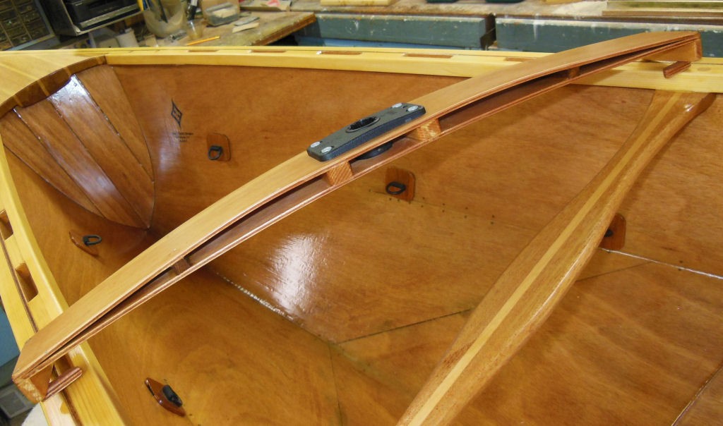

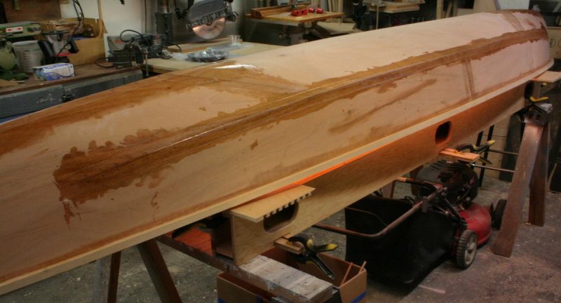

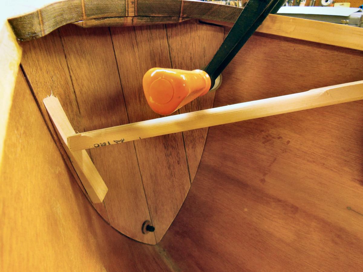

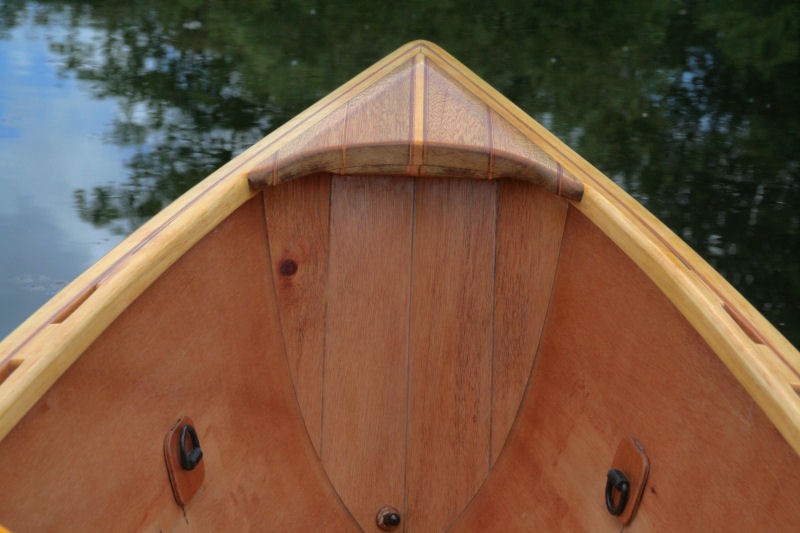

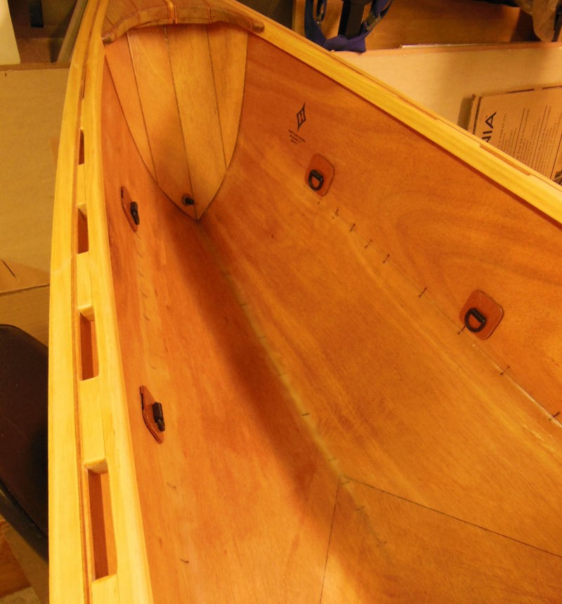

Almost finished, just the skirts and related support bows left to make. I liked the slotted in wales I built into hull 3 so incorporated them into this boat along with flotation voids in the ends. The slots come in handy for mounting removable pieces to the boat like bows for the skirts and rod holder mount that spans the boat just far enough forward to not interfere with paddling. The spreaders and the breast-hook are mahogany and ash with clear pine used on the gunwales. The boat is finished bright with satin gloss varnish. It will be the boat I take on this years' trip. Bill

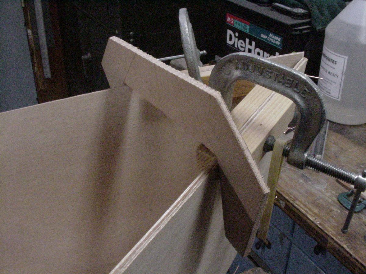

For the gunwales on my Moccasin boats, I cut pieces to make the 3/4 inch square strips then scarf the pieces together with un thickened epoxy to achieve the desired length. When new, the joint is a visible line but over time the line becomes a line you can see and feel. The joint appears to be pulling apart lengthwise, could this be epoxy creep or am I doing something wrong? This time I have pinned the join with a dowel through the scarf joint in an effort to prevent this creeping. Anyone else experience this problem? Bill Update see attached image The dowel is not in previous gunwales but I am going to try it on this one.

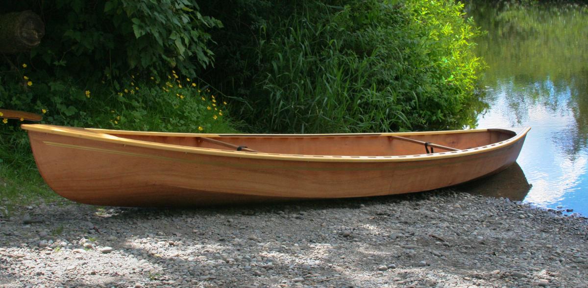

Just returned from our annual camping trip. This year was to Murtle Lake in British Columbia, Canada. Murtle is the largest paddle only lake in North America. The lake has native Rainbow and Kokanee trout. The rainbow get quite large and provide an excellent fishing experience. Some cannot be brought to the surface with light tackle. We carry 110 to 120 pounds of gear in the boat and the Moccasin 14 handles the load very well. We have rip-stop nylon skirts that cover 2/3 of the boat and help keep out rain and splashes. We prefer to set up a base camp and do day trips fishing and exploring. We also do the Bowron Canoe Circuit in British Columbia, which is a world class 70 mile loop through lakes, rivers and portages. This trip involves making/breaking camp everyday in order to complete the circuit. It is easy to cover 10 miles a day to complete the circuit in 7-8 days. Highly recommend this boat, it has never failed to deliver us safe and sound to our destination. BillB

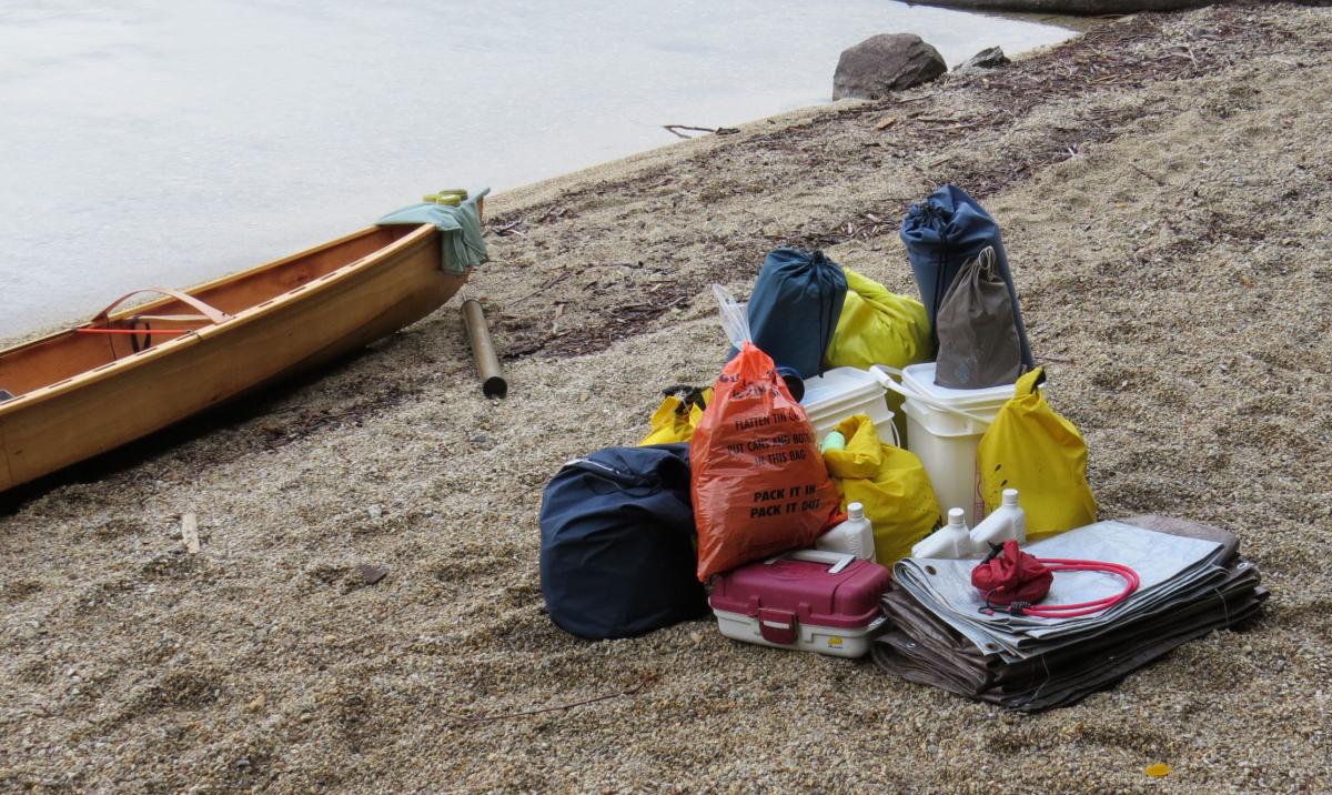

Since Building the first 14 foot version 5 years ago, it has been used exclusively and never given me cause for alarm even when running down a wilderness river (class 2) in Canada. It is also used throughout the year for fishing on local lakes and rivers. The Camping trips are 2 weeks long and we carry about 110 to 120 pounds of food and gear in the boats. Most trips require portaging between waterways and for this we strap the boat with all the gear to a 2 wheeled cart and hike to the next waterway. I mention this so you get an idea of the environment this boat lives in. Save for the usual scratches a canoe tends to get there is no discernible wear. Anyway, I am in process of building another Moc 14 and thought I would post some progress pictures and try not to ramble too bad. Click Images to enlarge. The 'butterfly' getting ready to come 3-D All the way up and nothing broke! the 'clamp' I use to unsure that the butterfly doesn't crack as it is forced into its new shape. I use a screw and nut for easy assembly - personal preference, nothing more. a method of keeping the ends together without any permanent marks left on the hull. The 'clamp' is cut from scrap occume to fit behind the wood blocks the C clamps are holding. How do you clamp the gunwales on the pointy ends? Use wood clamps with a piece of 80 grit abrasive screen between the clamp and the wood being clamped. This mesh is available at most hardware stores and commonly used by drywall installers. The inside seams are taped, the gunwales are on and the outside seams are taped and drying. I have two coats of epoxy inside and out and need to apply a couple more before the finish goes on (which I haven't decided on yet). I use a wet sponge that has an abrasive side to scrub the blush then wipe off with the sponge side, followed with a damp cloth. The bulkheads are being installed in the ends, they are articulated to curve to fit the hull. If I finish it bright, I'm going to call it the Knotty Girl. Decided to use the skirts from the Moc.. 14 hull #1 for this year's trip and make new skirts this winter. Incorporated a different style gunwales than called for in the plans. The spacers taper under the inwales and allow it to blend with the sides and continue to the ends. Hull ID printed on tissue paper and applied to the hull. I tried onion skin but found that did not become transparent enough. I ended up using tissue paper, like you wrap gifts with, It's a little tricky to print on but it does become transparent when embedded in the clear coat. Getting ready to launch. Underway Spent the day fishing and enjoying the new boat. Even caught a couple nice trout for dinner. Bill

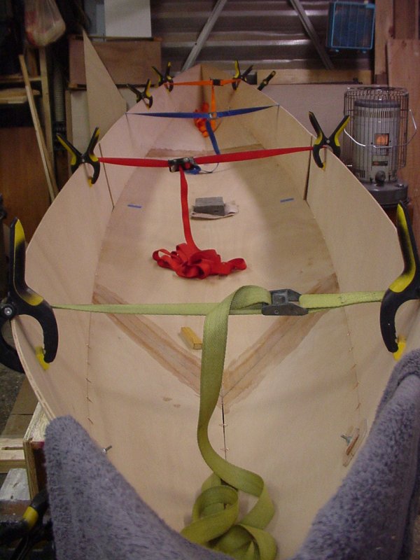

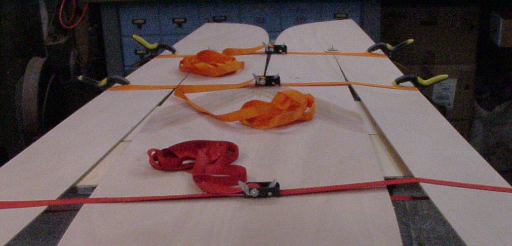

Gregg, When you start to fold the butterfly into a boat shape, the stem will come together along it's length except for the section right next to the arrowhead shaped piece you added. This gap will be resolved with thickened epoxy and fiberglass tape when you add the filets and tape/epoxy the seams. Secure a piece of plastic (like from a plasic bag) to the outside of the seam with masking tape and then do the filet and tape on the inside. The plastic will keep the epoxy from falling through the crack and can be easily removed after the epoxy sets. You will be adding epoxy and tape to the outside of the seams too, so the join will be sealed. I like to put extra layers of fiberglass tape on this area of the hull because this is where the most scraping happens when beaching the boat. Bill
