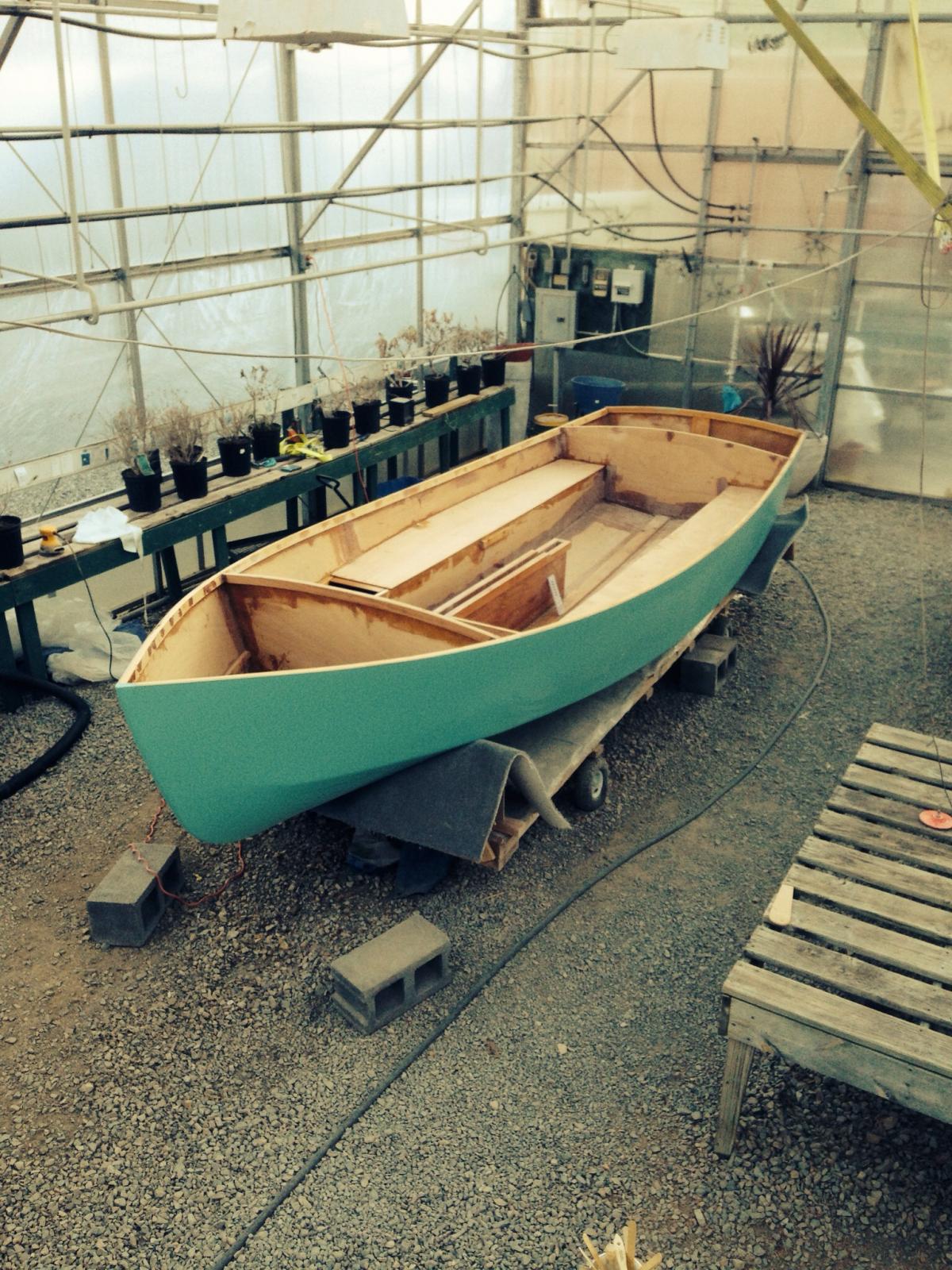

The boat looks great Matt. I'm jealous of your pace. I am still sloshing along trying to line up the trunk for installation while you are kicking butt. Like your color choice as well! Keep them coming.

Thanks again Lennie. A looming deadline helps with progress. Apparently they want to grow some plants in the greenhouse come March. "That boat would make a nice planter!"
Matt- what are they thinking? Don't "they" realize this is a boat shop, not a greenhouse :)
I know! The nerve of them growing plants in my shop!
Well, we've been evicted from the greenhouse and it's back to the dungeon.
On the bright side, I got the masts back from powder coating and they look amazing. They will likely be the best looking parts of the boat.

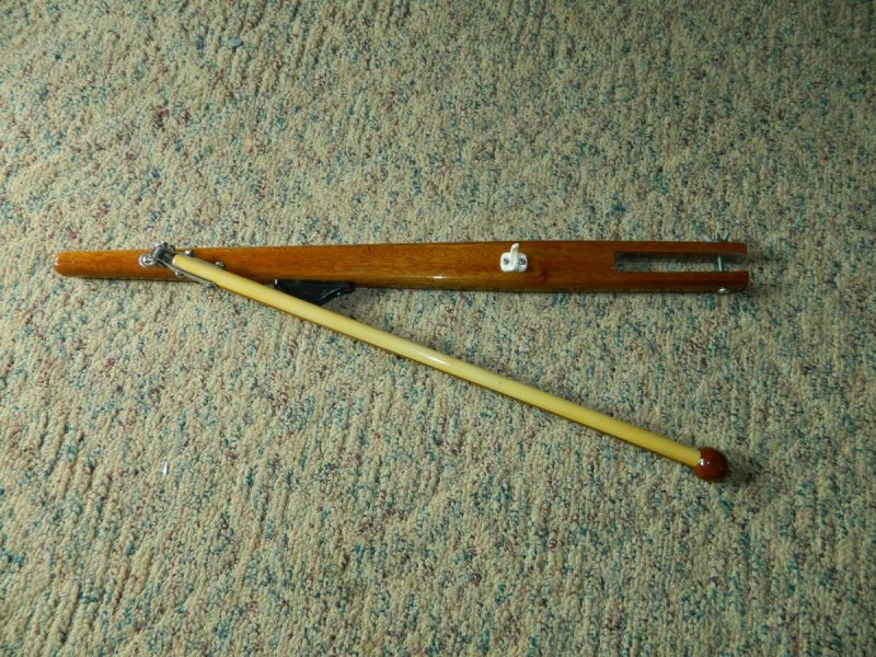

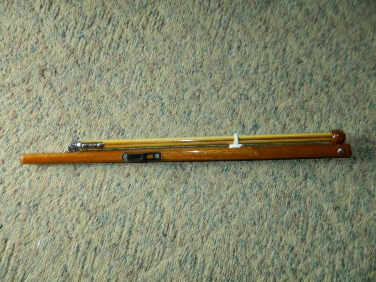

I also put some rope work on the end of the tiller, usually just behind the ball, for about 8". Rather than the bother of fancy knots, which I was never very good at, I just use a length of 1/8" - 1/4" (depends on the size of the tiller) single braid line, tightly wrapped around the tiller and tacked at each end. I'll often apply a light coat of varnish before wrapping it, which holds it in place pretty good too.
Here you can see a typical small boat tiller. It doesn't have the usual Herreshoff ball on the end, but the rope work is detailed. Note the hiking stick is treated the same way.
Yup, I do all the trim on my Renegade exactly as Howard has described.   Each year I sand off a coat or 2 and add 3 or 4 more.   Yeah, it is some work, but damn it is beautiful!  If you think you can bomb proof wood and have it look natural and beautiful you are only deceiving yourself.
This is my Spindrift tiller and hiking stick.  I made it exactly to plans except I made it pivot and removable.  I varnish it every few years as it is stored in a bag with the rudder, daggerboard and seats (all varnished cept the blade of the board)

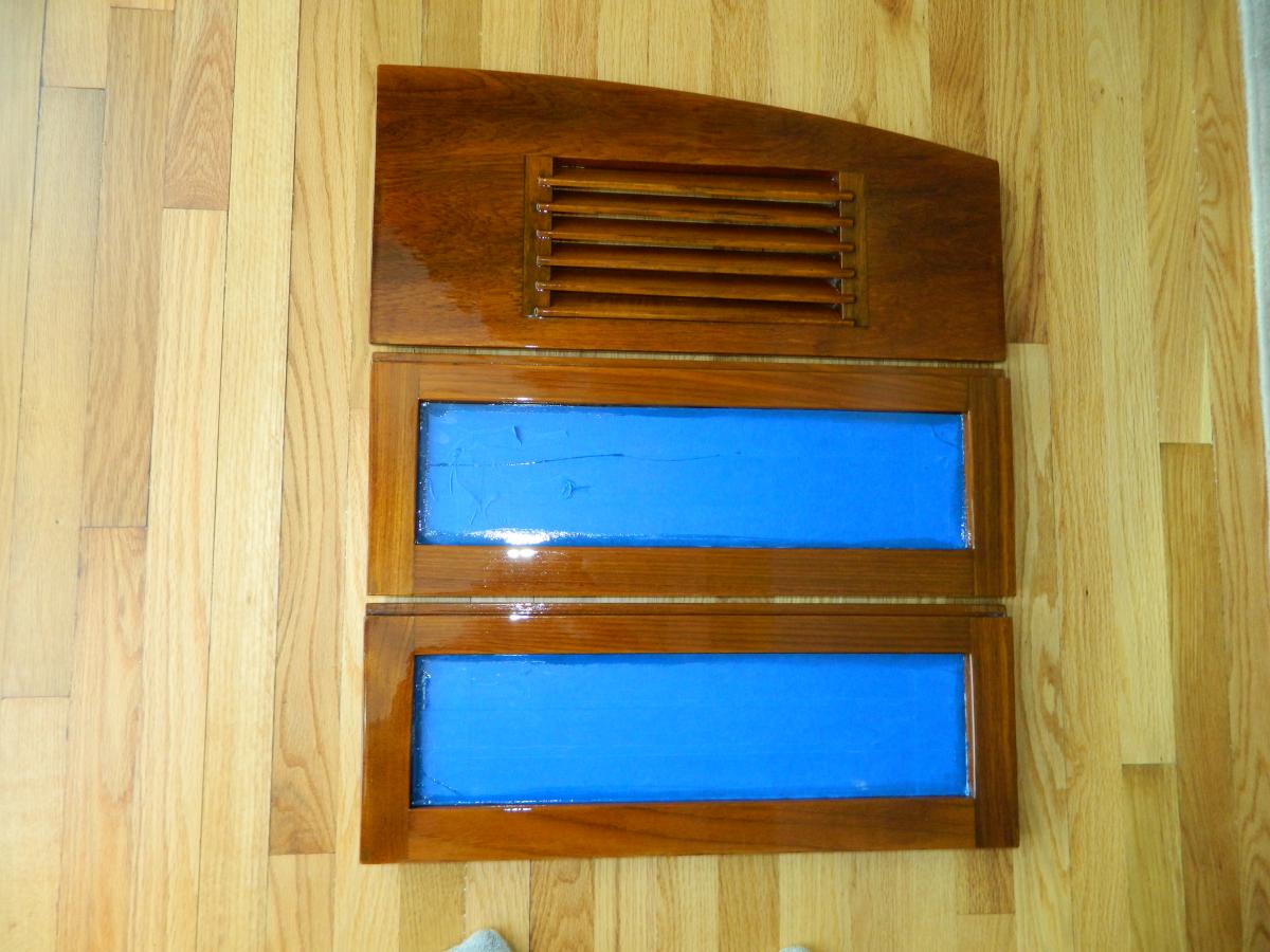

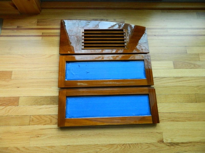

These 2 photos are of Hirilondë's weather boards.  They have some where in the neighborhood of 15 coats left from the past 8 years, hard sanded by hand with 220, 1 coat, sanded with 400, another coat.  When this coat is hard I will sand again with 400 and apply the last coat.  Then I will be good for 6 months at the mooring in Wickford, RI.
post-442-0-42738400-1394744273_thumb.jpg post-442-0-61328500-1394744287_thumb.jpg
The blue tape is masking smoked gray polycarbonate.
