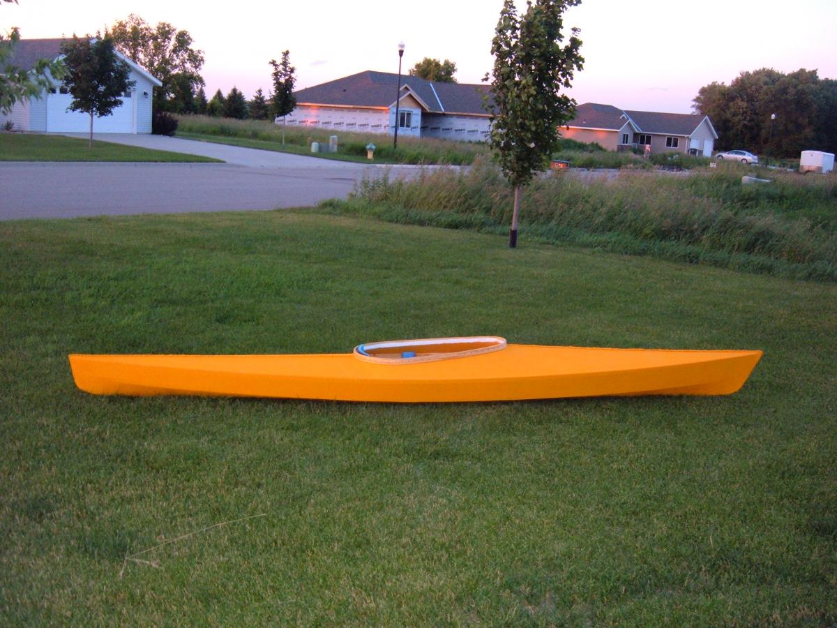

The FreeB 14 is painted and waiting to cure a little. Color turned out slightly different than expected but still happy with it overall. Have some 5/8 blue poly rope for a coaming lip. I am hoping to find a similar blue shock cording and rope for rigging and painters. Do you offer colors, Jeff? Also need to add wear strip and will probably paint the cloth on the inside of the coaming.

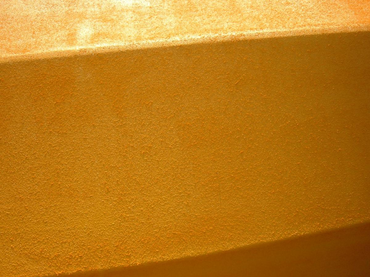

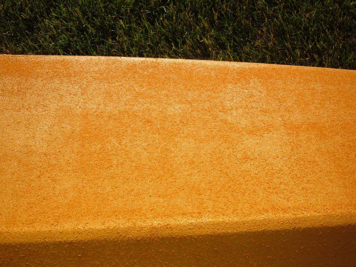

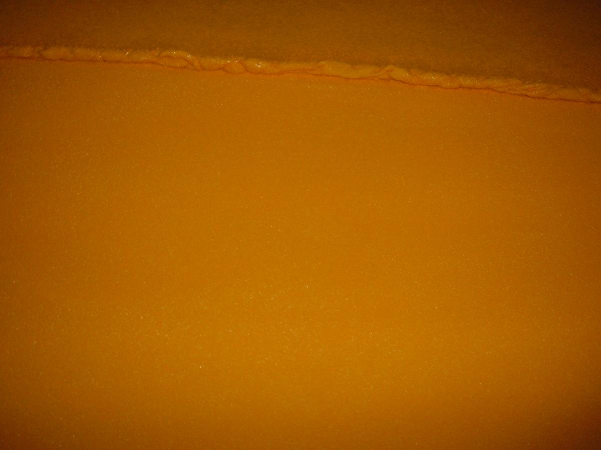

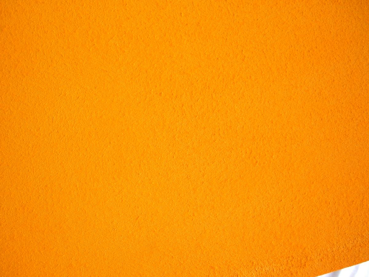

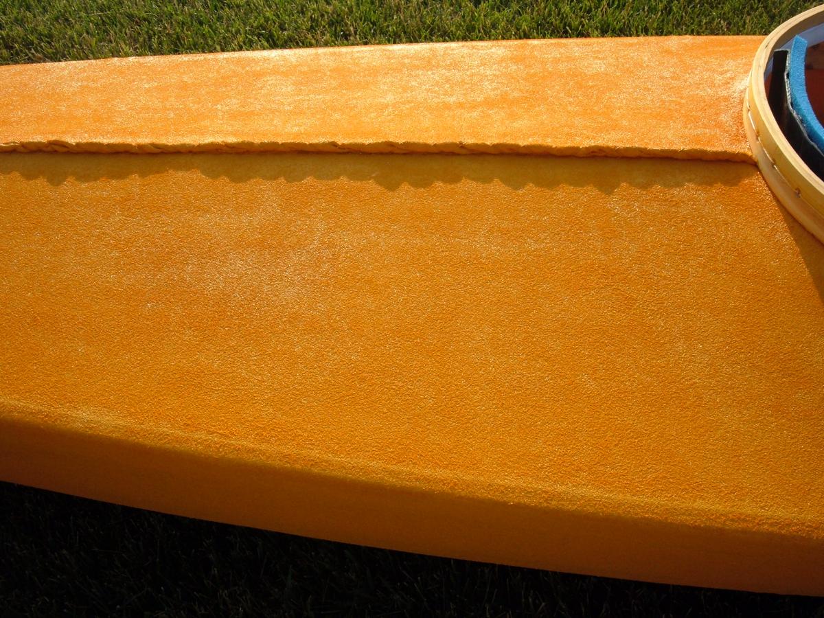

The recycled polyester has been interesting. I read about the sanding after each coat of paint and reasoned that a little hand sanding with 220 grit before painting might help. Wrong! It was reminiscent of suede after painting.
Sanding after the final coat softened it to a velour/velvet.
These pictures don't really do it justice but if you enlarge them you get some idea. Both the regular roller and a foam roller tend to lift the "nap" as you paint. I don't know if a foam brush would give a different result. I might attempt that on a scrap.

Hmm, I don't know that the finish you got bothers me at all.  The boats are covered with cloth.  Even the original dacron polyester shows the weave unless you use 10 coats of paint. If one wants a smooth glossy mirror they picked the wrong method and materials in the first place.  Did you try a coat after sanding?  I wonder what sanding between 1st & 2nd, then again between 2nd and 3rd would yeild?
Nice job.
I know it is hard to get the photos to show what is actually going on but from what I see that is not bad. Fabric always has a texture, paint is a thin film and it takes on the texture of what is under it.  The issue has been small fibers that stand up and look like grains of sand and don't see that on yours.
I wish there was a safe way to singe those stray fibers off. That would solve the problem.
Please don't get me wrong.  I'm not disappointed in the texture of the fabric at all.  I imagine seal skins had a texture also.  In a way, it reminds me of leather.  The color was a little more shocking than the pain chip but that is growing on me also.  This has been a very enjoyable process.  Thanks to Jeff for all his knowledge and his willingness to share.
Rustoleum.  By the way, I used almost 3 quarts for the 3 coats.  I think I followed Jeff's advice in his video pretty closely.  Could it be that this fabric soaks up more?
How do the surfaces feel?  Are the fibers causing the fuzz noticeable after three coats of paint?
