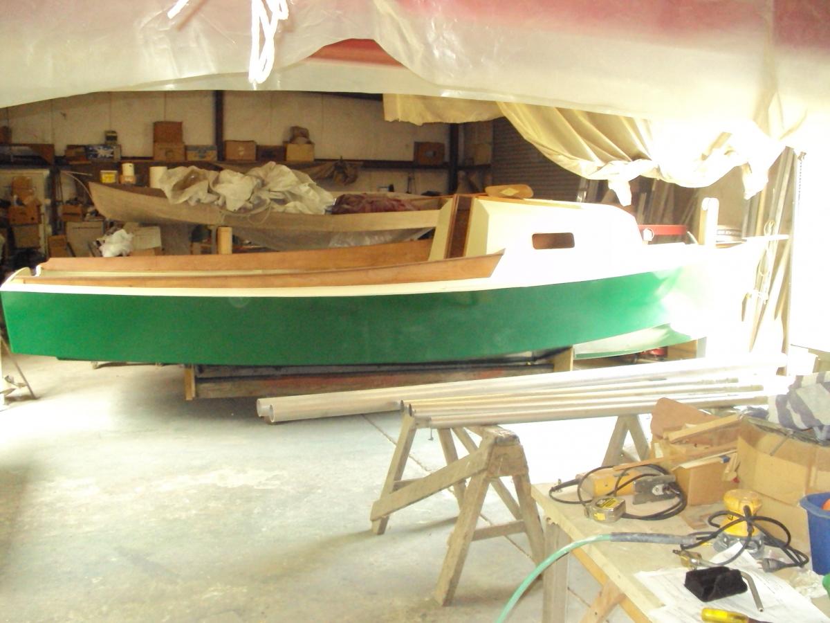

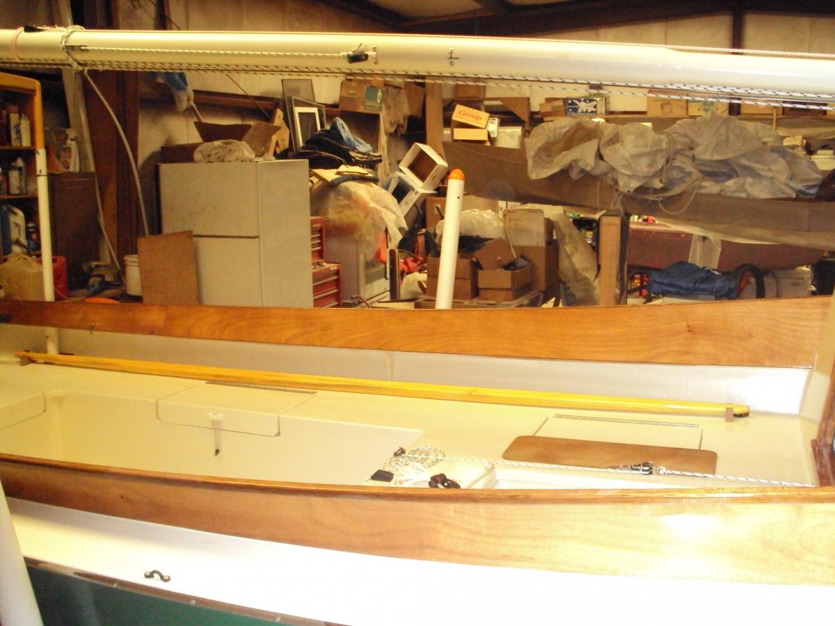

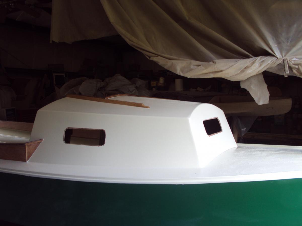

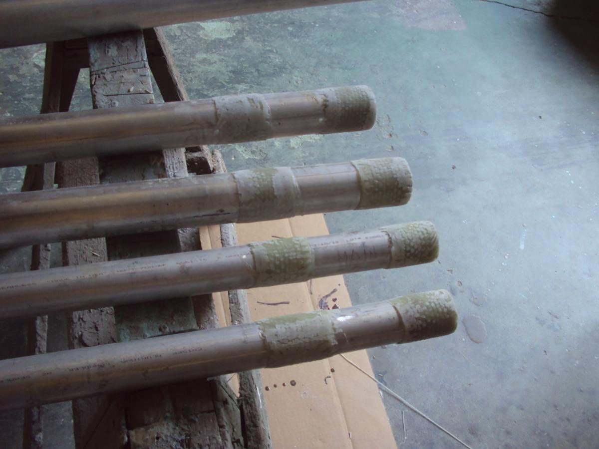

Chick Ludwig Posted September 20, 2012 Report Share Posted September 20, 2012 Got her re-sprayed! Much better. No runs but a little "dusty" looking. I can live with that. Here are some pictures of the re-spray job plus one of the glass and epoxy "bushings" built up on the mast sections. As of today, first coat of exterior varnish is done and mast sections are put together. Quote Link to comment Share on other sites More sharing options...

David M Posted September 20, 2012 Report Share Posted September 20, 2012 This is a fantastic looking first build of this new variation. I would love to see a shot through the companionway to see the inside the cabin to get a sense of the layout and space available. Quote Link to comment Share on other sites More sharing options...

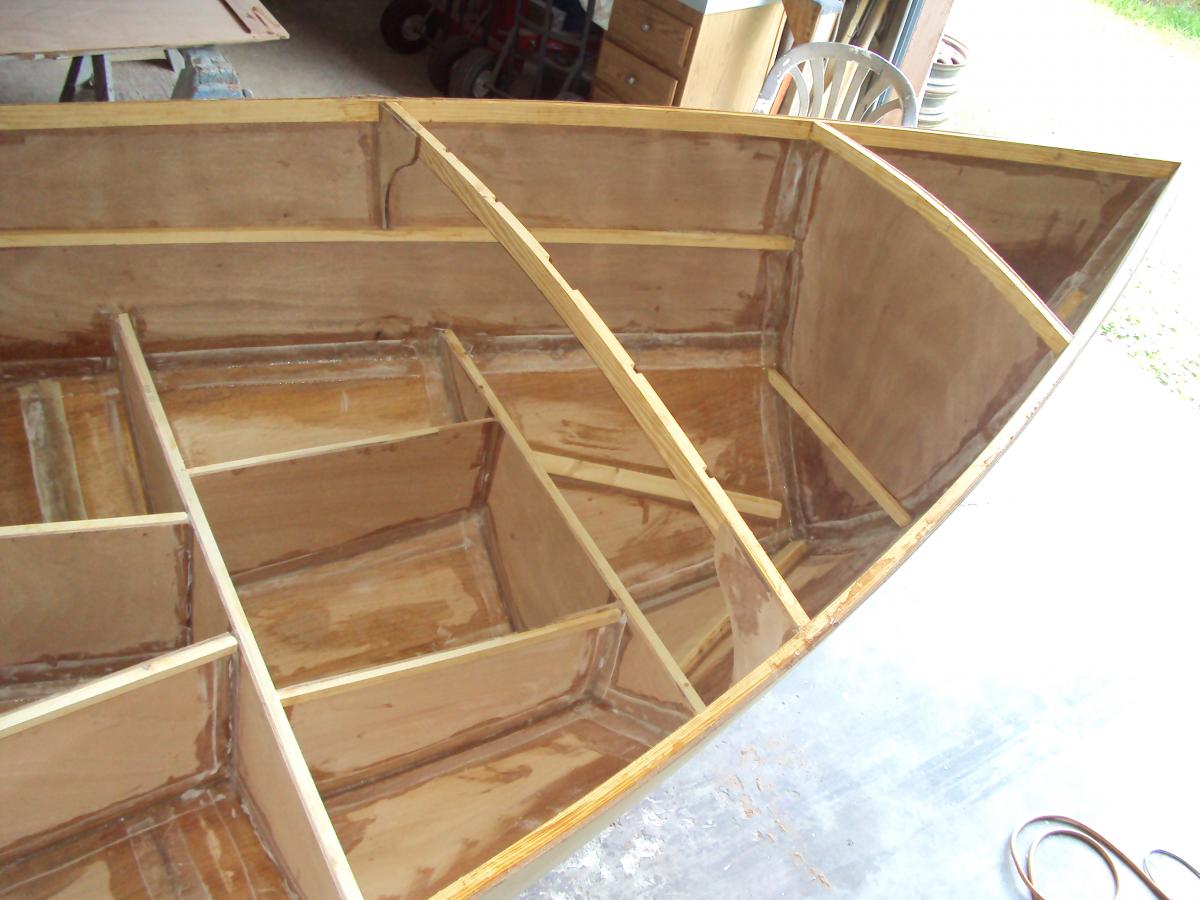

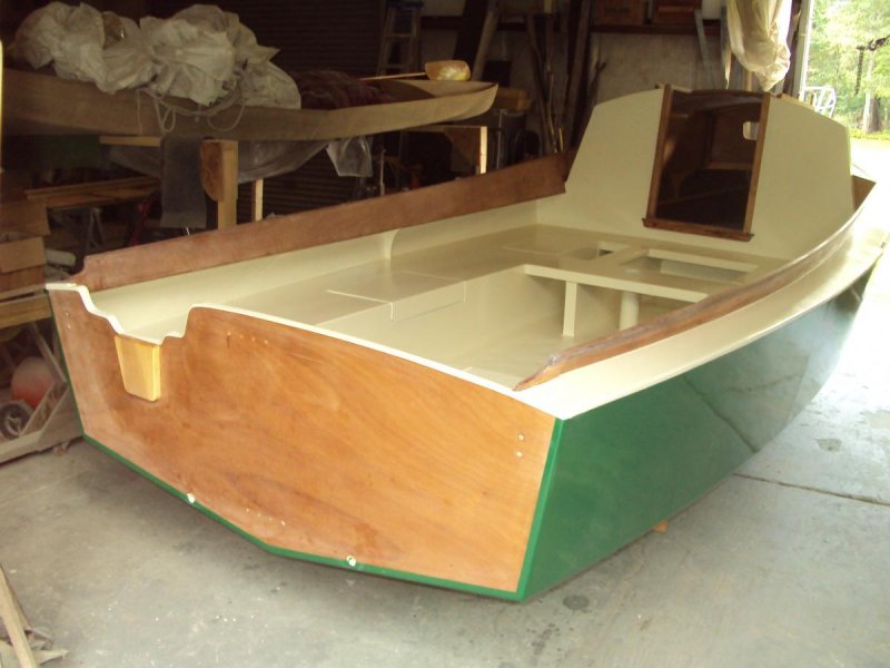

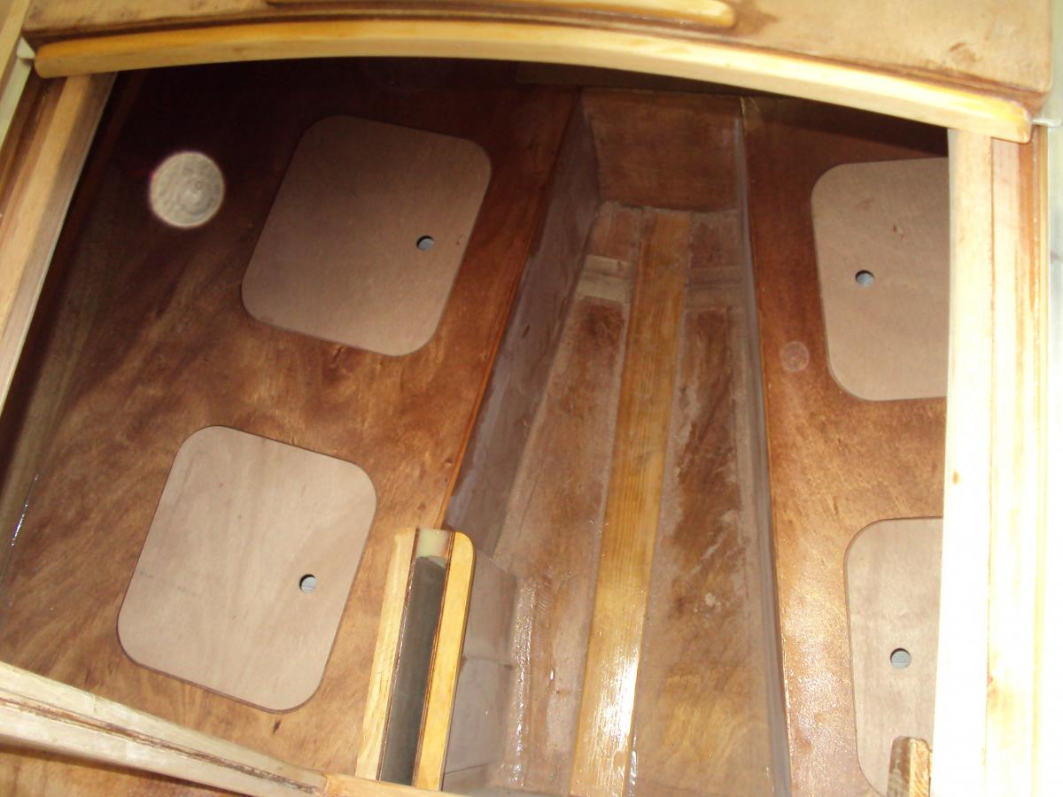

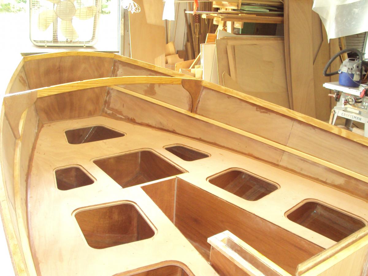

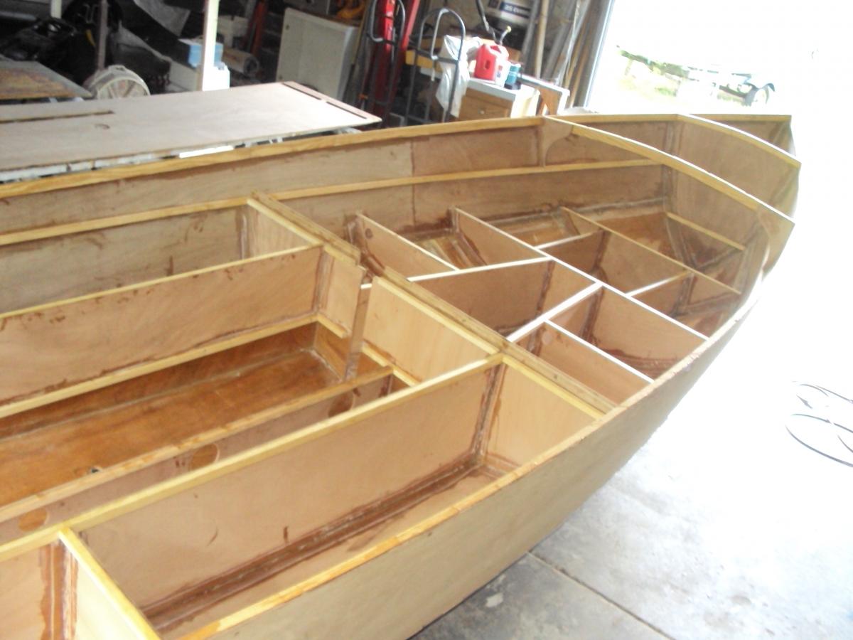

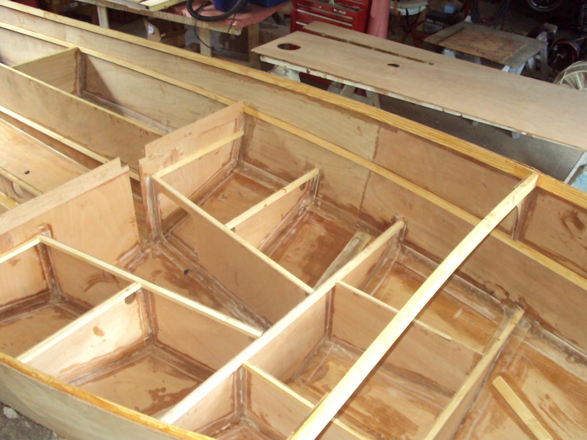

Chick Ludwig Posted September 20, 2012 Report Share Posted September 20, 2012 I'll see what I can get tomorrow, but I don't think my camera can get a good shot. Here are a few pictures during construction that may help a little. Quote Link to comment Share on other sites More sharing options...

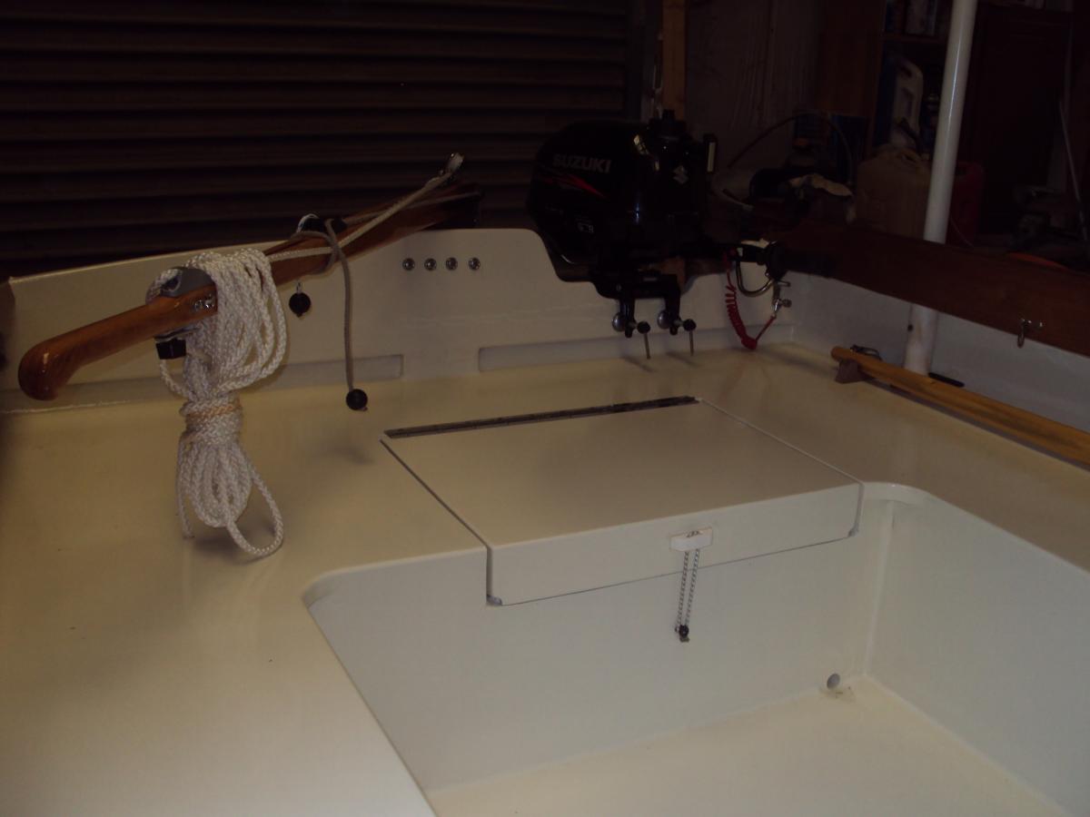

Chick Ludwig Posted October 30, 2012 Report Share Posted October 30, 2012 GOOD NEWS---GOOD NEWS !!! We found the camera! I'll get some pictures and post them tomorrow. By the way, here is a picture showing my cockpit drains (scuppers?). They run from the cockpit back through the transom at a slight inward angle as viewed from above, and lay directly against the inside of the hull bottom. I'm guessing that the lee scupper goes below the waterline as the boat heels. Quote Link to comment Share on other sites More sharing options...

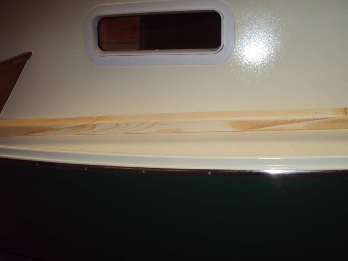

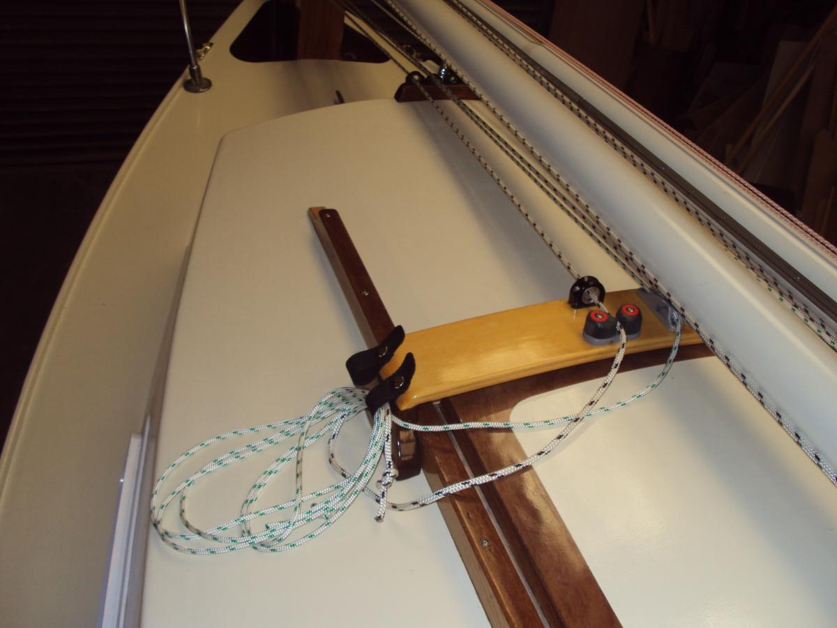

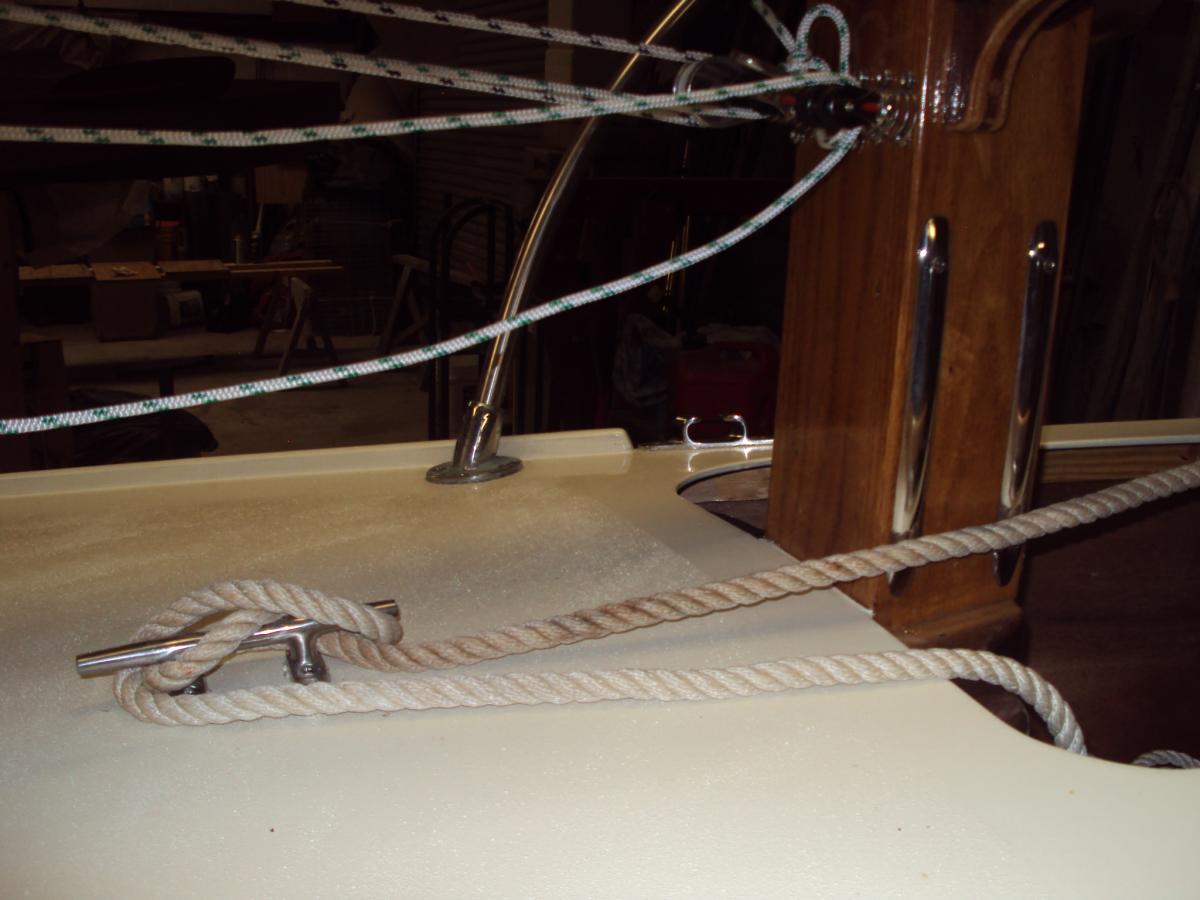

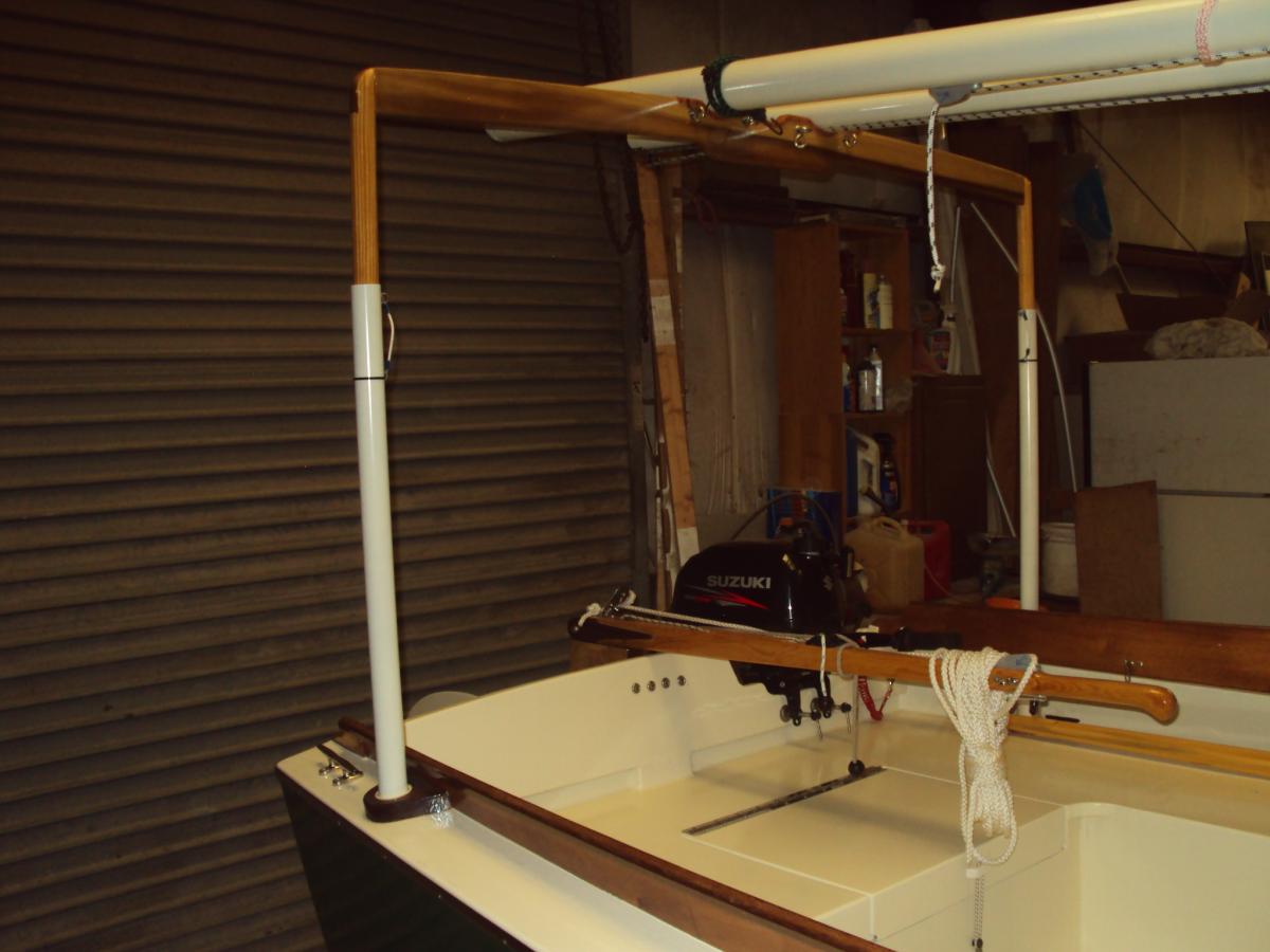

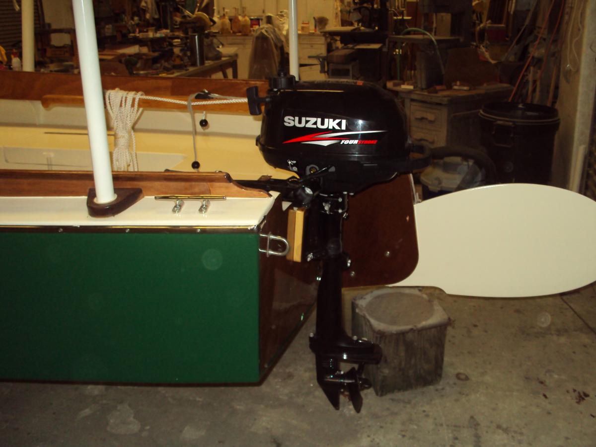

Chick Ludwig Posted October 31, 2012 Report Share Posted October 31, 2012 (edited) Here they are, y'all. Some new pics. This is the splice in the main sprit. Still needs epoxy and varnish. Mizzen sprit in chocks for trailering. Will have straps to hold it down. "Iron wind" Seems like everywhere I launch, there is a narrow channel with the wind blowing in the wrong direction. Pulpit and anchor roller salvaged from a junk boat. Also shows support for mizzen mast while trailering. Anchor rode around tabernacle-scuff strips. Hole at the bottom of the cockpit is the scupper. Bridge for lines for main sail control. Halyard, down-haul, topping lift, first reef tack down-haul. Gallows for masts and main sprit while trailering. Gallows "telescopes" down so it won't interfere with mizzen sail.. Anything else you want to see? . Edited October 31, 2012 by Chick Ludwig Quote Link to comment Share on other sites More sharing options...
