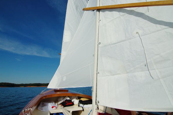

PinoyPiper Posted September 24, 2011 Posted September 24, 2011 on the CS17 rigging plan, it doesn't really show how the mizzen snotter is rigged. does it cleat on to the sprit as shown on the diagram for the main snotter? or is does it simply cleat on to the mast? or am I missing something? I can't find it on the pictures on the CD either. i've never rigged a snotter before... how have you guys done it? also attached is a pic of the main snotter, not sure if the block attached to the mast is the right one, but this is what Carla sent. The main snotter leads to a block on the deck then to a bullseye which leads to a cleat on the side deck. that bit I got.. I've only gotten as far as rigging up the main, there's a tree in the way of the mizzen mast, so I have to wait until the trailer is done so I can wheel the boat out from under the tree. Quote
Alan Stewart Posted September 24, 2011 Posted September 24, 2011 Mizzen snotter is the same way. We brought ours to a clam cleat on the side of the mast about a foot above the thwart. A horn cleat would also work. Make sure you have the downhaul tied to the thwart first, then up to the sail and then to a cleat. Unless you have some other system to hold the mizzen mast down in the hole in the event of a bad capsize. -Alan 1 Quote
PinoyPiper Posted September 25, 2011 Author Posted September 25, 2011 I think I found a picture of one on Wes' page. I just need to confirm it. Quote
Alan Stewart Posted September 25, 2011 Posted September 25, 2011 The blue line in the pic appears to me to be the halyard because of how much of it is coiled up underneath. The mizzen snotter must be on the backside of the mast out of view. An alternative is cleating the snotter line off onto the sprit itself. Not as easily adjustable though for obvious reasons but a good set it and forget it approach. As long as the mast rotates (which the mizzen does) the snotter tension is not a problem when you ease sheets. Quote

wkisting Posted September 27, 2011 Posted September 27, 2011 Not sure what happened to my previous post by my internet went out this morning while replying. The line against the mast in the pic Roy posted is my snotter. The coil of blue rope laying over the thwart is from the mizzen halyard which is actually cleated off on the other side of the mast. It just looks like the two are connected, but that's an optical illusion. The other (black) cleat is for the mizzen staysail halyard when we fly the staysail. The other pic I posted above shows where the mizzen halyard actually cleats off on my mizzen (on the port side of the mizzen mast). Ironically, here too it looks like the halyard is connected to the snotter, but they're separate lines. The snotter terminates at the cleat on the front of the mizzen mast (call it the 12 o'clock position). The halyard terminates at a cleat on the port side of the mizzen mast (at about the 7 or 8 o'clock position). Quote
