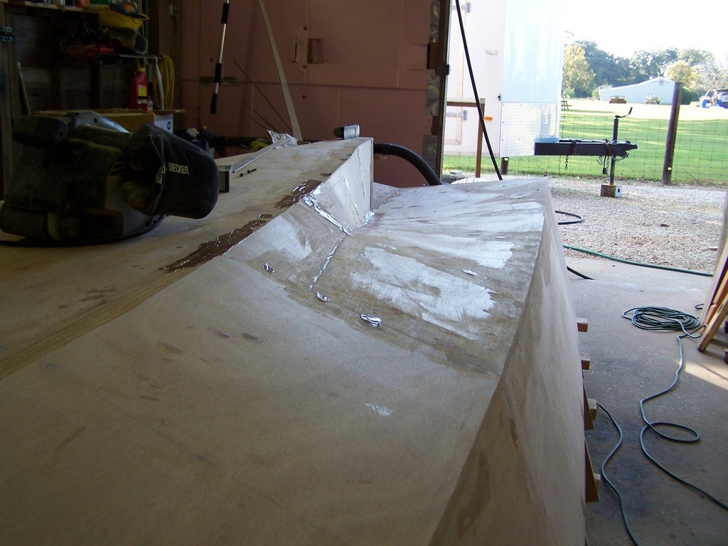

I went over to the boat today and Wally had put most of the planking on the port side this week, so I got to fair those in today. I started with the long board sander today to get the hull smoothed out. A lot of work, but it is looking better. I also got most of the keel edges rounded with a decent radius on the starboard side using the block plane and finishing with the long board sander.

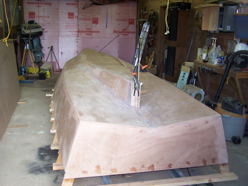

I finally got over to work on the boat today! The project today was to get the stem cut down to have a fair cutwater. Lots of work with the plane and sanding, but it looks pretty good. I didn't get a chance to take a picture, but am hoping to take one tomorrow morning when I go over to cut down some of the filler material for the "final fit".
We got a little sticker shock when we priced a new 21 horsepower Yanmar diesel for the boat. The quote was $7300 plus freight and tax!!  :shock: Now that we have a ballpark figure, we are going to look more closely at rebuilt engines. This has been a learning experience, to say the least.
We have the whole hull planked and mostly faired in except one plank back by the stern block. This was left off to facilitate boring the hole for the propeller shaft stern tube. We will be measuring for and (hopefully) boring the hole this weekend.  :-? That should leave us ready to glass the boat, which is a big step.

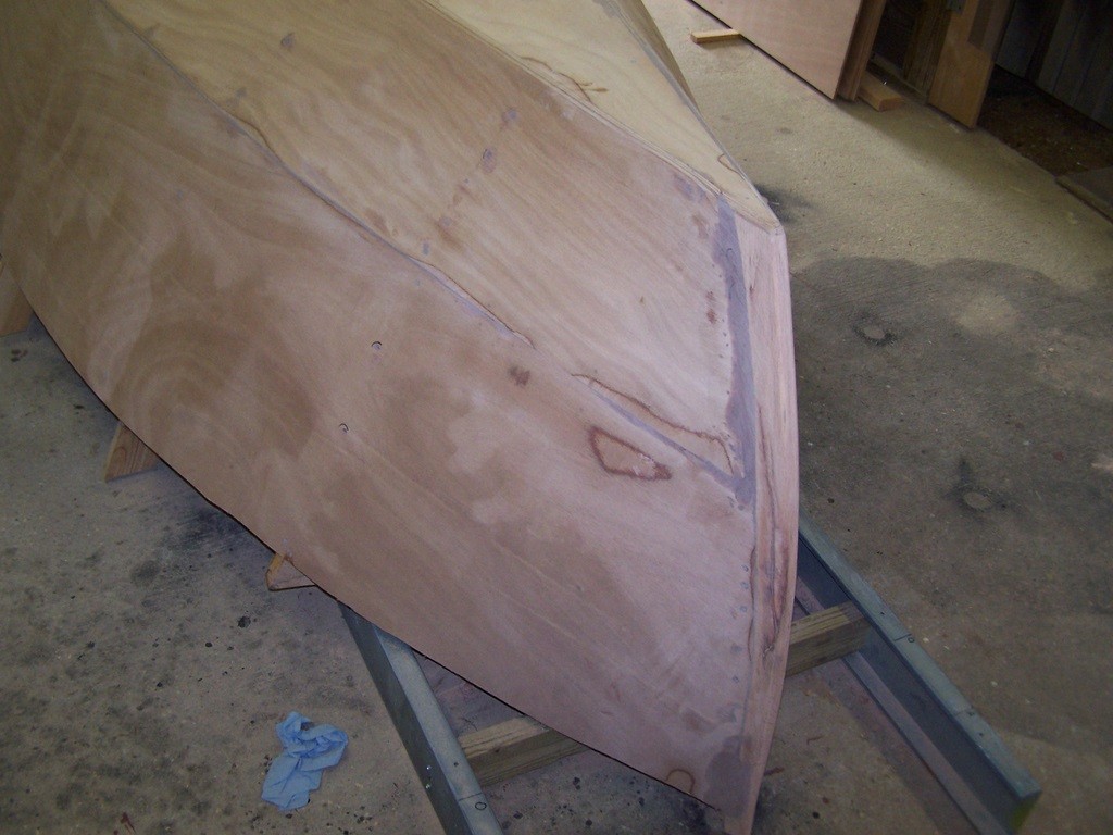

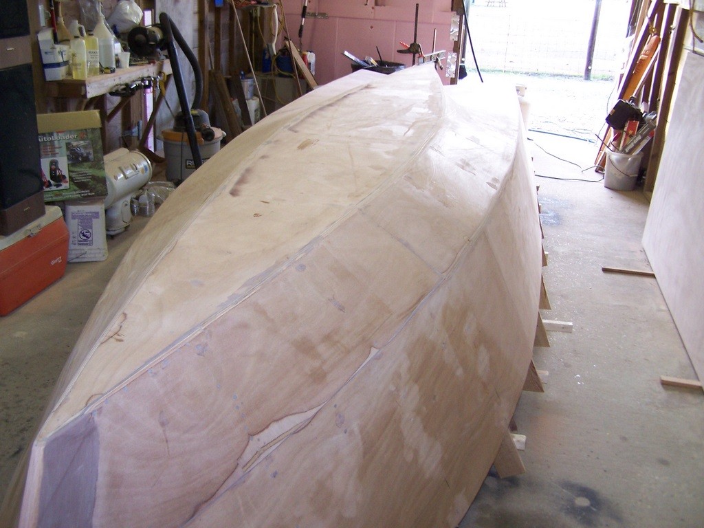

Wall and I finally got to work on the boat a little today. We have the hull almost ready for fiberglass, except for one panel at the stern that we have left off until we drill the hole for the prop shaft.
Before we drill the hole, we need some information on the typical configuration for propeller shafts in small boats. We need to know the relationship among the stern tube, the seal, any bearings, and the shaft. I sent a question to a guy that recently built a Rescue Minor and I hope to get an answer soon. If any of you guys have some advice, please let us know.
Here are a couple of shots taken today.
Steve
We drew the frames fom the drawings and the measurements provided with the plans and then built them on the bench. Then we layed out the frames on a strongback and the lines were evident at that time. There was a frame that had to be built up about 3/4" to provide fair lnes, and a couple that had to be planed a bit. Otherwise, the planking went very well.
