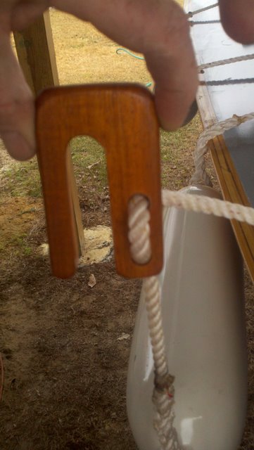

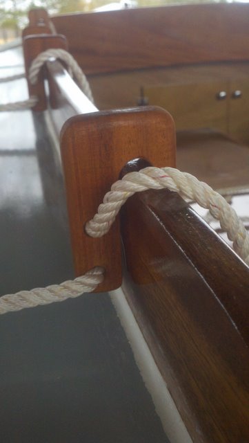

I made some hangers for the boat fenders a couple of weeks ago and finally got some pictures of them last Friday.
These were made from Mahogany scraps that I had laying around the shop and they came out quite well. I just cut a slot, drilled two holes, and varnished them. Here are some photos of them in place and details of one of the pieces.
